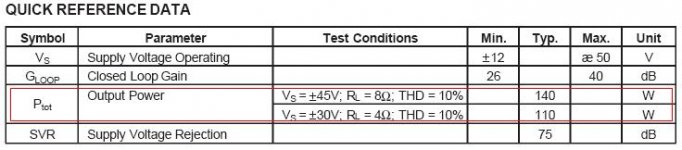

I've a pair of TDA7293 in parallel. unfortunately the chip blew off before I can here any sound from this chip.

Thanks jer. But I think either you or the datasheet is wrong. I just want to know the truth. I, as many 7293 users, deserve to know the truth. People shall thank you for revealing the truth instead of blaming you for over repeating. Thank you.
single 7293 output 110w into 4ohm with +/-30V DC power supply.
multisync: thanks for your information. From my experience and your information, I feel that the chip is not a good choice for HiFi which requires power > 60w and low distortion at freq >20KHz. I will give the chip more try, based on the high efficiency application circuit in the datasheet. But I firstly need to know whether that datasheet is free of flaws. I hope people who has ever built the high efficiency application stand up and say something.
