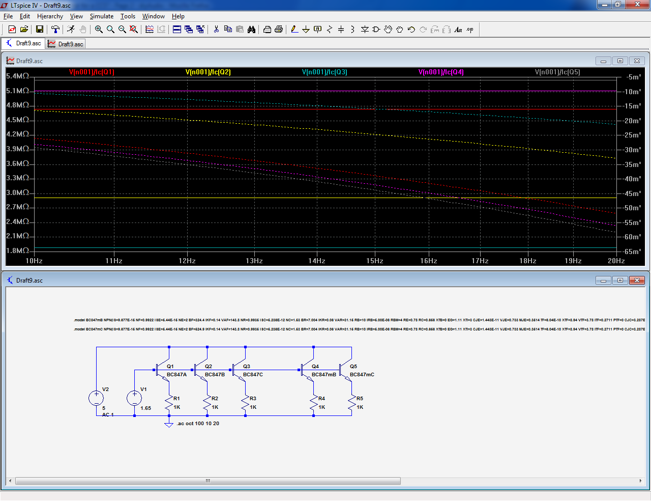

Here is the comparison with BC847's.
The quasi-static output impedance is plotted for the three hfe classes, and in addition, two synthetic classes have been added: Class mB is a A with just the Hfe brought to the B level and all other parameters unchanged, class mC is the same for the C.
The 847A has ~4.7 megohm output impedance, the class mB ~5.1 megohm and class mC 5.3 megohm: no surprise there.
But when "actual" transistors are measured, the difference is reversed, and quite dramatically: now the impedances are 2.9 and 1.9 megohm respectively:
Conclusion: the lower Hfe types are normally better for this kind of application

OK, let's put it another way: provided that hfe is sufficiently high (which means >> 30 for the simple CCS) and other things are not compromised, then the lower the hfe the better because that is correlated with high collector resistance. The minimum hfe would increase of the base voltage is raised and so a larger emitter resistor is used.
