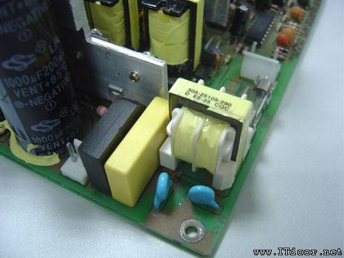

Is common mode filter core suitable for switching transformer?
The thing usually used for common mode EMI filtering.
It contains two isolated spaces for wiring (like most of the 50Hz isolated transformer). So I wonder if it's a safer/easier choice for making switching transformer in isolated SMPS run off 220V AC mains.
But the size? It's the biggest one available. For bigger power...need several ones in parallel?

Hi Kenshin
Find the datasheet for the CM choke core material and check the specific losses for the core material against a more conventional SMPS ferrite such as 3C90. The CM choke cores do not have to accomodate big flux swings at high frequency, so I suspect you'll find the material they use would have excessive losses at even low SMPS frequencies like 40kHz.
Another issue is that if you use the split bobbin, nice as it seems, the separation of the primary and secondary windings will result in increased leakage inductance, which you don't want. Rather consider a conventional E or ETD core chosen for best efficiency at fs, and use interleaved split primary and secondary windings for minimum L_leakage.
Cheers
John

These cores will probably be suitable for power transformer applications but splitting the coils increases leakage inductance unnecesarily
Excess leakage inductance is particularly troublesome in flyback converters and its variants, while Push-pull ones are more forgiving about it
