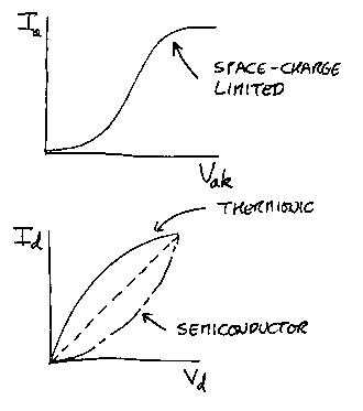

Tosh
This would be a joke if it wasn't published as a Patent!
Once you've cut away the silly claims, the spurious references to add integrity (Hamm) and Edison nonsense, there's little left. Bipolar junction transistors are conventionally voltage driven, but their exponential relationship between applied Vbe (base-emitter voltage) and Ib (base current) means that they distort. If you were to add a device in series that had an inverse law, you might be able to make the base current more linear.
If we apply enough Vak (anode to cathode voltage) to a thermionic diode, we strip the electrons away from the cathode so fast that a space-charge is unable to form around the cathode. Unsurprisingly, this condition is known as space-charge limited. It takes progressively more voltage to strip the last electrons away from the cathode, so the diode curve takes the shape of what I believe Americans call a "lazy S".
If we add the space-charge limited part of a thermionic diode curve to a semiconductor diode curve, we can cancel the two to improve linearity. In practice, the effect may well reduce the amplitude of low order harmonics, but it is most unlikely to reduce higher order harmonics. Cancellation will not remain stable as the valve wears out and cathode emission falls.
In summary, it's primarily a marketing exercise. Oh, and Studer used the LED in the valve base ploy years ago - which should have been revealed when the patent was examined.

Badly designed?
It all depends on what you mean. Ultimately, the amplifier is designed to be sold and enhance the manufacturer's profits. In that respect, it's very well designed. Adding the LED in the valve base implies that the valve is going to be on display. A double diode such as an EB91 would do the job perfectly well, (only a little current is required), but from a marketing point of view, a 6SL7GT is far better. It looks far more impressive and is known to be an audio valve with a good reputation. (Although it would need the LED to shine into the top, rather than the base.) Seeing the valve, uninformed observers will come out with all sorts of stuff about the history and usage of valves, and the product will become great by association.
From an engineering point of view, the valve won't last all that long before its characteristics change and it no longer cancels distortion effectively, so it will need to be replaced. The manufacturer will be perfectly correct in stating that the consequent poor sound is due to valve failure, and that valves do not last for ever. Perhaps the manufacturer will point to the fact that Hi-Fi valve amplifiers require periodic valve replacement too.
In layman's terms it's a marketing exercise. Although the valve can cancel some of the distortion generated by a transistor, it will only cancel the lower harmonics, which are arguably innocuous, and can easily be reduced by negative feedback. Further, the design operates the valve at its very limit, which will certainly reduce its life substantially.
Distortion cancellation is a bit like a see-saw, you can balance quite large weights, but a small change disturbs the balance. For distortion cancellation to work, you either need both transfer functions to be unchanging (transistors) or changing at the same rate (push-pull valves). Here, we have cancellation between an unchanging transfer function and a changing one. And that makes it a bad engineering design.
That was my question - the way they're using this tube, does that reputation even matter? Aren't the tube's behavioral characteristics totally changed by hooking it up this way? That doesn't matter in the eyes of the buying public, I understand that. But from an engineering point of view, the 6SL6GT isn't a 6SL7GT any longer, in terms of its audio performance reputation, is it?
Thanks for the explanation EC. I purchased this amp a few weeks ago and have been very impressed with it's sound. However, if that's a definite in regards to the valve not lasting long, exactly how long am I looking at before I notice these detrimental effects?
Saurav said:But from an engineering point of view, the 6SL6GT isn't a 6SL7GT any longer, in terms of its audio performance reputation, is it?
Absolutely correct. It isn't. It's not being used in an even remotely conventional way, and an EB91 would do just as well.
