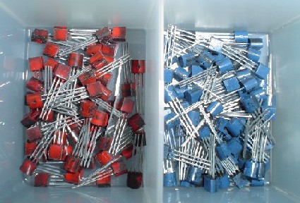

It would be nice if transistors came in more colors. Like different colors for different grades or something. Or just because it looks cool. Capacitors come in many colors, it would be nice if plastic transistors were the same way.
I use to see green every so often, but not anymore. Most are black.
