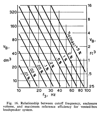

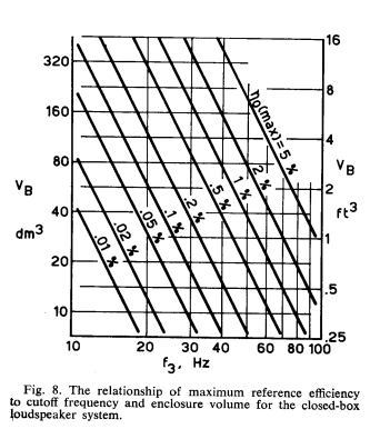

Depends on how low it needs to be this high and box size/shape limitations, i.e. 92 dB = 1% eff., so look at these charts to find box size versus F3.
