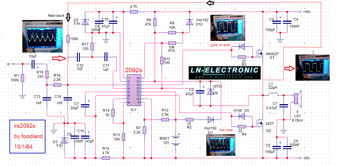

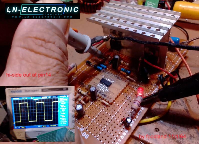

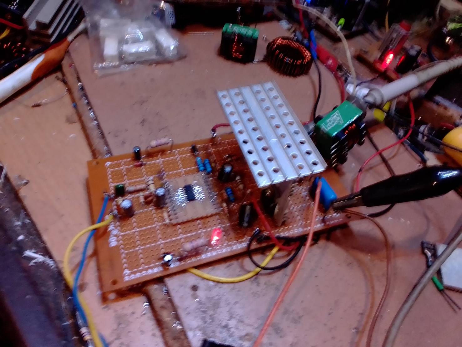

I found with Irfb4227's I needed gate drivers.
The amp played ok until I turned it up then it would start resetting.
Deadtime and OC were at max setting so they should have been OK.

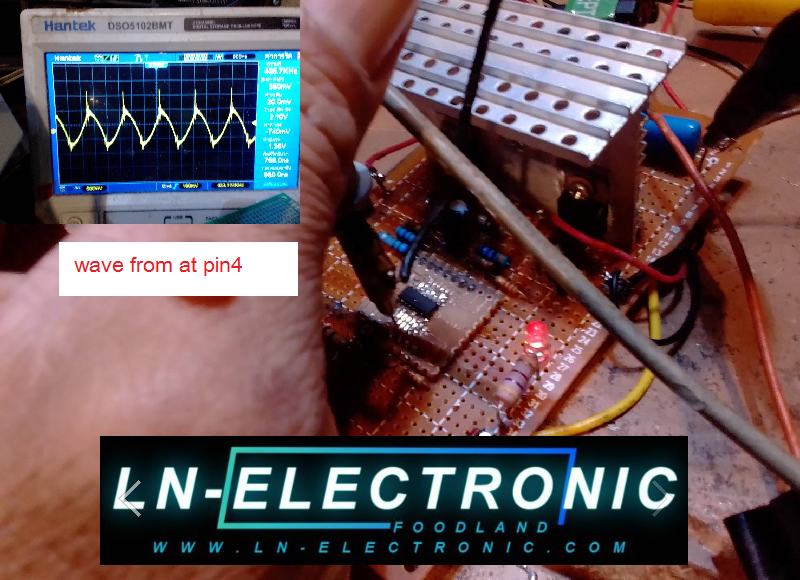

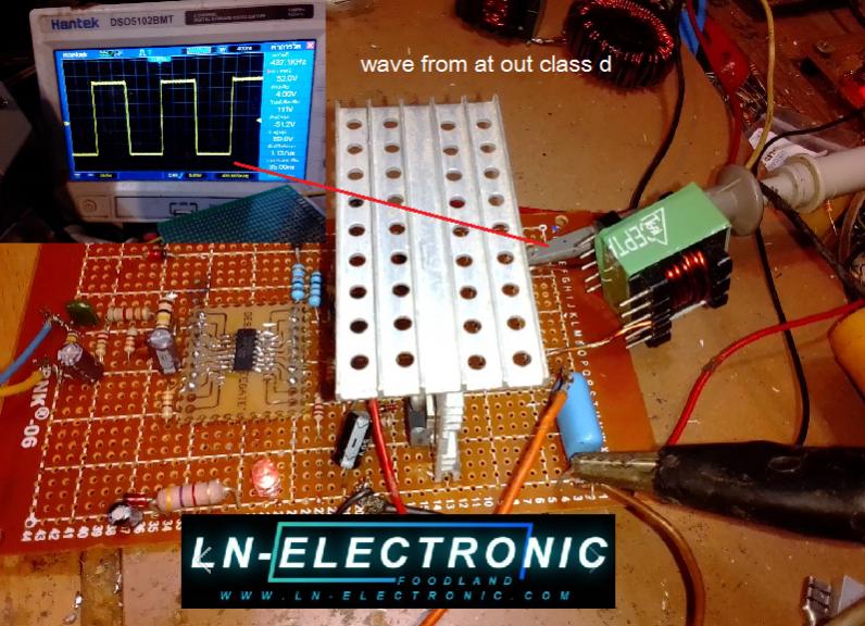

Well done getting it working on stripboard, I struggled using a tightly laid out pcb !
