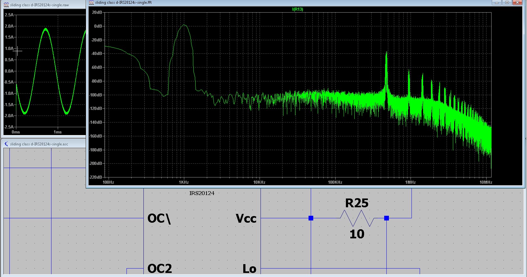

in picture inclosed I have done and experiment with a IR20124 chip and later I go also try Gan. The distortion is low, with good deadtime and a bessel 12db low pass who is fase coherent so feedback stays in line as best as possible.
-100 1Khz is quite good, it is a very simple circuit also based on current and postfeedback with low impedance fase shift circuit.. On 20 Khz it is still -80dB HD supression. Ooo and yes, a low pass filter on the input is quite important, just the simplest HF sh*t who get in can give trouble..

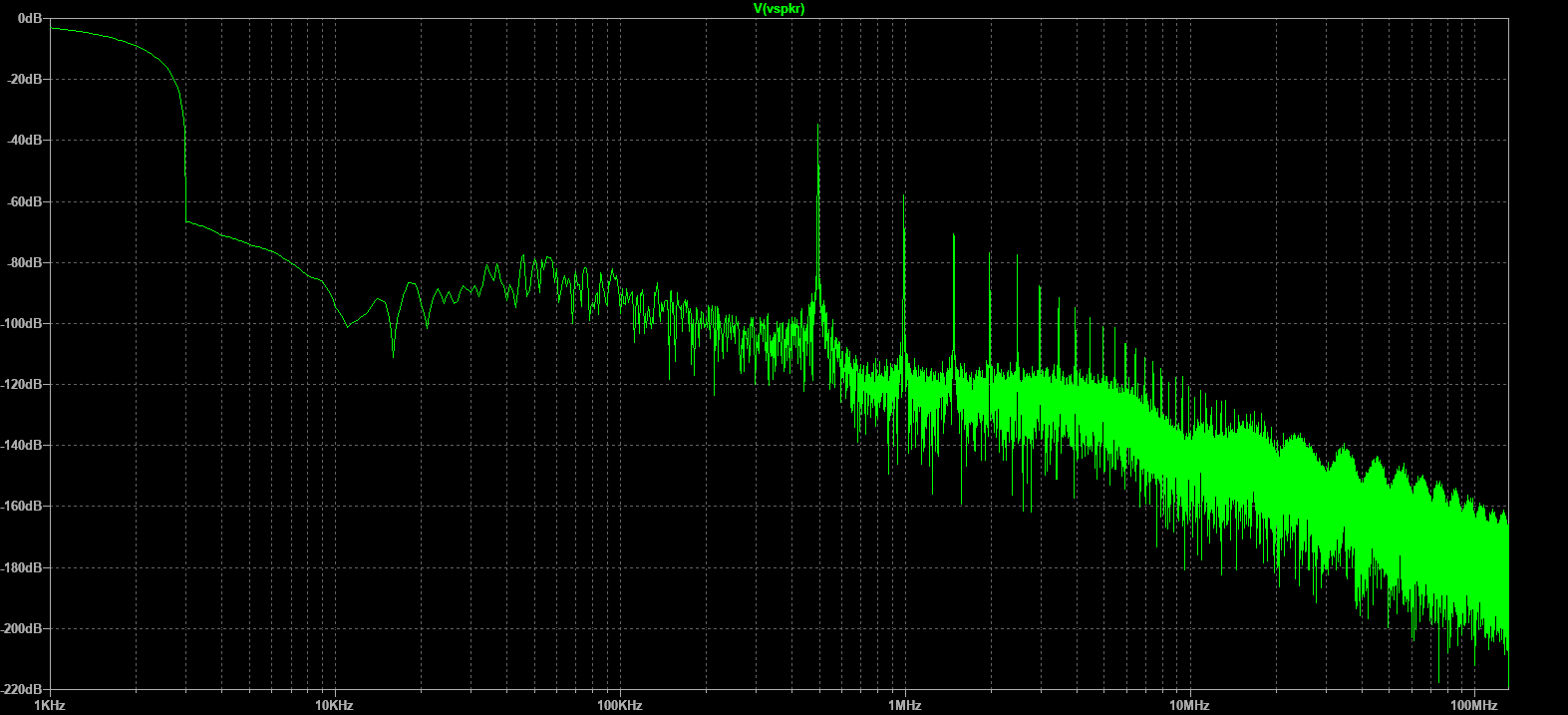

I was experimenting with LTSpice to simulate the following Analog PWM design from Texas Instruments :
https://www.ti.com/lit/pdf/slau508
I used the closest Analog Devices components, and implemented a voltage controlled voltage source to represent the switching of the output stage, which is fed back, and filtered using an expected filter for a Class D amplifier and 8ohm load.
Using the Hann window for the LTSpice FFT, i do not get the performance you obtain. The 1kHz tone is 3dB down on 0dB, and the 3rd harmonic is at -66dB.
I have modified (not uploaded) the feedback to include a 1st order filter, to reduce this further, but your simulation seems to provide very good performance.
How did you simulate the the class D (i assume you mean IRS20124 MOSFET) and the PWM signal ?
Thanks and regards,
Shadders.

Hi Shadders
I do use a self oscillating system in slide mode to track the errors through double feedback, current and postfeedback
What you mention is with a clock triangle I do not use.
The IRS20124 is a mosfet driver with build in deadtime setup. I use in simulation the irf6641bpf mosfet.
it is very very simple circuit, looks effective. With Gan I get even below -110dB.
You need to let simulation last until you have a good 1 Khz read, it was not yet there.

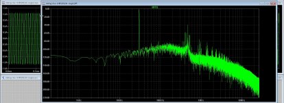

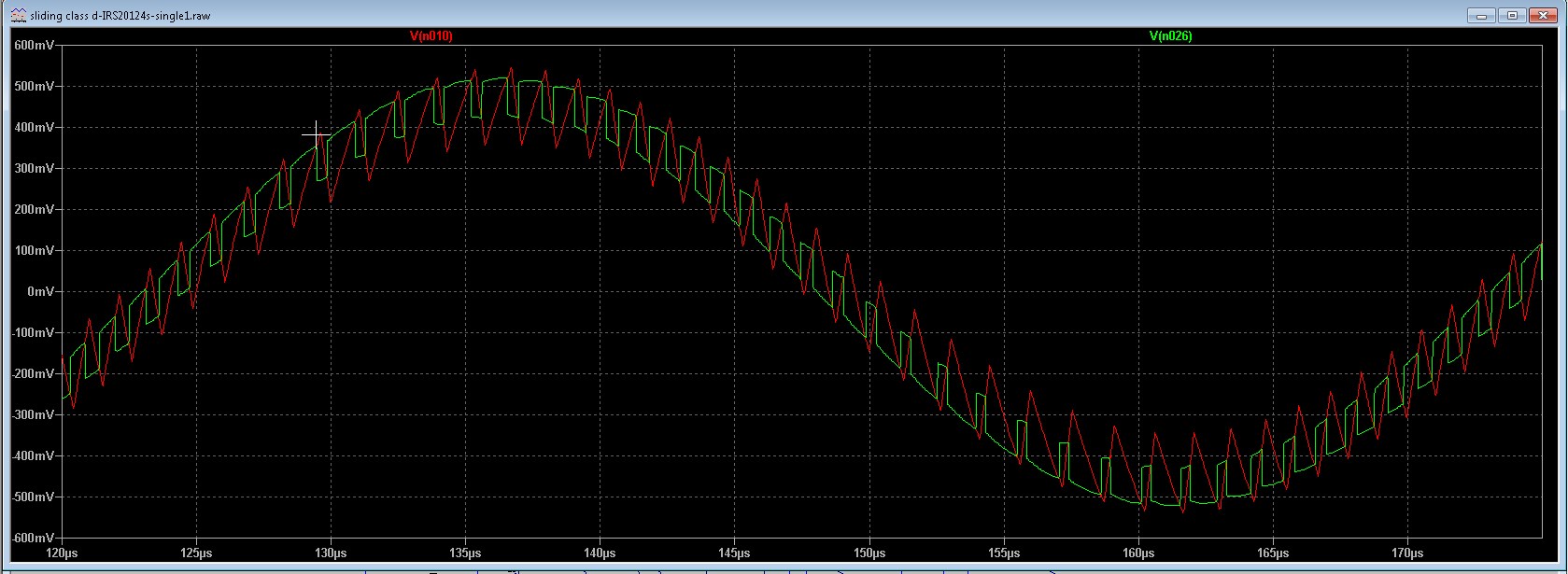

Here you can see slide mode, I have now remove the current feedback and use pre-post feedback, prefeedback from mosfet outputs through a fase shift filter who put out triangle.
Have also other mosfets, now I can reach -90dB on 20 Khz.
(PDF) Design of a Class D Audio Amplifier IC Using Sliding Mode Control and Negative Feedback | angel rojas - Academia.edu
This one use three opamps, I do use just one. one pic let see now on 30 Khz a distortion of -80dB what is nice.
I use bessel 12dB lowpass, it is fase lineair but need 12dB to supress right. a Three level version has more supression because of carrier doubler.
