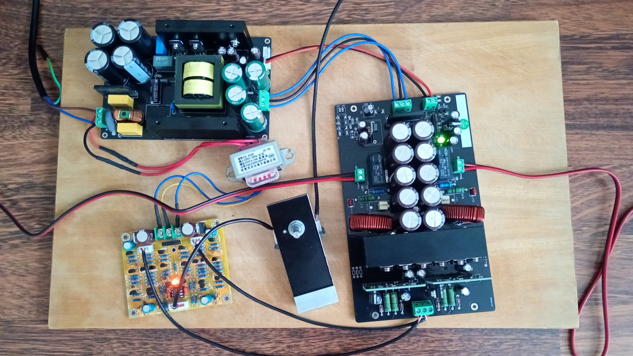

I am building an amplifier with IRS2092 stereo module and Accuphase C-3850 clone preamp.
Switching on is delayed about 3 seconds so there is no problem but after switching off a strong popping sound appears.
After switching off the power amp is still playing about 1-2 seconds but then very strong pop comes out.
IRS has speaker protection and obviously start up delay circuit so speaker protection module would probable not help, right?
How could I solve this?

As far as I can see the IRS2092 does not provide a mute function or mute input. You are then dependent on a speaker relay. The popping is likely caused by the pre-amp. But whatever, you'd need a speaker relay which turns off before the pre-amp or the power amp pops. That usually is arranged by a protection board which detects the unfiltered AC voltage. So the relay will fall off before the filtered DC voltage drops and thus before the pre or power amp pops.
PS. Posting a picture of your circuits here instead of a decent schematic wiring diagram is an insult to electrical engineers. Do you think WE can understand something from a picture?
Hi, try to isolate the source of this pop.After switching off the power amp is still playing about 1-2 seconds but then very strong pop comes out.
If you disconnect the preamp and short the amp input, does it pop when power down?
Try again without the short, so leaving the input open.
If amp doesn't pop, then the source is the preamp, and you can work on it.
In this case, you can create a signal mute electronically to short the amp input or even interrupt the connection from preamp to amp.
At least you know you have enough time to work on this, since there is 1 to 2 seconds before the pop.
A simple speaker relay fed by that small transformer (rectified) you already have can do that. It will open as soon as AC is removed.
You need a normally open realy contact for this case (only closes when there is power).

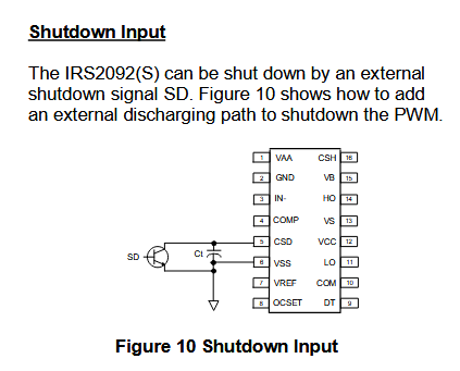

There is a shutdown procedure for IRS2092.
There is more than one option to resolve your problem - try to find from where it comes first.
See figure 10 on the Infinion AN-1138:

Using the shutdown pin from a properly derived signal would be the best option. However, IR does not anywhere mention this function in the datasheet. It mentions that CSD is used for shutdown. What, where, how? The AN in the link you posted properly describes it. It also looks like it is published by IR so I think it is reliable. The datasheet is hopelessly limited. I would not dare to recommend the use of CSD without experimenting first. Or reading the AN.

Thank you very much for all your replies.
As ron68 suggested I disconnected the preamp, shorted the amp input and there was no pop after shutdown.
Tried again without the shorted input with the same result - no pop !
So as you said the pop is caused by preamp.
From all your suggestions the most easy one for me is the speaker protection relay.
The mini transformer powering the preamp is 15-0-15 V so it is not suitable for speaker relay, is it?
But in power supply module there is +15V output powering the thermal speaker protection circuit in amp.
Can I use it for powering the speaker protection relay? Isn´t AC 12 V necessary for the relay?

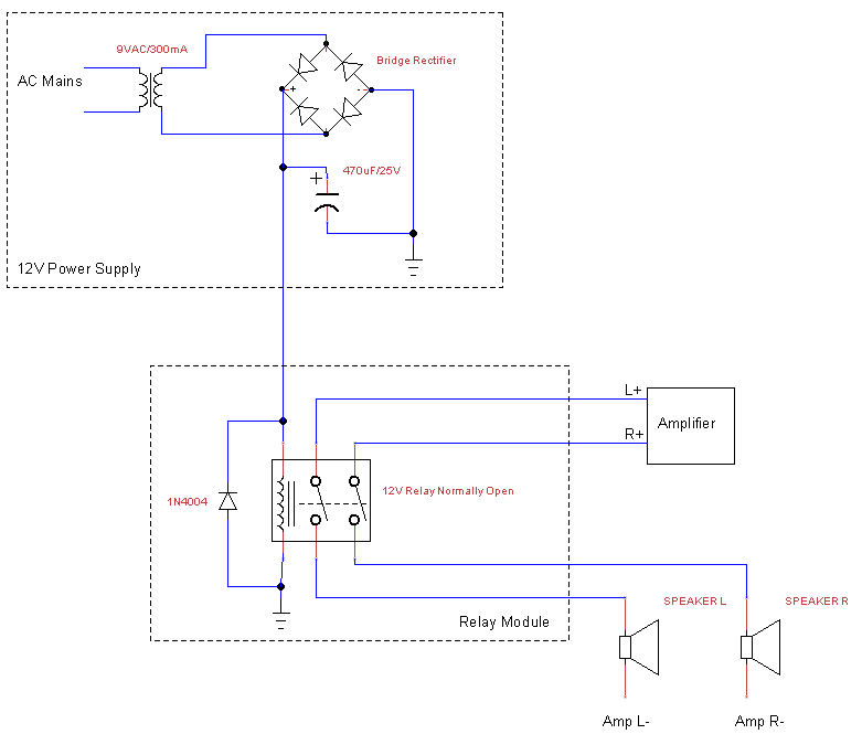

It depends on the relay power consumption.The mini transformer powering the preamp is 15-0-15 V so it is not suitable for speaker relay, is it?
Taking a quick look, a mini relay that handles 20A consumes 640mW (0.640/12=53mA.
You need to check how much current is available in this transformer in order to not interfer with the pre-amp.
It probably can be used (adjusted to the relay voltage). You only need to check if this voltage goes to zero faster that the preamp pops.But in power supply module there is +15V output powering the thermal speaker protection circuit in amp.

Relays can be AC or DC (you choose the relay).Isn´t AC 12 V necessary for the relay?
The idea of a separate AC feed, even rectified, is the time to remove voltage from the relay.
It needs to be faster than the pre-amp pop.
If you can have a separate transformer just for the relay, you can rectify using low capacitance in order to quickly drop the voltage as soon as you turn the amp off. This is the simplest solution.

I had the same problem with one of my irs2029 amps.
It turned out with very large smoothing capacitors the power supply voltage decays too slowly and the pop occurs.
I designed a small VCC voltage detect that once under 12 volts it shorts reset pin via an opto coupler but also through a 220r resistor.
Without the resistor it blew up the irs2092.
