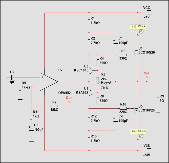

I am very pleased with this design.
But be aware this amplifier only exist in SPICE simulation.
Supply shuld be 2x18VAC transformer giving like +/-24VDC.
THD at 1 Watt in 8 Ohm is like 0.00035%.
Max output in simulation is 25 Watt.
Upper frequency is like 1.3 MHz, so a lowpass filter should be put at the input.
Enjoy!

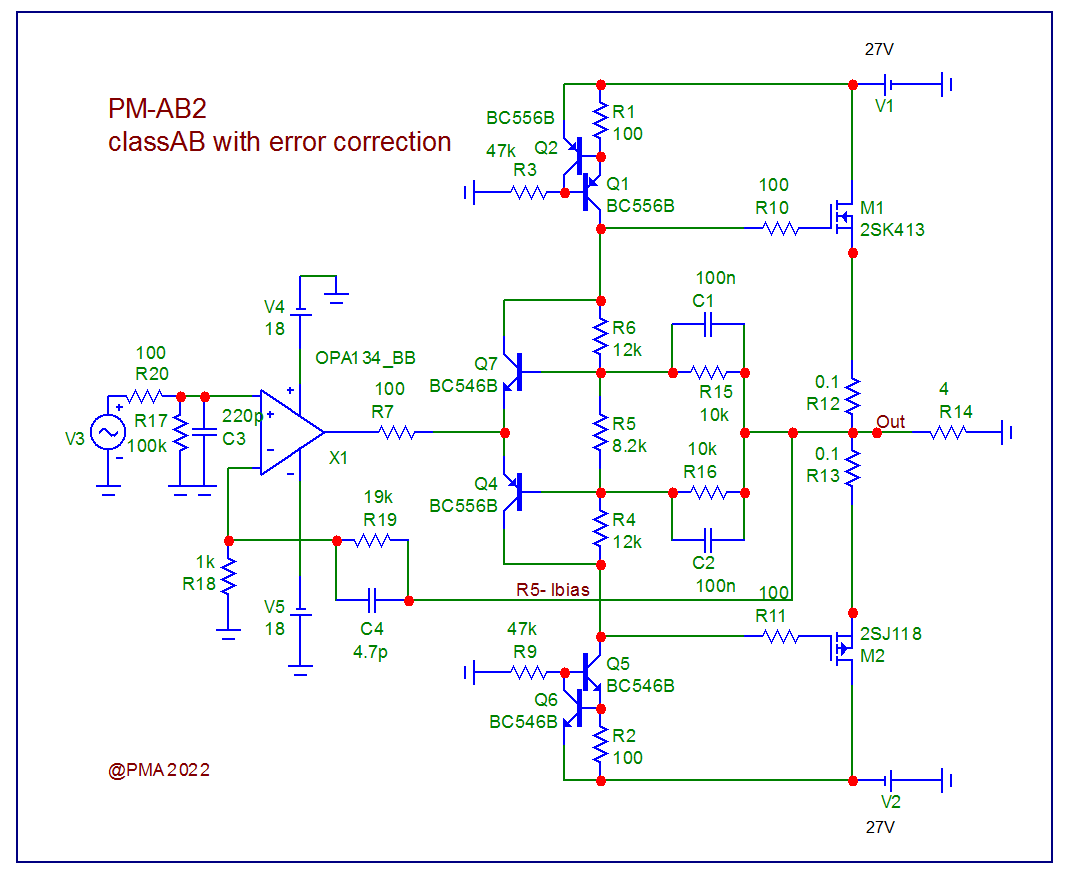

It was already built, @lineup , and better.
At post #25 and 26 of this thread:
PM-AB2 MOSFET amplifier with error correction and low distortion​
you can find how jxdking optimised this amp. I dont think it is possible to make it better than that.
I have tried it and with OPA 1655 it is about 0,0008 % dist.
It should work better. So try with another OP without the rail to rail output..
It does not work well with lateral fets.
It is easy to rearrange it with floating PSU and then you can have any drive voltage.
Reactions: mason_f8
You can implement Error Correction with this output stage.
The idea of MOSFET with Error Correction originally was from Bob Cordell’s paper, but I found the original implementation was very cumbersome. My design was originated from @PMA post. That thing in his post is heavily underrated. I actually built one this year with some minor changes.
