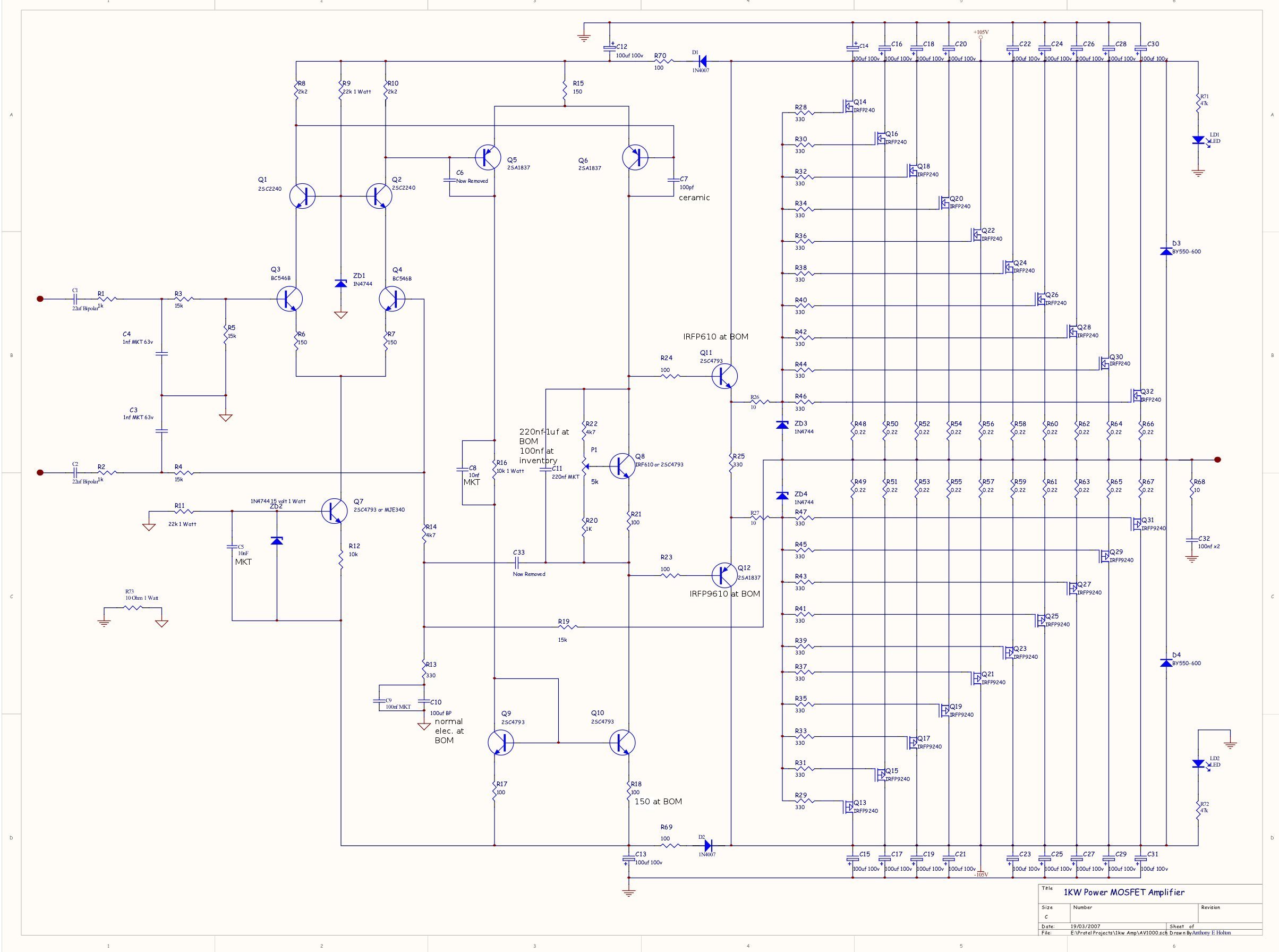

Is it ok to use unmatched Toshiba devices? They are quite expensive to buy a lot of them and use only 10. I'll post the design so that you can see if it's feasible to use the Toshiba pair instead of the IRF devices.

It seemed to be the same when I looked at the datasheets. What about modifications on the bias circuitry?

Hope I did not get it wrong :
IRFP240 - left to right : GDS
2SK1058 - left to right : GSD
I think we can use IRFPs for the AV1000 w/o bias modification (make sure please, don't set a CNY firework show) I had used it for AV400. Only the pin-out is different. There seems to be no indication of the pin-out in the original IR datasheet but the one from Fairchild shows it.

I was talking about 2SK1530, not 2SK1058 😀
Also, AV1000 was originally projected to be used with the IRFP devices, not the Toshiba ones.
