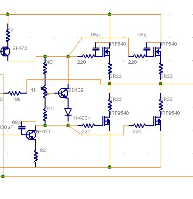

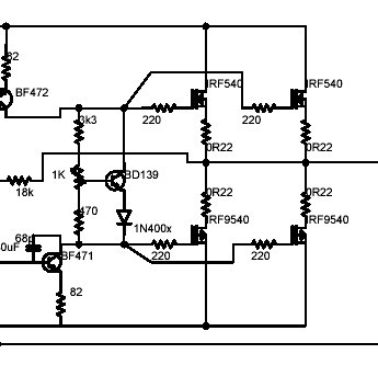

Here is the output stage. I putted 0.27 ohm as source resistors and I biased up to approx 150 mA on each rail with +-35 volt. Before I did not put the BD139 on the heatsink , I could see that it had some thermal runnaway because the amp was increasing within the heat of the IRF but when I putted the BD139 together with the IRF it seems to be stable and decrease the bias when the heatsink gets warm.
Bengt
I usually allow for quite a bit of drift in either direction, say as
much as 25% while the amp is warming up. The primary thing
is that it stays stable once it reaches its ordinary operating
temperature. This usually takes an hour or so, but you can
tell because the temperature stops changing at that point.
This is easier to say with high bias amplifiers, as they tend to
have a more constant sink temperature after an hour or so and
that temperature is less dependent on the signal and load.

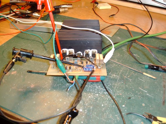

I am testing the amp with a PCB that is not "made" for it. I am still under construction of the PCB and testing the amplifier. But if you are intressted I will ofcorse share my "ideas" with you.
