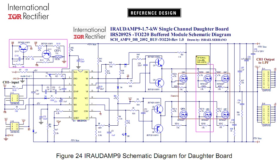

I am trying to build a iraudamp9 clone for subwoofer using..
So I implemented exactly the same circuit as;
http://www.google.com.tr/url?sa=t&r...wbHFBg&usg=AFQjCNGt6pqFAsgRBP2Vs_kz9kgbRgGPyg
Just the amplifier board (figure 24). And added (also tested) an auxilary 12v referenced to -V for Vcc. I have tested +/-5v onboard supplies and saw no problem.
However the amplifier did not start the PWM! Just a sawtooth (~2vpp, @4Khz) I saw on the output... And ~+16v DC offset!
By the way, my supplies are ~+/-45v and not regulated.
What do you think about that problem?

Feedback is needed for oscillation. It won't work without feedback. It's weird to notice feedback components missing from the schematic.

Feedback line modification works... Thanks..

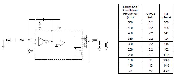

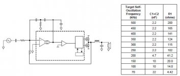

But it oscillates @ 14-18Khz! Not more. I have tried a lot of combination for oscillator circuit (C21-C23-P1-R21 and according to AN1138) but nothing's changed!
Upper MOSFET works like 90% duty cycle while the lower one works like 10% everytime!
Now where am I mistaken?🙁

Yes they alll right. In first attempt the oscillator circuit was 1n+1k pot+470+1n. But after I saw 18Khz then they replaced with 2.2n+150R+2.2.. But nothing changed.
I suggest change the 2092 !
I already changed it one time. However my 2092 stock level is only 2 pcs...
