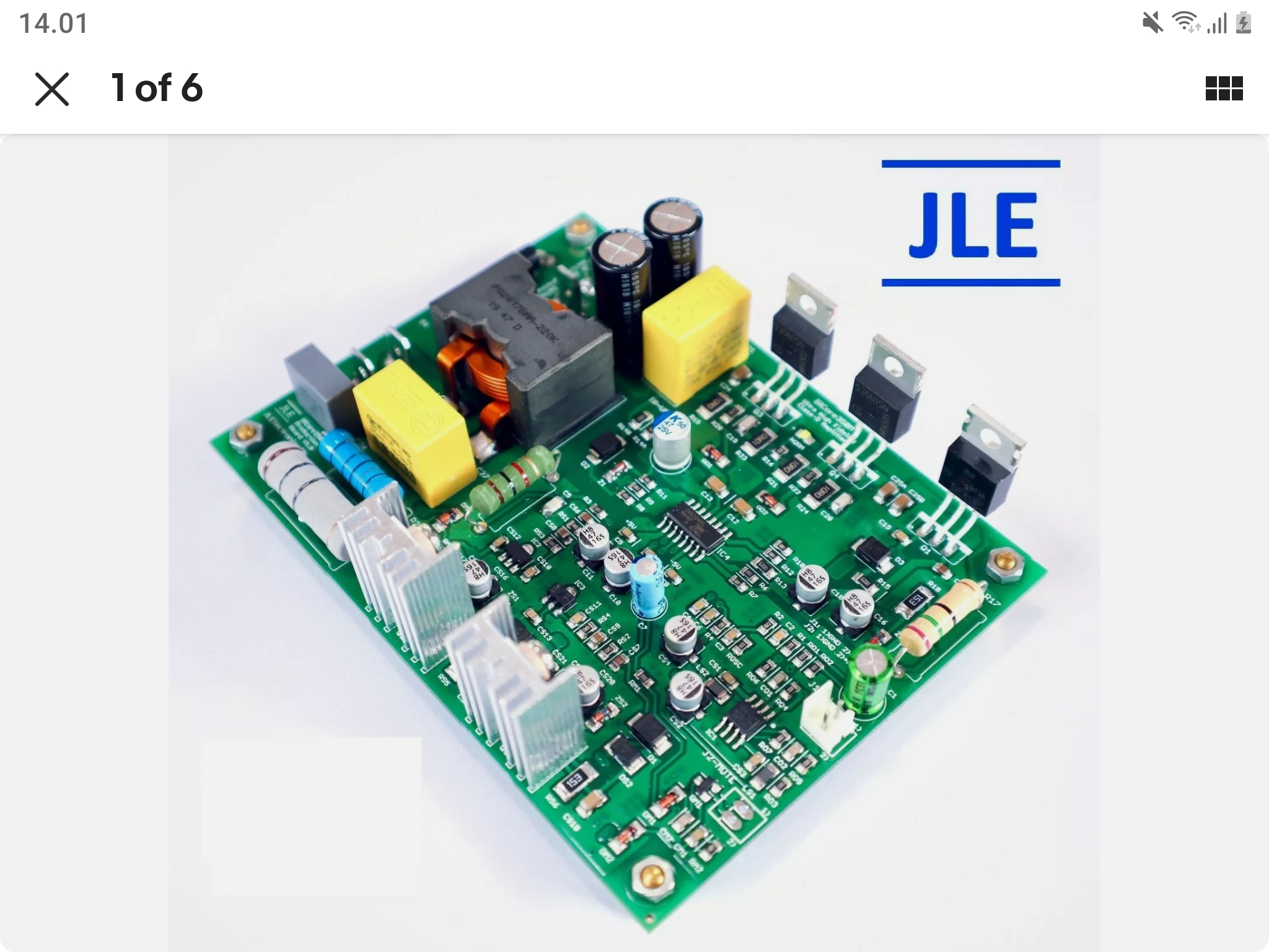

The irs2092 are driving the irfb4227 directly, no totem pole, my guess is they will have a hard time.
If you choose to to buy them, do yourself a favour and add a small heatsink to the irs2092.

Yes, I think they will drive them directly, at least from the photo I see here:
So different to what is suggested here: https://www.infineon.com/dgdl/iraudamp9.pdf?fileId=5546d462533600a40153569aee022bff

Here's a pic and a link.

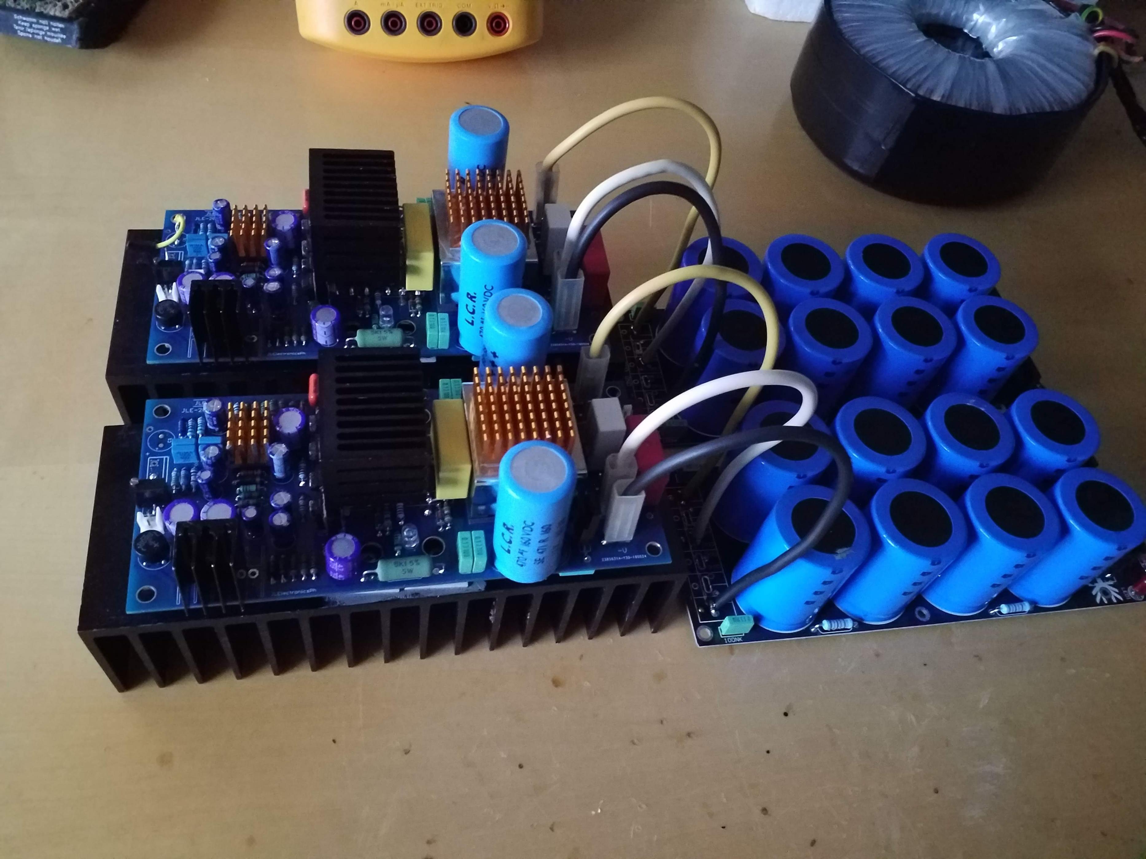

I add a pic of two modules I made from his pcb
Four irfp4227, and bd139/140 totem pole driver, think his new updated version uses a dedicated mosfet driver chip

About your question of adding a totem driver, it would be very difficult, the layout is critical to make this arrangement work properly short traces , proper grounding etc, way out of my expertise
