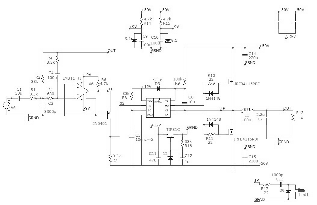

any self-oscillating/UcD amplifier schematics around that use the IR21844?
I have a few of these guys laying around and need to work up a small amplifier module to replace an output module of a subwoofer.
any ideas? Most of the ones I find on the web are based around the IR2010S or 2011. I have the 21844.

Not exactly slow , but having a large DT it produces large THD . Something about 0.1%. It will do for a subwoofer.The chip is too slow for full range class D

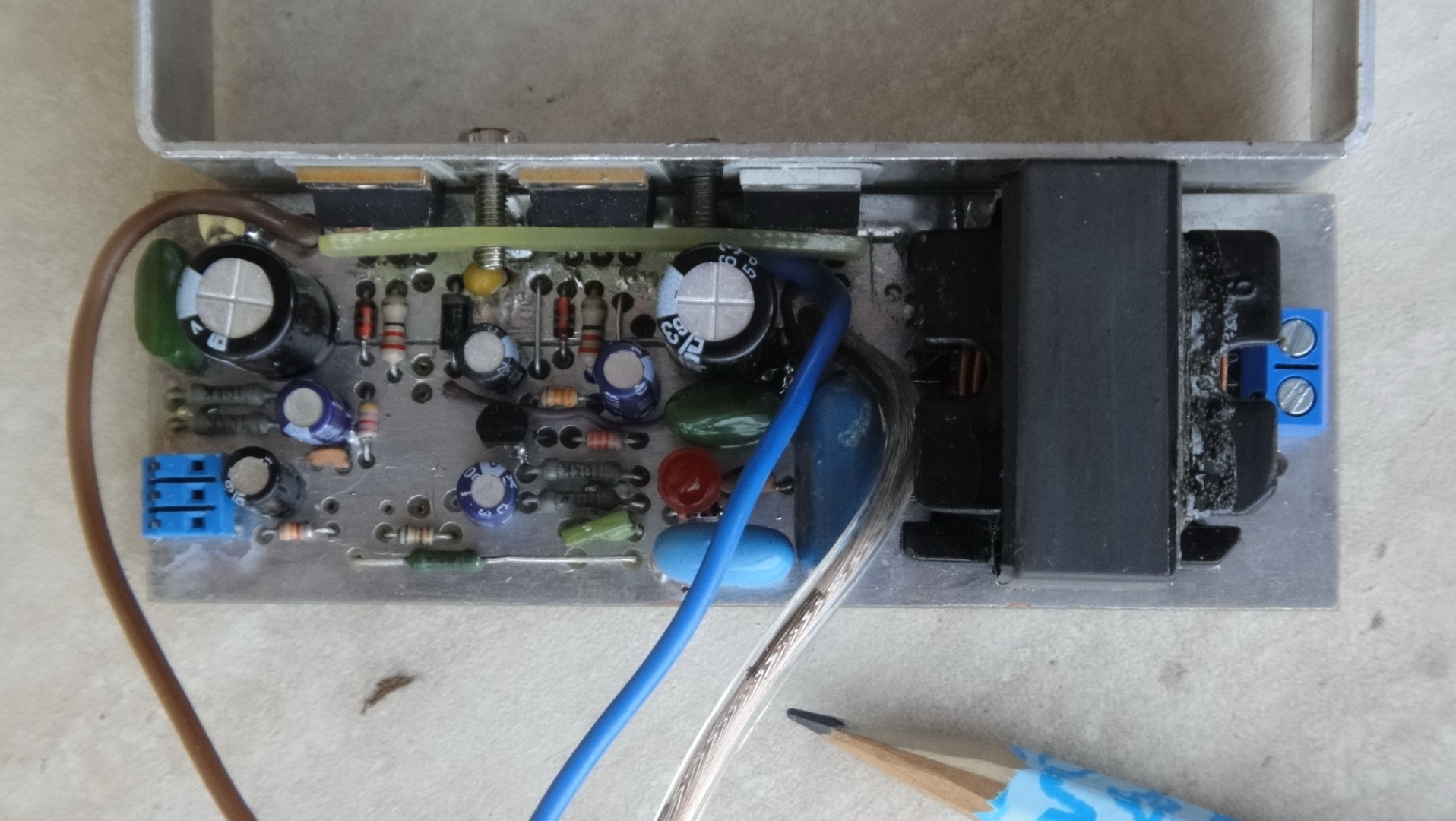

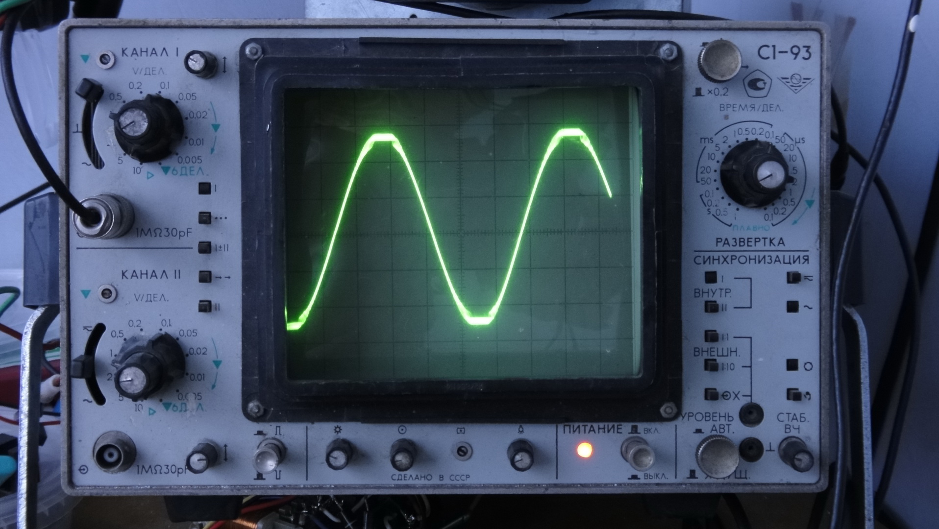

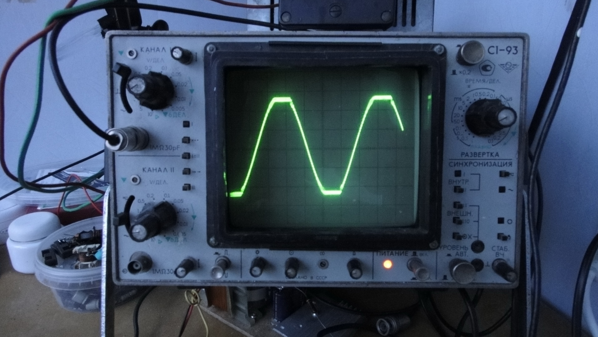

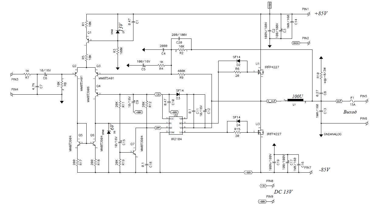

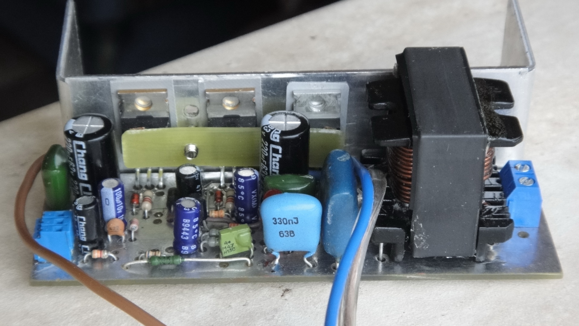

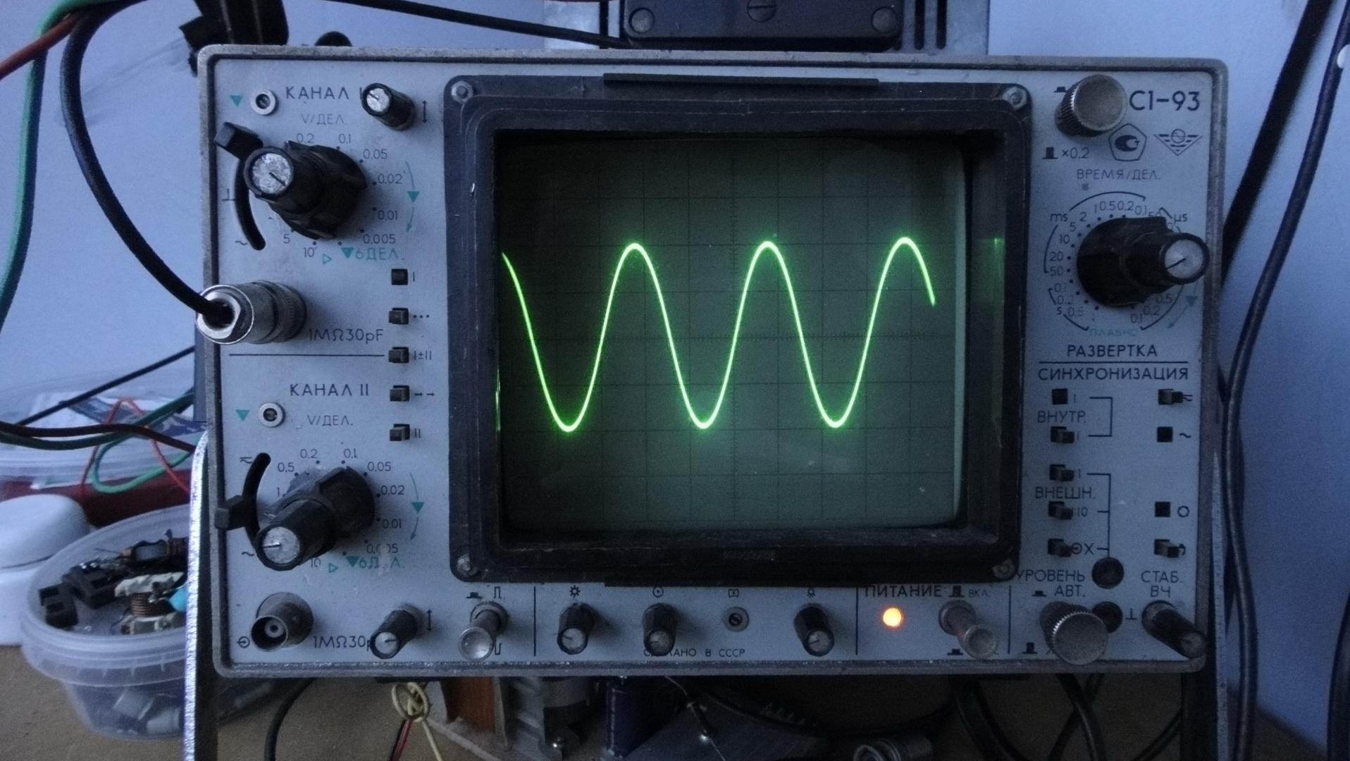

I made several amps based on IRS2184 chip. Look here. ?????? ??????? ?????????? - ????????? ???????? ?????? D - ????? ?? ????????????????. This amp has a combined feedback. It works well only as a sub amp. I also made an amp with second order loop UcD feedback and it sounds well enough in full range mode. I'll post it later here , when I get home to my PC.any self-oscillating/UcD amplifier schematics around that use the IR21844?

Well Perhaps I wasnt clear. I forgot to mention that I am not building a full-range unit. I am building a subwoofer amplifier, so that chip should be ok.

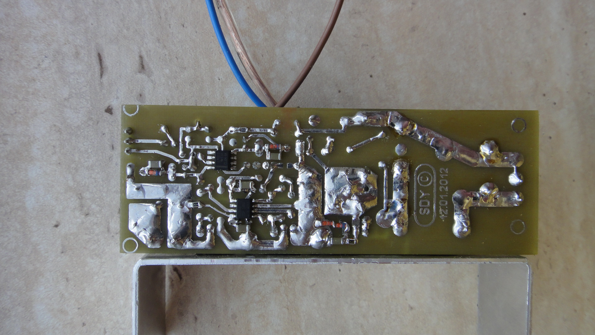

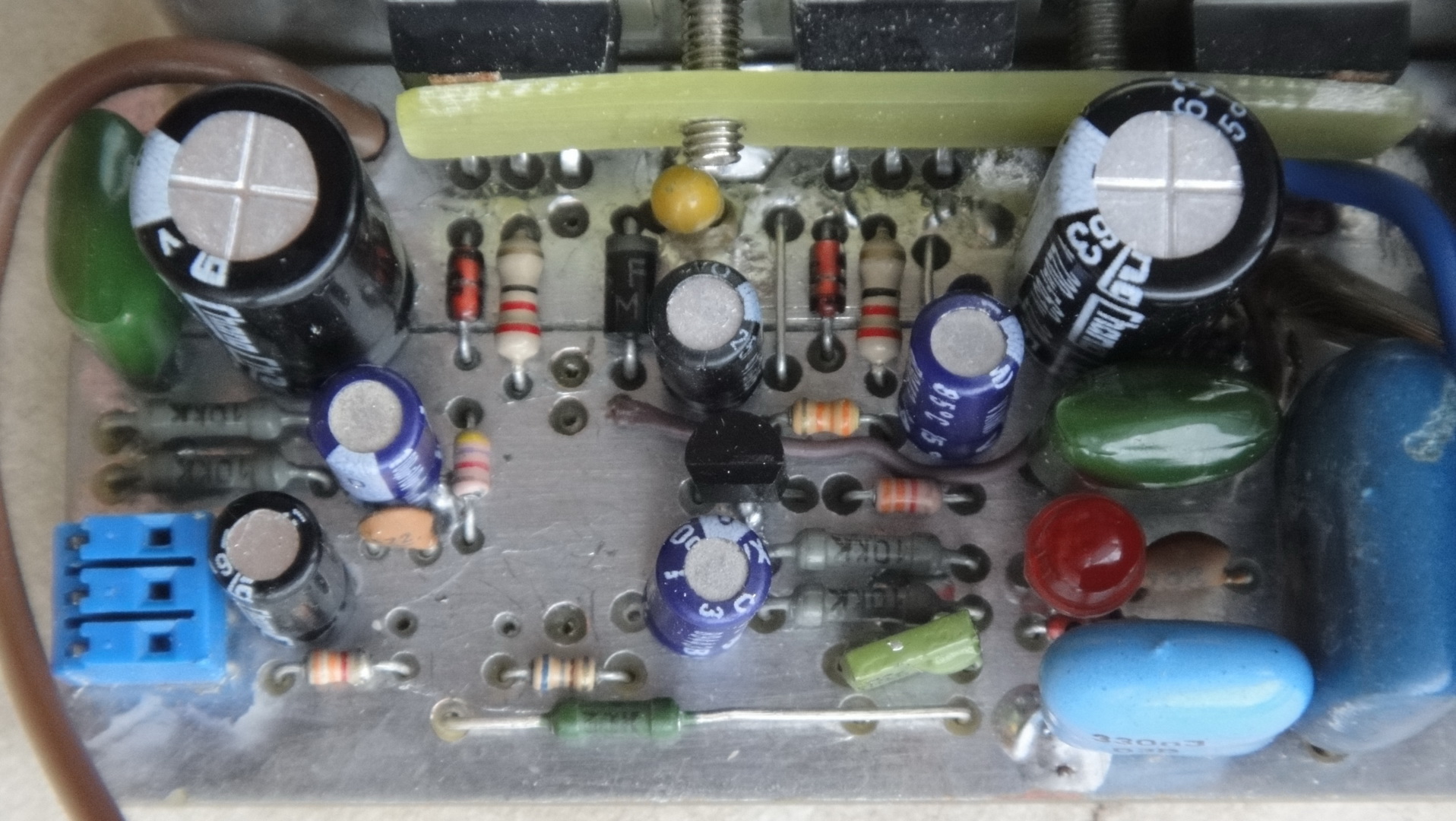

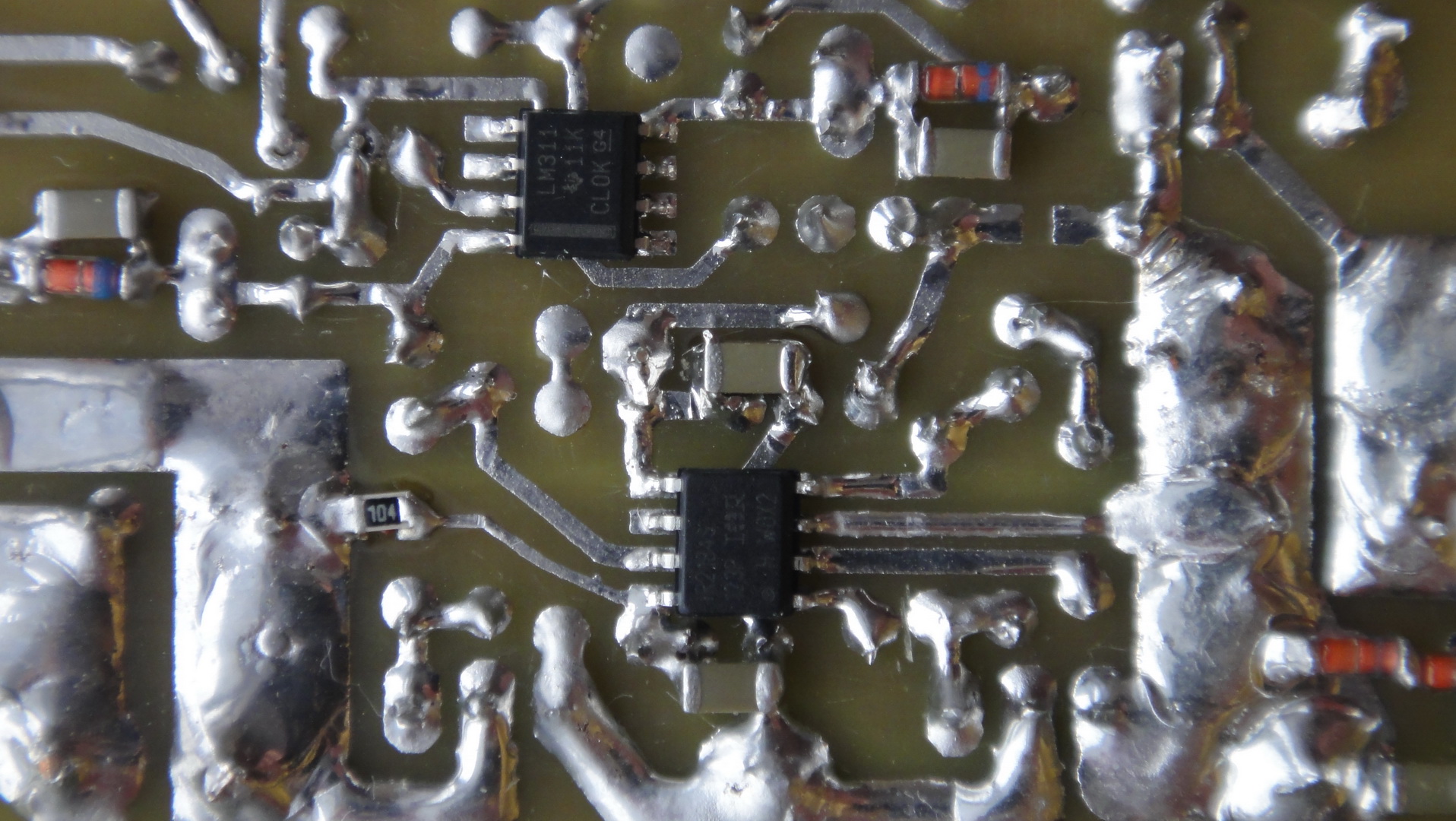

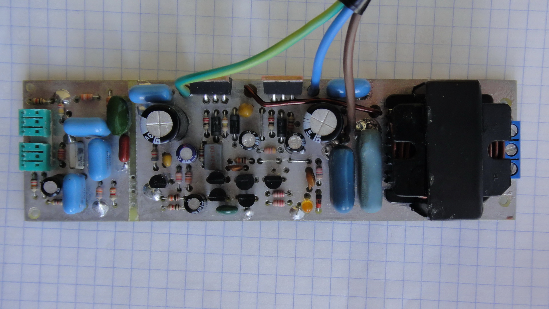

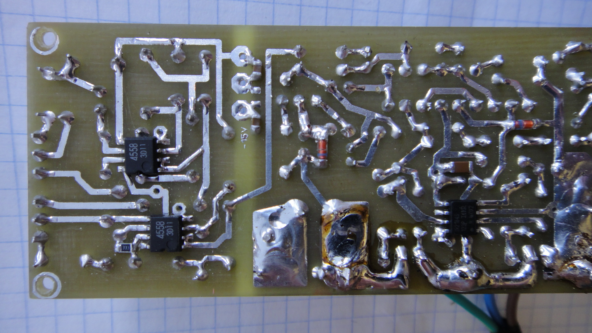

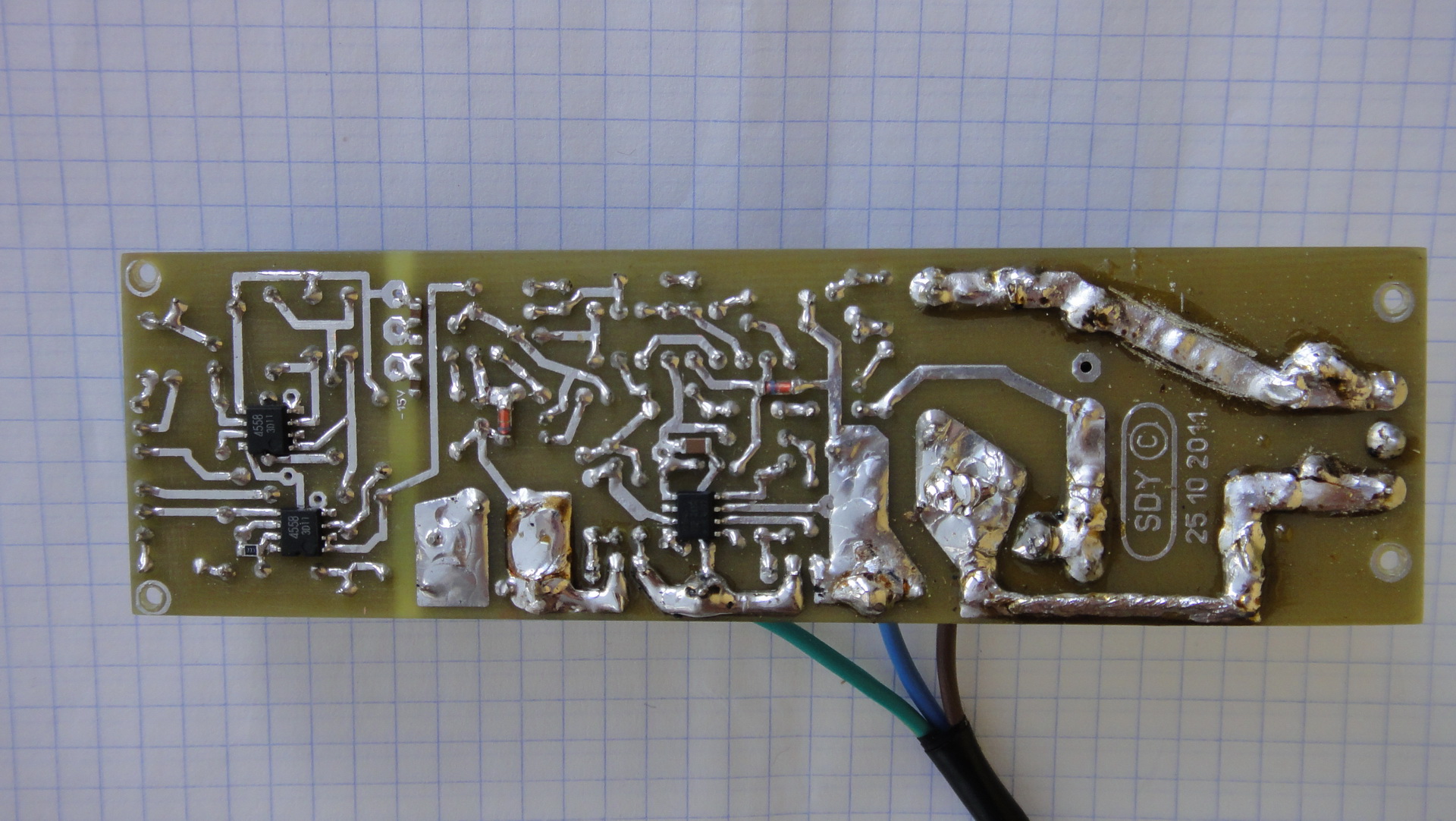

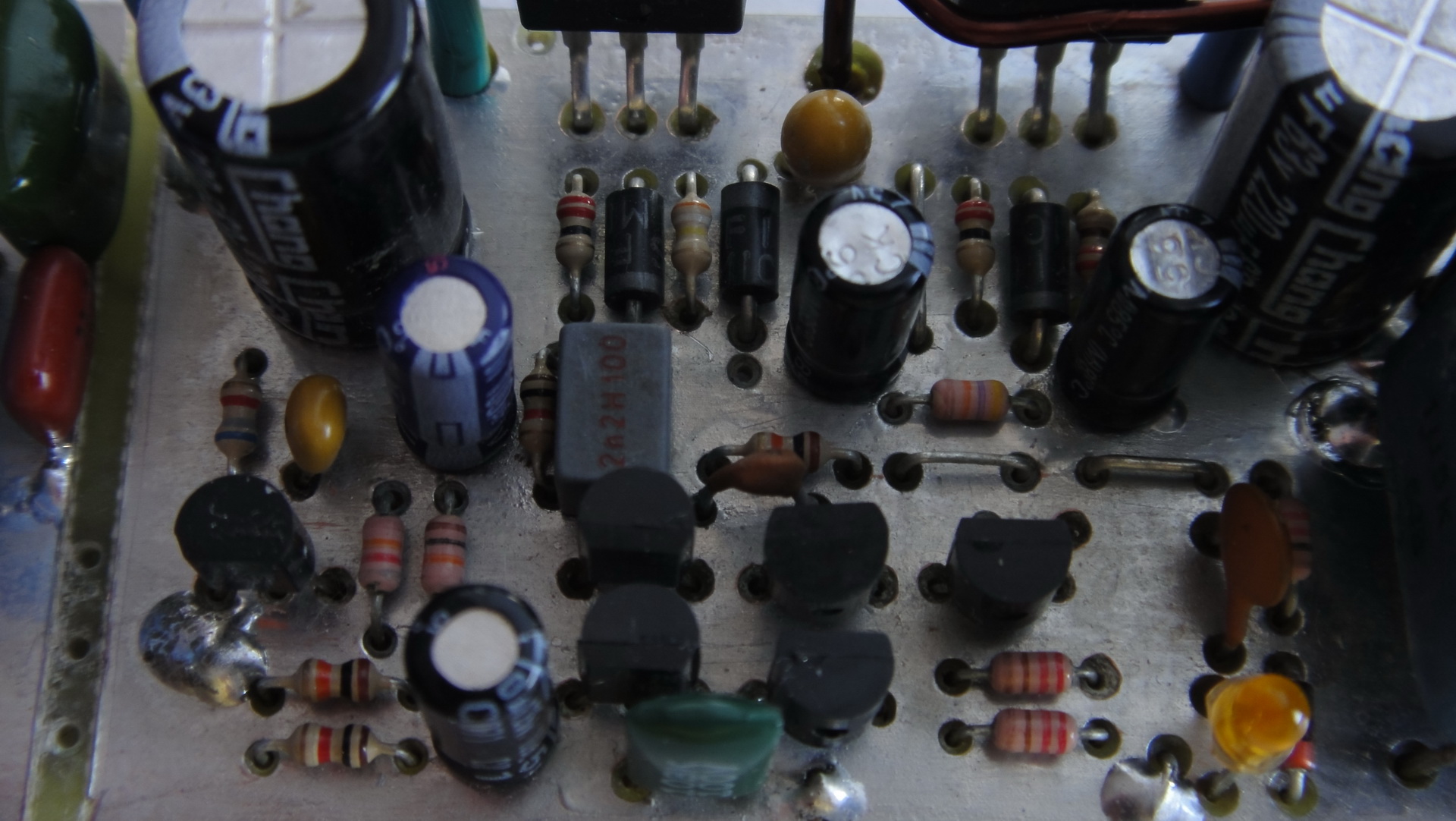

Some foto & info more :
Here is the one with the discrete modulator , with low&high pass filters on board.
Thats basically what I needed.
I am building this circuit to replace the S64AMI module in a crappy JBL Subwoofer.

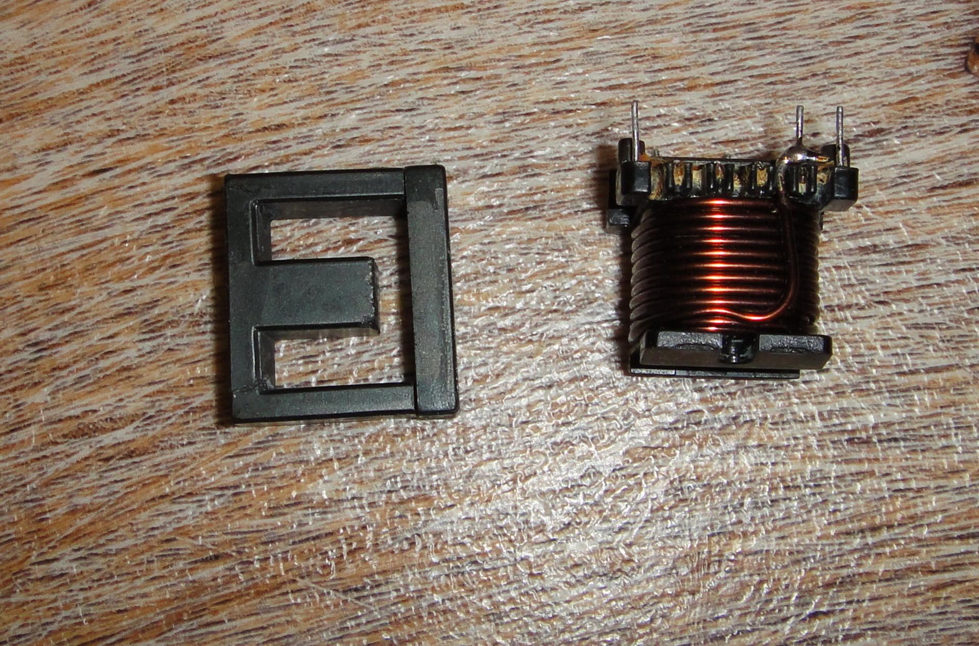

PB10 has +/- 47V power supply . It's suitable for 200W 4Ohm. You can use also the 110uH inductor. What mosfets are you going to use in the output stage?

I prefer little heatsinks 😉 as in my foto's above .
