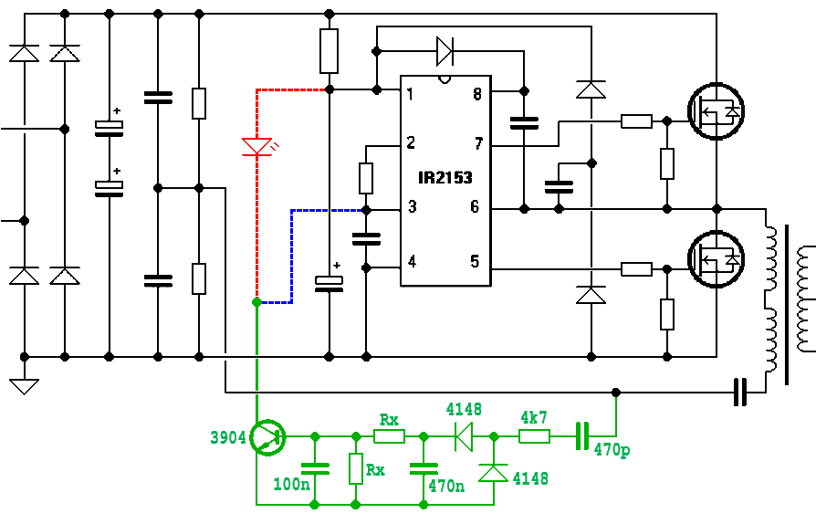

I have a problem with my diy smps for class D. Sometimes a transistor explodes when turned ON. Unfortunately, it also takes circuit 2153 with it. Apparently missing soft start circuit. Runs absolutely reliably when it survives the start.
I need to implement a soft start circuit. I found two similar schematics. Version 1 - via LED to pin1 (Red line in schematic). Version 2 - to pin3 (Blue line in schematic) Please advise me. Which is better?

In your circuit neither. The 470p capacitor is connected to the soft centre of the reservoir capacitors which is a 'stiff' voltage. The circuit operates on the dV/dT (=I/C) across the 470p capacitor as an indicator of current. Connect the 470p capacitor to the other side of the resonant capacitor. As an aside note that the circuit, correctly, only senses when the upper mosfet is on charging the resonant tank. The bottom mosfet effectively just recycles the resonant current. The signal filtering to the 3904 might be too aggressive. Try smaller Cs. Use version 2) to shut it down. Version 1) just lights the LED but you already know the supply has blown up as a result of the bright blue flash and massive bang!

What is Cs?
Sorry. C's, capacitors. I was kind of wrong about Version 1) it should/might disable the IC by removing its power as supplied from the HT dropper resistor.

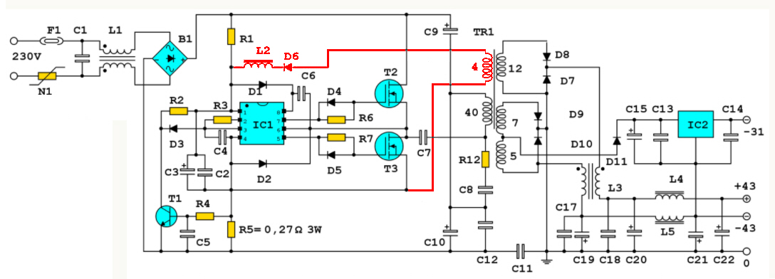

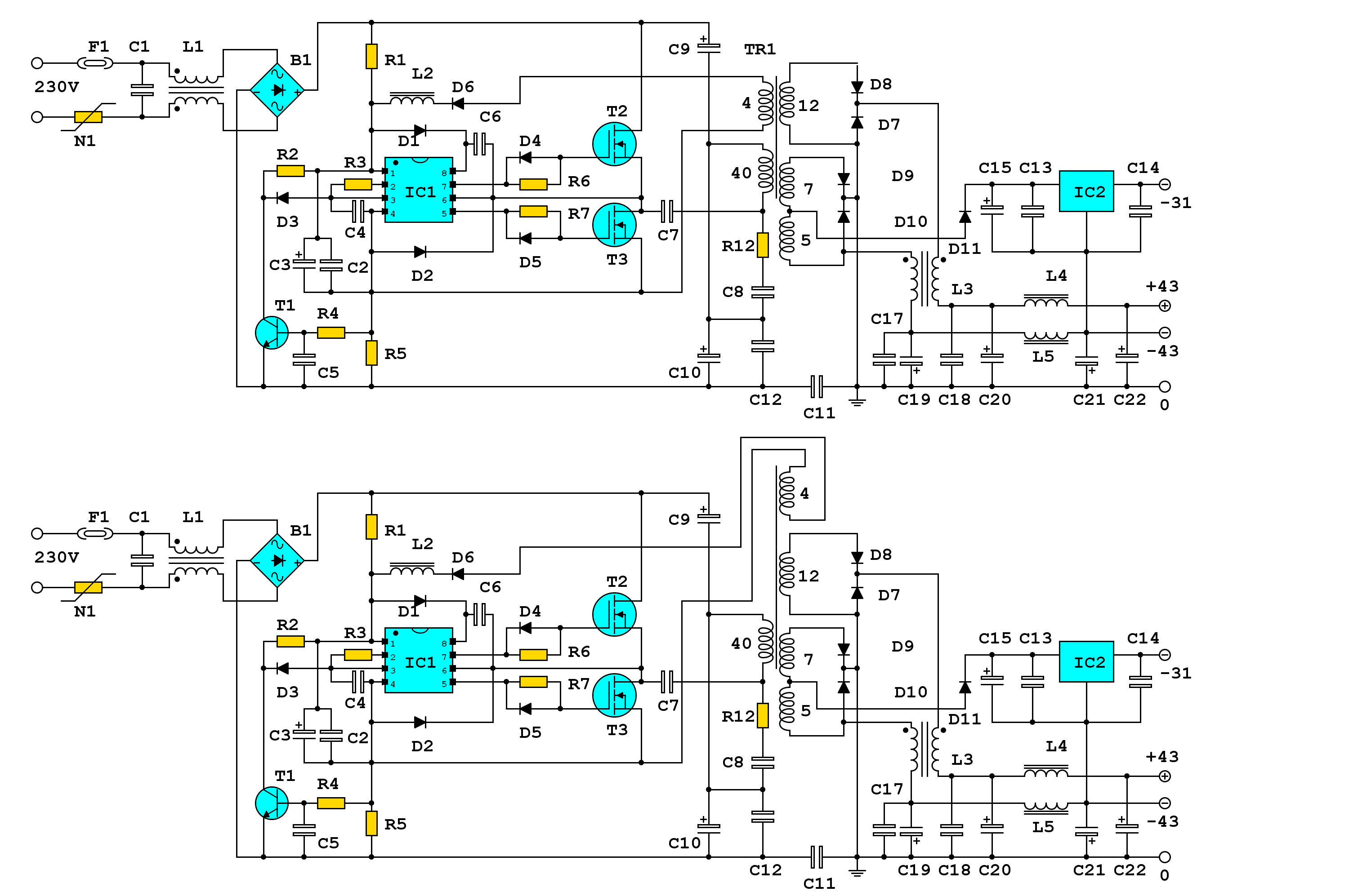

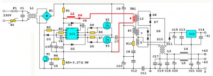

steppler said:What is the meaning of the red marked part of the circuit?

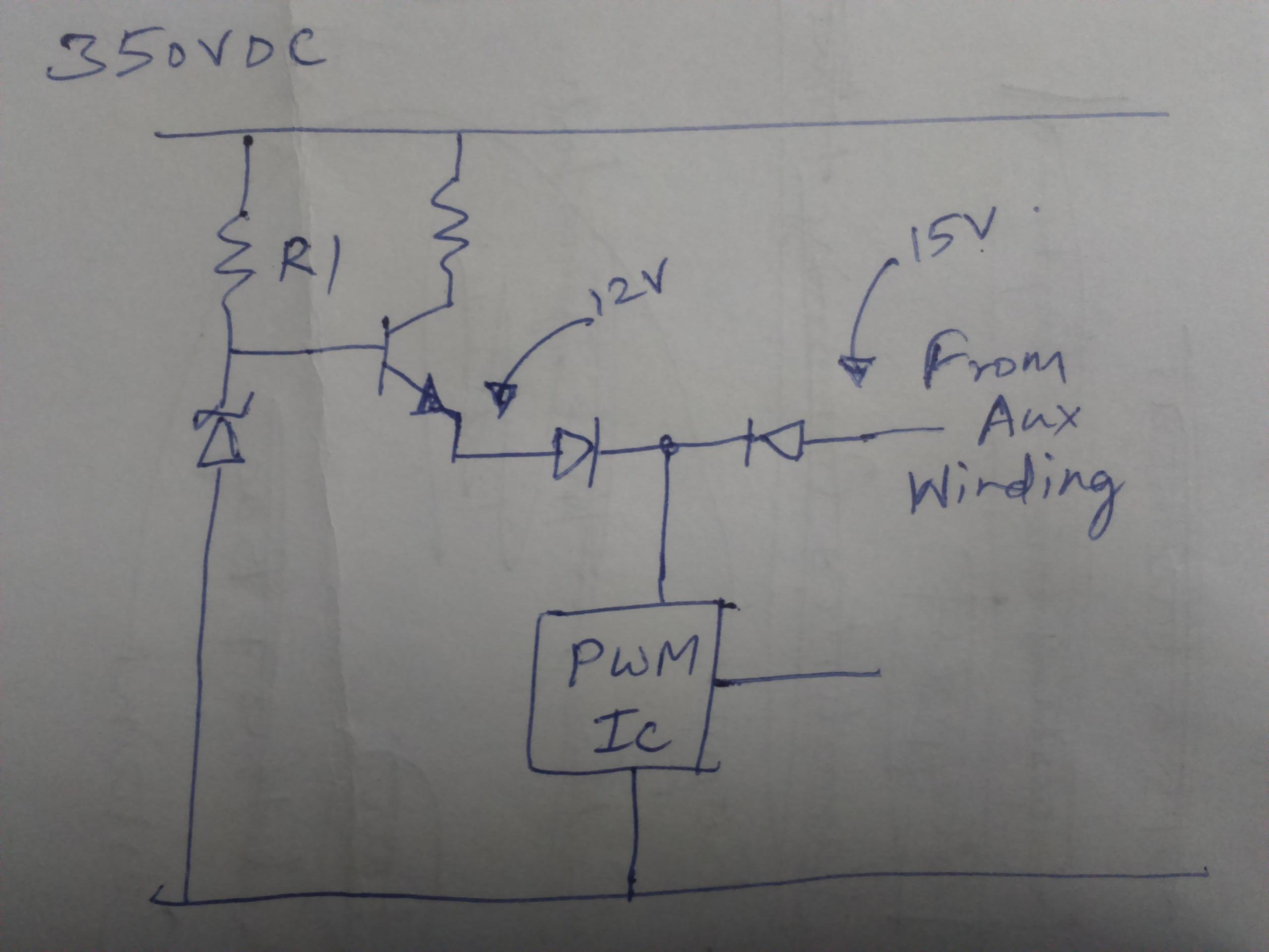

Once the IC has started up, the voltage from the red winding is supposed to run the IC thereafter. A variation of this method (picture) also cuts off the starting power supply by reverse biasing the left-side diode after startup, by using a slightly higher voltage on the auxiliary winding.
