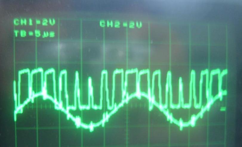

thank you..i found and bought 5 pieces of lm360..and i made a triangle oscillator with cd4069..i comparated 30khz sinwave with 300khz triangle.and i saw pwm out.i have to do my amplifier..monday is the last day..best regards

Umut, post your results soon, and also check the polarity of output before implementing NFDB....It is crucial...😉

hi.it is a bit late cuz my friend post me the photo of oscilloscope late..it is the pwm out.i comparated20khz sin with 200khz triangle..what do you think about this..and how can i put it into the ir2110?which transistor may i use?

Hi UMUT
I think i have already posted the diagram in previous post. Use IRFP250N Mosfet as output device.....
