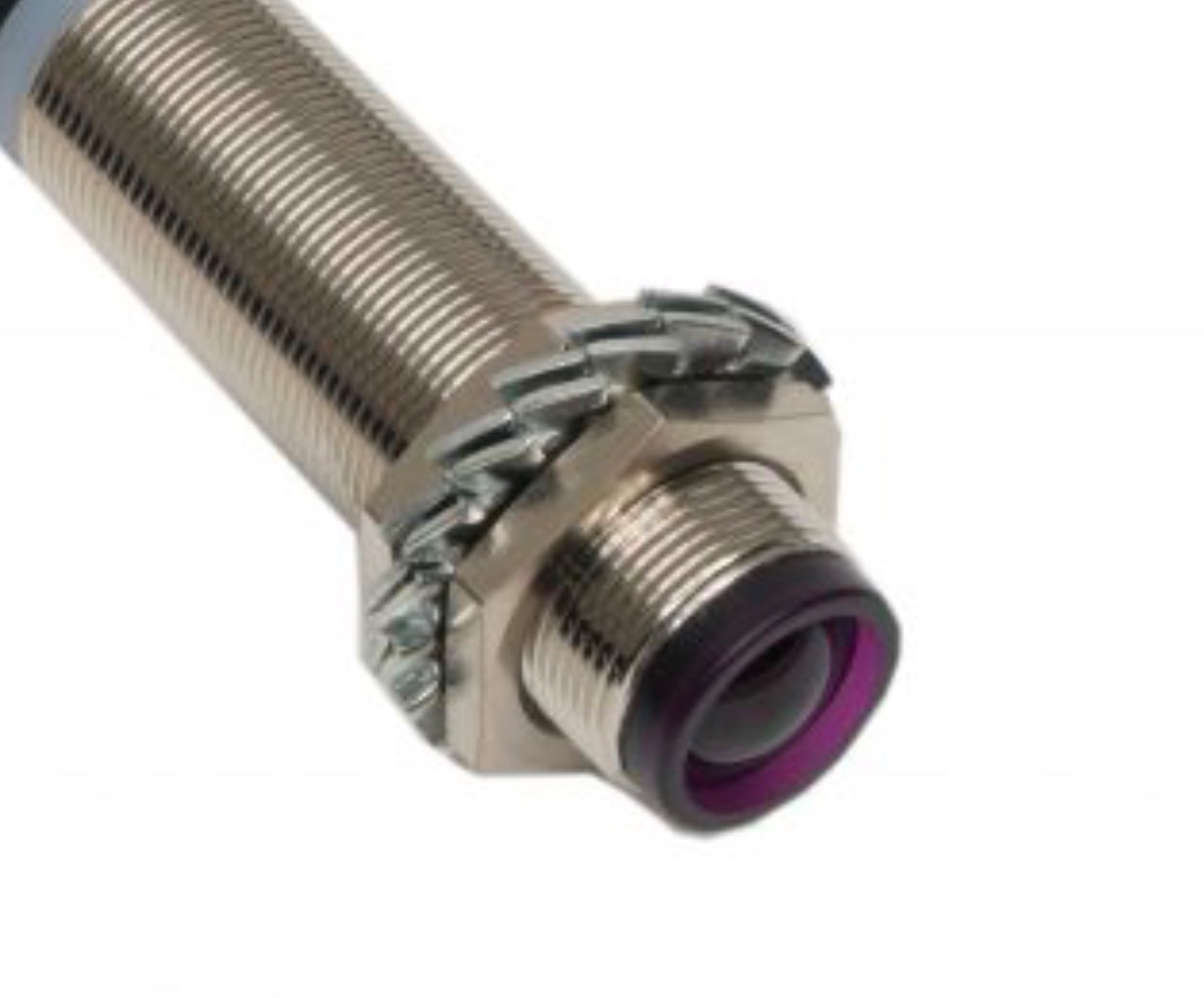

I’m looking for an ir receiver (3 pin) that I can mount to a black anodised 10mm thick panel. I’ve googled like mad and found very little - what I have found that are available in the UK are large (32mm). Others are smaller at 16mm but I can’t see how to buy them or even how much they cost. I have been thinking about adapting a panel mount LED housing or a proximity sensor housing but I’d rather buy the right thing and not have the faff of trying to adapt something. I don’t know how easy it would be for an engineering company to make a suitable hole with a CNC machine and fit some dark smoked acrylic into the hole. Has anyone got any ideas or experience or good advice?

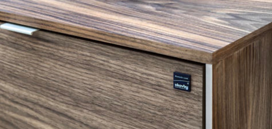

Hi. There exist types that look like panel mount fuse holders with a lens instead of the fuse cap. These are used in luxury furniture to be able to operate devices with closed lids. A built in IR extender.
Recently I repaired a hinge of such a cabinet and saw it for the first time. Needless to say this was not understood as the power adapter was sleeping in the cabinet 🙂

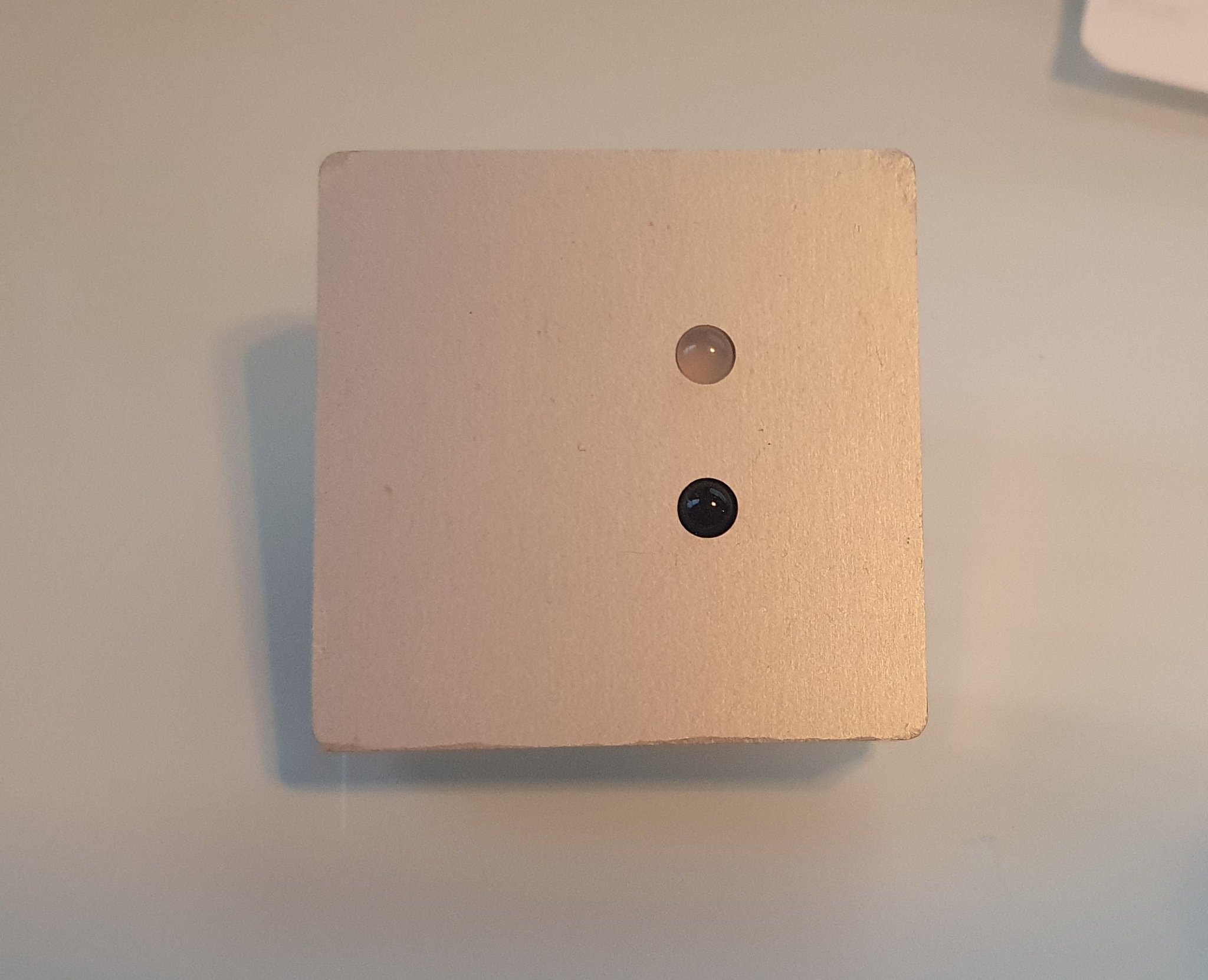

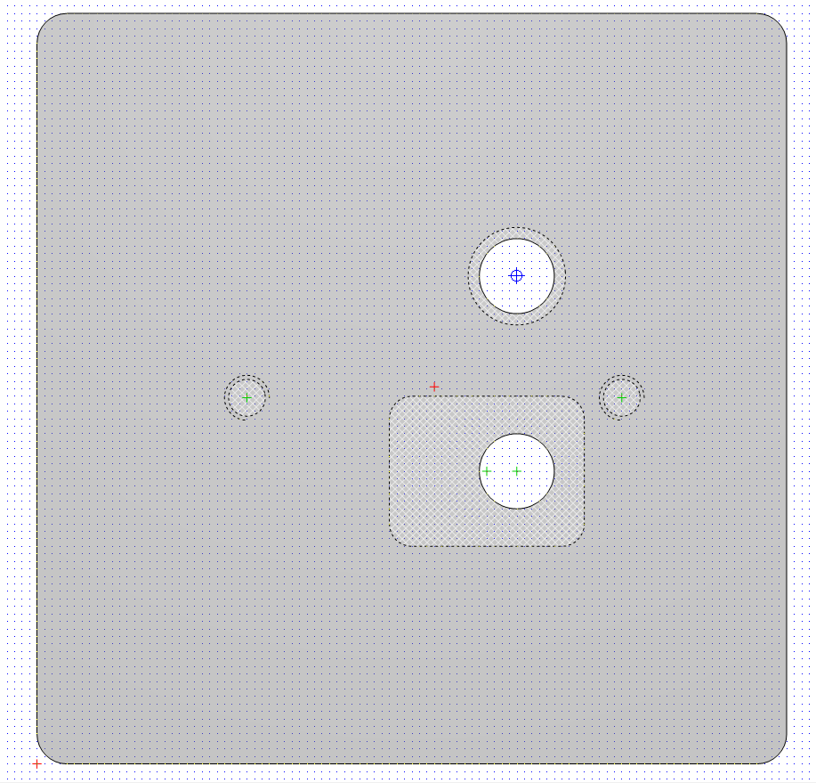

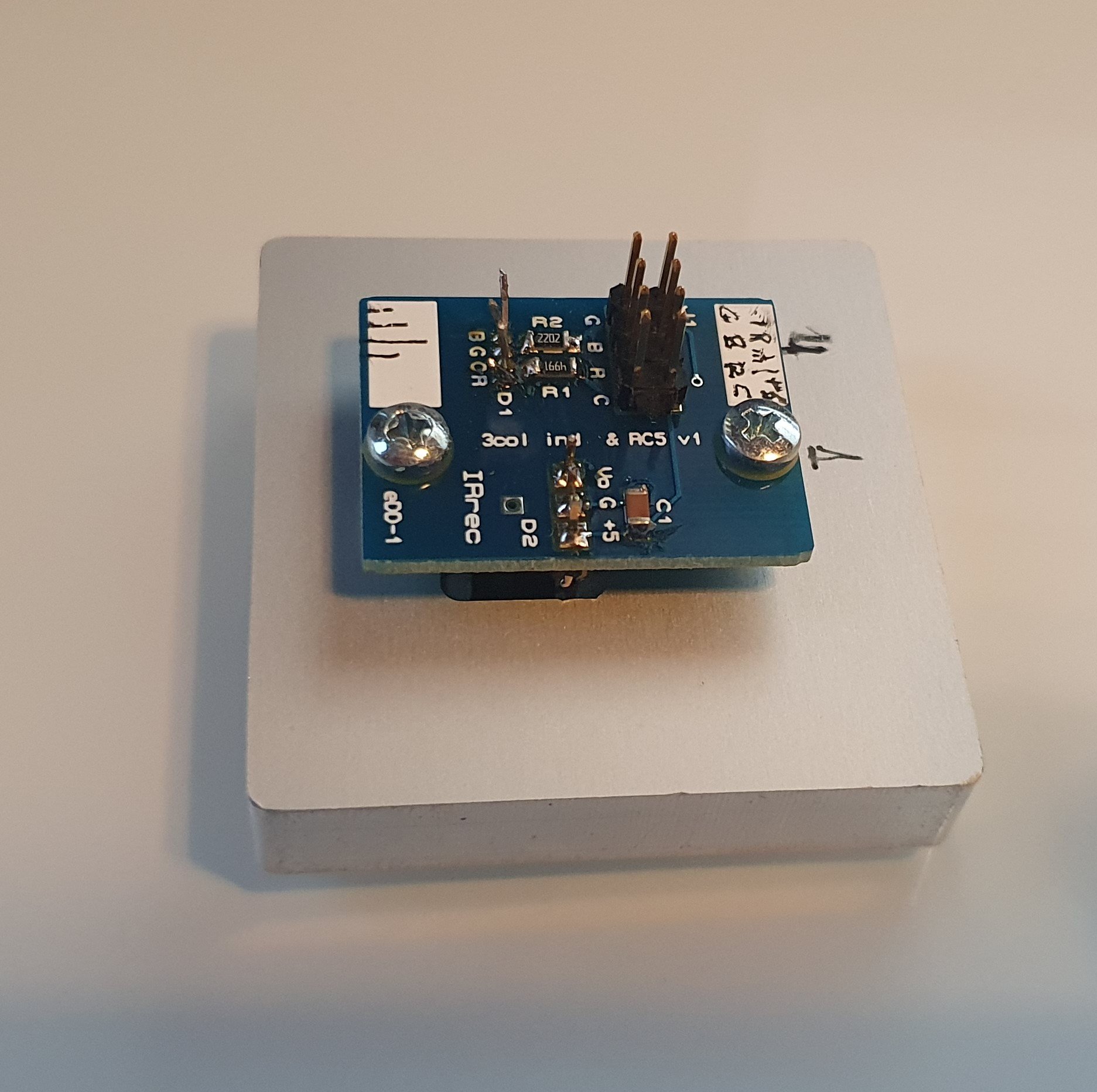

Fair enough. This is how I solved it, the proto for a larger front panel.
The IR receiver is mounted on a small PCB and rests in a cavity that ends in a 3mm hole so it peeks out.
The other thing is a 3-color LED for status indication.
Needs some metalwork though.

Will look that furniture brand up. Very simple and good looking but unobtrusive version. Mount in a wood cabinet door so likely 18 mm suitable. Just 1 hole needs to be drilled. Has cabling too.
Edit: found it. Skovby used 30..60 kHz round panel mount IR sensors until recently. Today they use a version which is both brand label and IR sensor it seems. So no picture of the round one, sorry.

With 10 mm panel thickness you can easily drill the hole with the right drill for flush corners. Tape the surface. Then either glue the sensor at the back and in the hole with 2 component glue (after testing!) or mount it to a small thin metal plate that itself is mounted at the back of the front cover with 2 undeep M3 holes and some distance with short 10 mm standoffs M3. Never the second nut at the front side as that would be plain ugly.
Drill with the right drill and with a steady hand with the stuff clamped and a drill press. Last week I first tried out ultra sharp kobalt drills for a perfect flat hole. The less play there is between the sensor and front cover the better it is.
Probably thread taps exist for that particuliar thread too but that would make it expensive. If you know people that tap thread on metal pipes they will know how. A visit to a metal company can be rewarding too. Just make sure they understand you need a perfect surface without scratches/reworking. Tape the cover in tape beforehand and protect/transport it yourself the whole time.

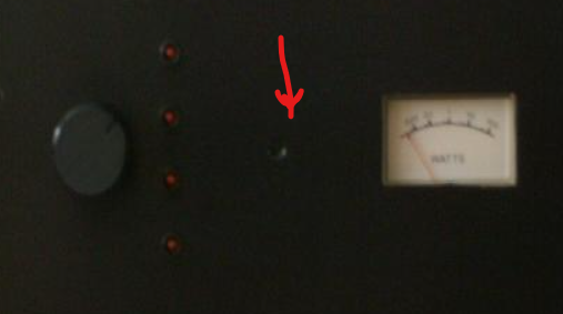

Not wanting to be always crticising but OP has a 10 mm front panel and IR sensors eh… want IR beams coming from various angles. Imagine having to point the remote control to exactly the middle of the hole. Error by design.

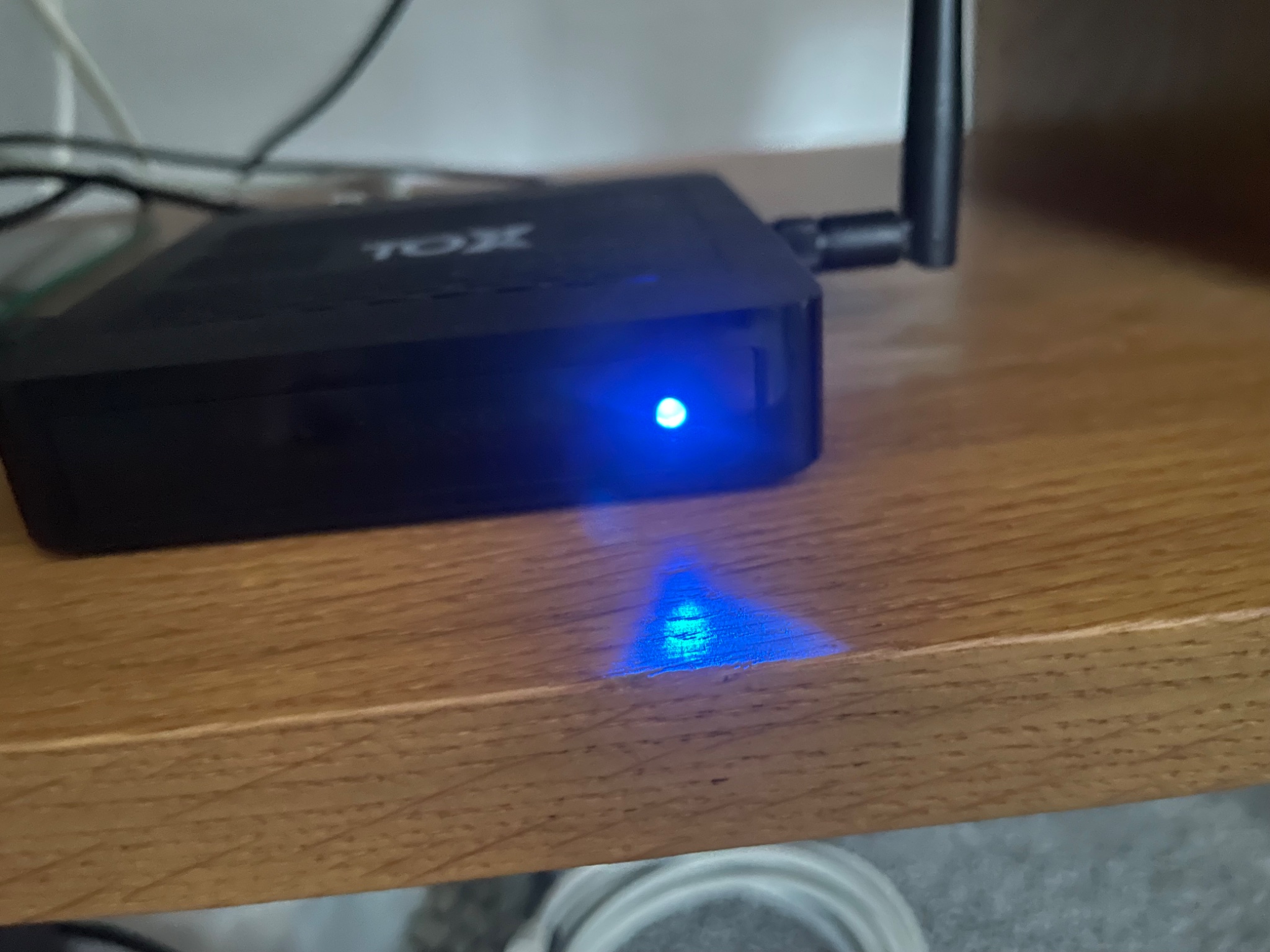

Besides godawful modular hardware designing (like it is software) also a very annoying thing in audio. The devices I have had that exhibited such behavior were quickly modified or even sold. The virtues of Bluetooth/RF remote control are big bonus despite aversion against RF 🙂 But then one needs a cutout in the metal which is even worse to DIY.
To be complete: blue stand-by LED searchlights lighting up the whole room at night in eerie blue light and devices that fart or plop at power on/off are shared number 3.

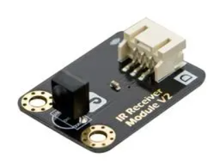

One way to do it is to design a small pcb to mount the IR sensor on with it being lead bent at 90• have the 3 holes to solder the wires. As said mill the back of the panel to a depth and size to just fit the pcb. On the front make the round hole big enough to have the IR lens stick out through it. Have to insulate so nothing shorts to the metal panel. Some glue to hold the pcb in place in the milled out cavity and secure the wires.
