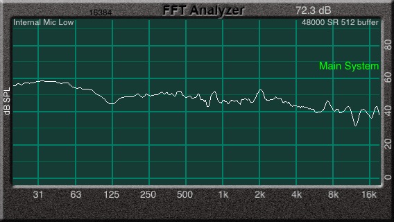

I'm not looking to use it for speaker analysis per se, but more to evaluate the system as a whole (and whether I need to consider room treatment). I've attached a response curve of my main system using pink noise. This was captured at the listening position.
From the little I understand on this topic, this seems to look OK (but I'm no expert). Are these peaks and troughs typical or should I be concerned? 😉

Hint, you need room treatment. I can say that without seeing the room. 😀 Everybody needs room treatment. I don't mean over-priced ugly foam cutouts either.
You have not heard imaging until you have good front wall treatments.
You have a mic eh? Does it need phantom power? What about adjusting gain?
To your specific question, everything below 125 is probably bogus. You did not say where this was measured. If it is at listening position, it looks pretty good. Maybe a bit bright. Pretty heavy smoothing. It is going to take a lot of experience to understand what a toy app like this is telling you. Measure many positions and write down what you think you hear in those positions then compare it all. Eventually you should get a fair understanding you can use. Remember, using pink noise you are measuring both the speaker and the room reverberation. It just does not tell you that much. Your ears do. A tool like this could be handy in the pocket if you hear something very wrong, it may narrow the hunt quickly.
Only worry about something you hear as wrong. Dips are hard to hear. I would be worried if the 7K peak is just the room, or if it was something bad like woofer breakup. Is the 2K peak just the room, or is it a phase problem with the tweeter? You don't have enough here to know.
