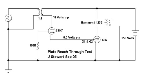

For a project some time back I measured the influence of changing plate voltage on the cathode, it closely followed 1/MU. That on one triode of a 6SN7.
