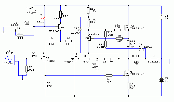

Inspite of the fact that the LSJ74 is temporarily available, isn't it possible to "mirror" the aleph J and replace n-channel with p-channel and vice a versa. This way one could use the sk170 (or even sk389) for the front end which are still easier to get. Also the ciss/crss for sk170 are lower which I have been told is a good thing for low distortion.
Is this possible to redesign it in the inverted way or do I miss something?

Just reverse the polarity of everything, there you have it.
edit - input and output terminals remain the same +/-

possible and already made , even if I can't remember where I read about it .
however - FE Jfets , being biased through CCS , are much easier to change for something less troublesome to have/find
J271 , for instance

...isn't it possible to "mirror" the aleph J and replace n-channel with p-channel and vice a versa....
Here is the amp you look for and the thread you want to read:
http://www.diyaudio.com/forums/pass-labs/152379-mini-aleph-using-bf862-possible-2.html#post1949735
Thx guys. Good link.
Very nice, thanks for the design. Indeed, I have lots of BF862 and IRFP9240 is easy to find.
BF862 is interchangeable S & D
This would be a real cute teeny-tiny inverted micro-Aleph J HPA in an all SMT job with ZVP4525G outputs and SOT23 BJTs. Could probably replace Q4 with BSP129 in SOT223 package to get better heat sinking, Q1 could be SOT223 DZT5401, also for more heat sinking and higher dissipation.

I didn’t not run a sim or anything but from Juna’s Schematic: +/-18v rails gives 36v max swing, minus 2x4v drop for each mosfet. So 28vpp output which is good for about 12w into 8ohms. Assuming a bias current of say 1.2amps typical of FW amps, that’s 36vx1.2amp=43w dissipation.
BF862 is interchangeable S & D.........
....... wrong answer .... 🙂
however , you cheated - edited post later (new schm) , without trace
........ Assuming a bias current of say 1.2amps typical of FW amps, .........
not exactly always ...... and also not exactly figure carved in stone by Papa
I saw your question after I updated the schematic as I got to the later post where Juma corrected it.
The manufacturer’s spec sheet says it’s interchangeable. I have built circuits thus and that appears to be a true statement. Why is that the wrong answer?
https://www.nxp.com/docs/en/data-sheet/BF862.pdf
