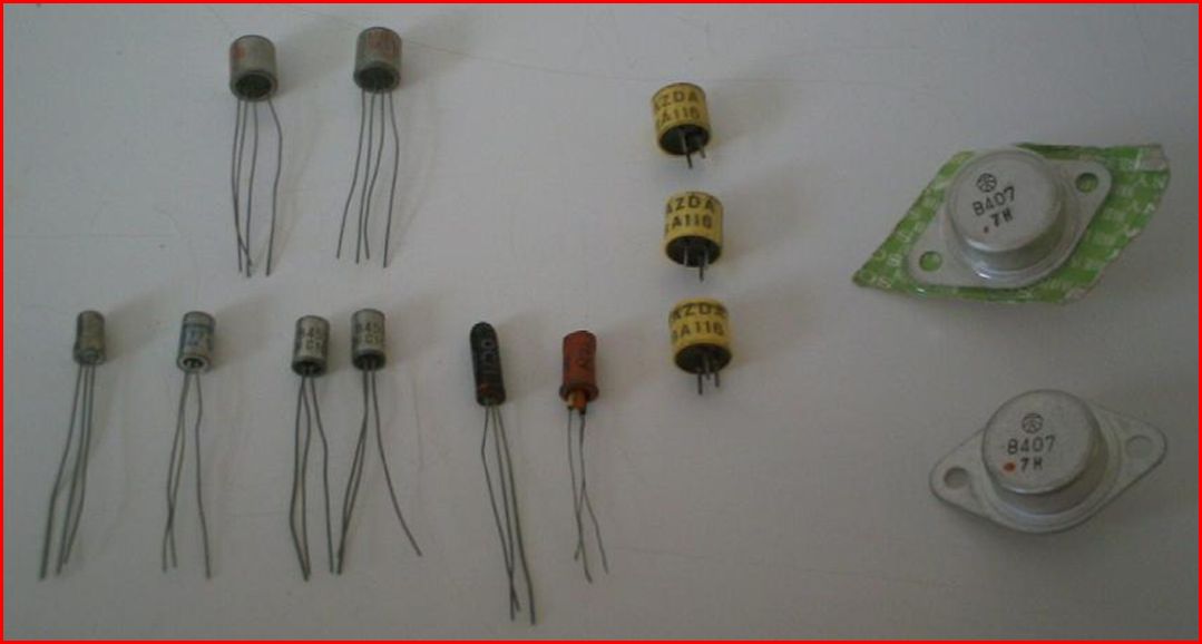

I remember the OCP71, the photo version of the OC71 and the ORP12 ? cadmium sulphide photo resistor.

thanks for the picture. Which ones are photodevices?Some golden oldies here 🙂
Only the black OC71 would work as photo device if you rubbed the paint off 🙂
Ah, OK. well I was looking more for original devices, semiconductors that were designed with the window there. I'd like to get some part numbers like the FPT-100, (thank you scott wurcer) and possibly obtain some if anyone has any...
