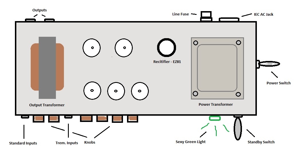

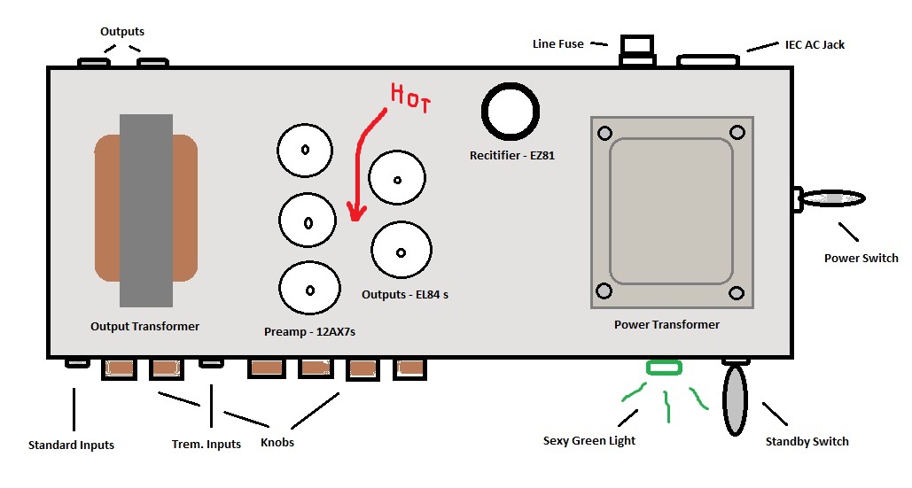

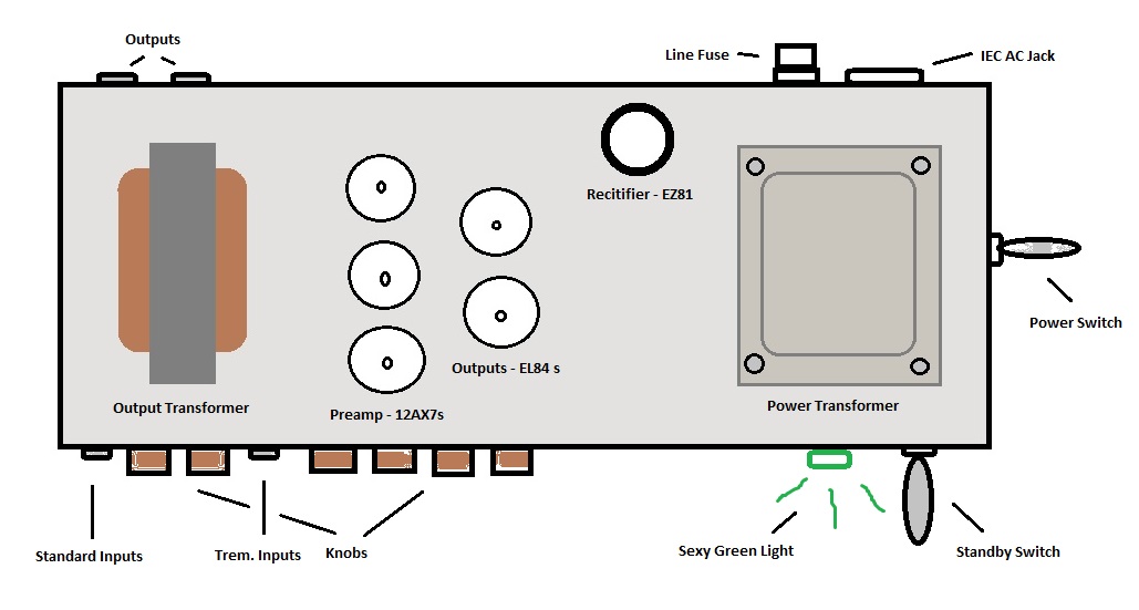

I put together this extremely technical diagram of my proposed layout this morning (see attachment). Thoughts? Please note that this drawing is not to scale with anything, including itself...

Not to mention it would be a better idea having the output valves near the output transformer, rather than the preamp valves.
To understand the heat issues it helps to consider both the radiated and convected heat. Most designs let the output tubes radiate heat out the back and have a vent in the top above the outputs (at least Marshall/VOX and other makes with the chassis at the bottom). You might want additional venting and radiating area (like drilling out the holes a little larger by the output tubes) or a fan. Pics don't show the top; is it perforated too? Tinitus' conventional layout also puts the preamp tubes near the knobs.
If you're using turret boards you might use two, one for the preamp and another for the power amp. Or even a third one for the power supply.
Personally, I would put the transformers at even more extreme ends, and probably leave only 1/4 inch between them and the perf cover. Your case looks deeper relative to its length, so if you draw to scale you might prefer to put the output transformer to the extreme back and put the preamp tubes in a row that starts in front of the OT, even closer to the inputs and away from the power transformer and power supply.

Also plan where you're going to put the large filter capacitors.
Take a good look at the schematics Tinitus linked to. In tight space and limited budged, I advise you consider a good one-channel amp instead of the two-channel amp you drew. If you want more versatility, add a stage that switches in/out, possibly via footswitch relay.
If space underneath looks tight, you can move the filter caps outside of the lower chassis and put them above with the transformers & tubes.

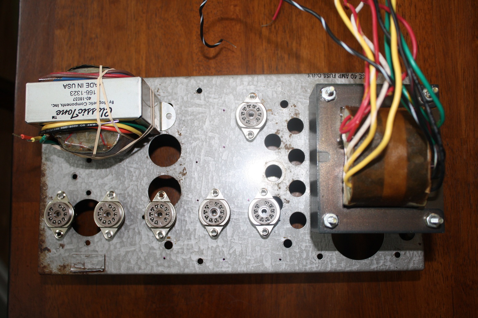

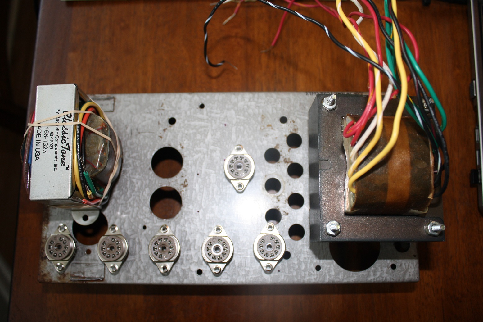

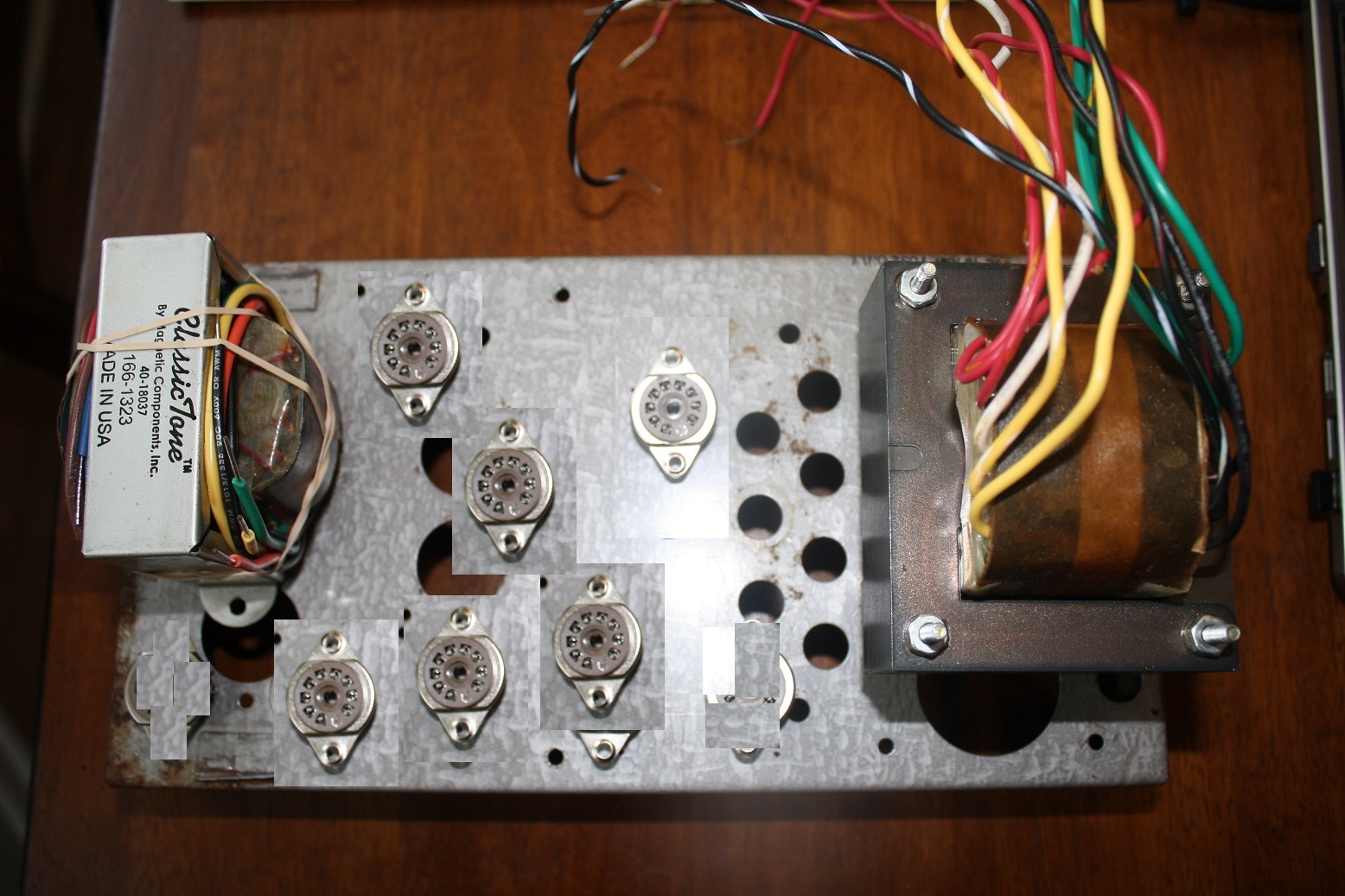

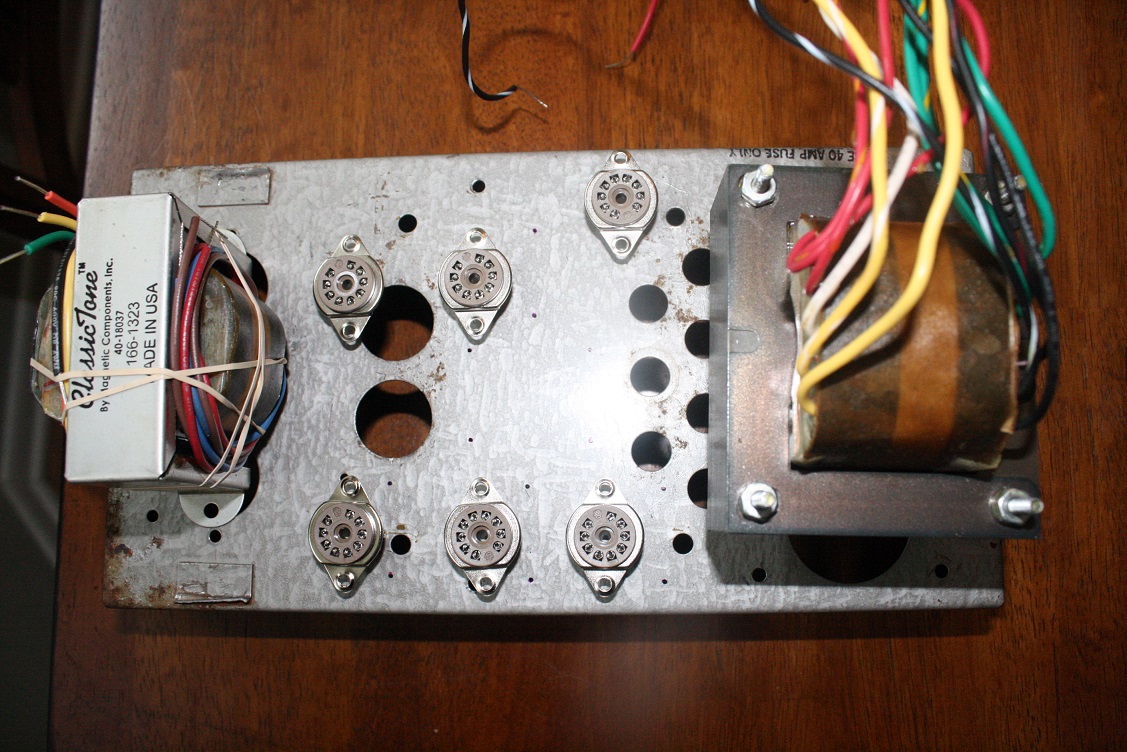

Thanks for the thoughts, all. Rather than try and work up a scale drawing, I snapped a few photos with the components -generally- in place. I still need to plug the holes in the chassis. I think layout 3 seems best... plenty of room for the input jacks, tubes spaced relatively evenly, and enough room leftover to house the filter caps up top if it comes to that.

Assuming the 3 preamp tubes are across the front, I would take #3 but put the 2 output tubes along the back, so that more of their heat can radiate out.
Interesting that this cabinet has some ventilation from underneath, so at least the componenets inside the chassis don't get cooked inside such a sealed oven.
