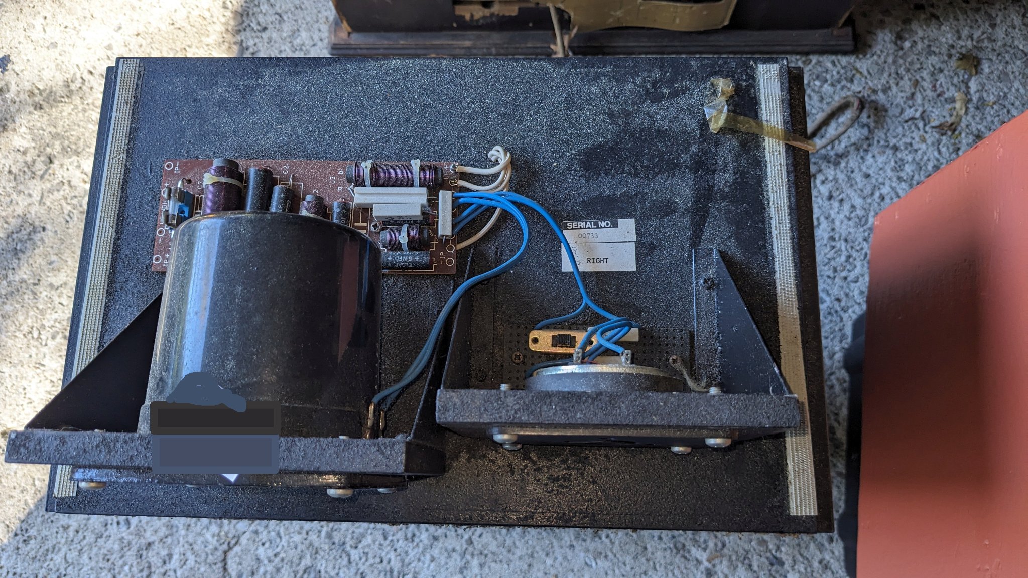

Kef B139 based 3 way that needs fixing

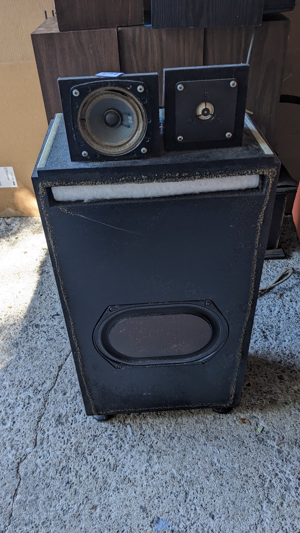

Another one dead? The K040 was used in many retail and diy speakers in the 70s.
Lookls like DIY, but the serial number sort of belioes that.
A Fried R style resistive vent encosures.
You are likely not going to find those Peerless. Most are dead of surround rot.
I would lose everything but the woofer and add a nice 3 or 4” full range and make a WAW (Woofer Assisted Wideband). Easier to do if you biamp,
Whatever you do you will have to rework the XO.
dave

Replacing the mid range will require to build an enclosure. Would then bring tweeter on axis. But redoing the crossover is always trial and error. I will first try to find someone to rebuild the Peerless or find 2 of the Peerless in 8 ohm (refoamed found on ebay but 4 ohm).
