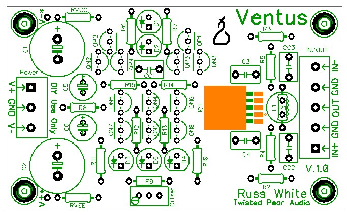

Ventus is a mostly discrete opamp. 🙂
This is a circuit designed for some DIY fun. It is based on the Diamante circuit I published a while back.
The front end is a folded cascode design and runs into a LME49600 buffer. The buffer is in the feedback loop.
A schematic is worth a thousand words.
It sounds excellent. It can drive low impedance headphones exceptionally well.
As shown it is a BAL/SE converter and take balanced input from DACs such as Buffalo or Opus.
I would suggest when using it in this way (Balanced to SE) you use a relay to shunt output to GND on turn off to prevent any turn off thump. The thump buster works well in this role.
The Ventus can also easily be setup as a classic non-inverting amplifier with single ended input. It also can be setup as an in inverting amplifier with single ended input.
Each module is a mono channel so It takes two for stereo, and they stack easily.
There is a pot to null output offset.
We have boards tested and parts are en route so these will be available very soon.
The board is tested and proven, and I love it. I have been listening to it for a week now.
Take a look.
Cheers!

Russ; couple of dumb questions about Ventus.
You said that it could be connected from a single ended source---would that involve hooking the signal side to the (+) in and the ground to the (-) in? Also what power supply did you use or recommend? I was thinking placid.
Pete
Pete
Yes.
We were thinking PlacidBP as well, though LCBPS would work fine.
A couple of points I need to put in the manual (which I will try to get up soon).
1) Make sure you use the closest together pads for RVCC and RVEE unless you plan on reversing polarity of the LEDs and C5/C6 as well as swapping NPN/PNP transistors. I figured some people may want to experiemnt by using PNP input pairs etc. So I made the board support that option.
2) For non-inverting use: Reduce R2 to 221R and make R4 47K (this will set the input impedance). Connect -IN to GND. Then adjust R5 and R3 set the gain. Gain = 1+(R5/R3). For unity gain simply omit R3. For example. Using R5 of 1K and R3 of 1K would get you a voltage gain of 2, which is 6db.
3) For inverting use: Omit R2 and optionally decrease R4 (A range from 0R(jumper) to 1K should work fine). Then wire your input to -IN and GND. The gain is R5/R3. So using 1K for each R3 and R5 would get you unity gain inverted(-1). Remember that R3 will now set the input impedance of the cct. In this example 1K.
I hope that helps.
Cheers!
Russ
I hope that helps.
Cheers!
Russ

Opinion on "active gnd"
Since this is a single channel implementation, what is the opinion on using a third module for active gnd? (like some high end designs over at head-fi)
what is the voltage and current supply requirement for each module?
Supply voltage range is +-12 to 18V (15V recommended). I have to dig out my notes for the current draw.
