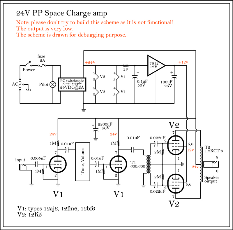

scheme
Here's the schematics of the damn thing.
The preamp tubes are wide variety of 7-pin triodes, s.a. 12AJ6, 12FM6, 12BF6, 12AT6 etc. They all work similar, with little differences in gain and frequency response.

You're correct as always, the tubes I'm using are 12AJ6 for preamp and 12K5 for output.

Looking at your schematic there seems to be something very wrong.
Grid #2 should be biased around -2V which isn't happening here.
You either need a fixed negative voltage supplied to the secondary center of the interstage transformer, AC decoupled to ground.
Or you need a suitable common cathode-resistor to raise the cathodes to around +2V, connecting the xfmr center-tap directly to ground.
In both cases DC-couple the interstage transformer to the grids, no coupling cap's.
Also the para-feed driver is maybe not such a good idea.
A 10nF coupling cap along with the 1Mohm plate resistor form a very high impedance not suitable for driving the low-z primary of the transformer.
