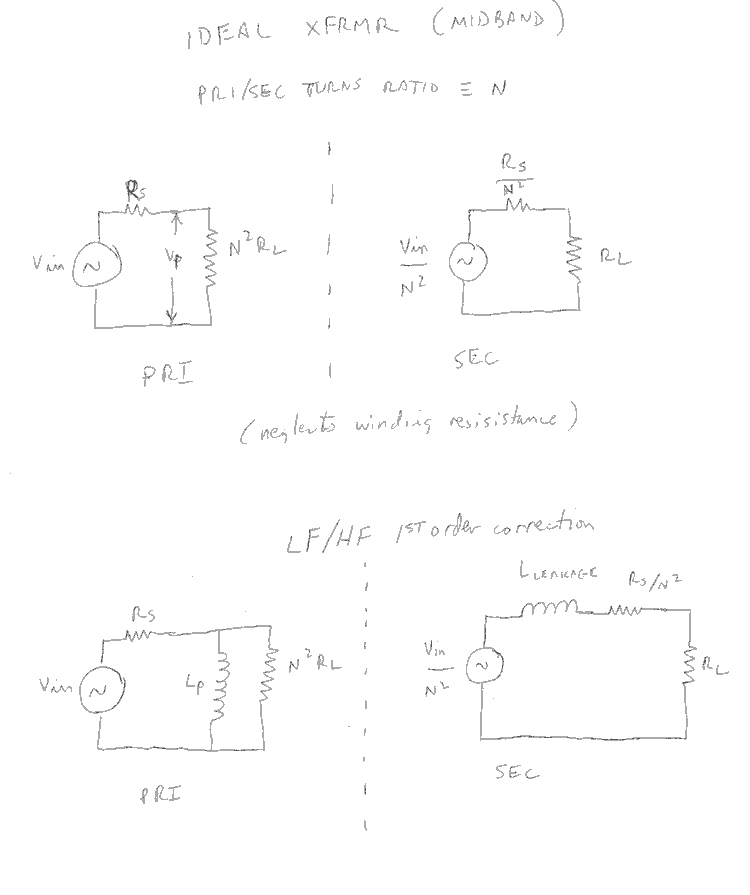

It might be helpful if I draw out some equivalent circuits for midband, low freq and high freq. Give me a little while to scan, convert, and take care of putting my kid to bed and I'll try to make the mysteries clearer.
Here's a quick sketch of some equivalent circuits, very simplified (if you really want to understand this more rigorously and in more depth, the Radiotron Designer's Handbook is the place to go).
The top sketch shows the midband model, idealized. The source is a voltage source in series with its output impedance, Vin and Rs. The load is assumed to be a pure resistance, too, RL. The impedances (in this case, pure resistances) are transformed ny the square of the turns ratio.
The bottom sketch introduces the first level of non-ideality. The source and load impedances are still assumed to be pure resistances, but there are a couple of new twists. The first new twist is the finite inductance of the primary. In a practical transformer, the inductive impedance at midband and high frequencies is very large compared to N2RL so can be neglected. As we go down in frequency, the source starts to be loaded by the inductive impedance, which shunts more and more of the source current as the frequency goes down. By the time you reach DC, the voltage across the primary (idealized again!) is zero- the transformer doesn't transform DC.
The other new twist is the leakage inductance, represented by Lleakage in series with the load. At midband and low frequencies, its inductive impedance is negligible. As we go higher in frequency, we start to see its effect; its impedance gets larger with frequency and, acting as a voltage divider in series with the load, it starts dropping more and more voltage. At the extremes of high frequency, effectively all the output voltage is across it, so the load's share drops to zero.
Now, to complicate things more, there are various capacitances that need to be added to that model to show different forms of peaking and rolloffs (as shown in the simplified model, the HF rolloff is first order, whereas in a real transformer, it's third order). The goal of the transformer designer is, knowing the nature of the source and load impedances, balance off the winding geometry, core, number of turns, and wire resistances to get a flat response over the desired range. Deviate from the recommended source and load impedances and you'll see a non-flat response compared to running the transformer with optimized loads.
Does this make it any clearer?

This is not so for a.c., but how is this impedance calculated?
The impedence X = (2pi)fL (where f is the frequency in question and L is the inductance in Henries). A good rule of thumb is that the impedence at 50 hz should be about two to three times the plate resistance of the driving tube or about 7 to 10 Henries of inductance per 1000 ohms of plate resistance.
