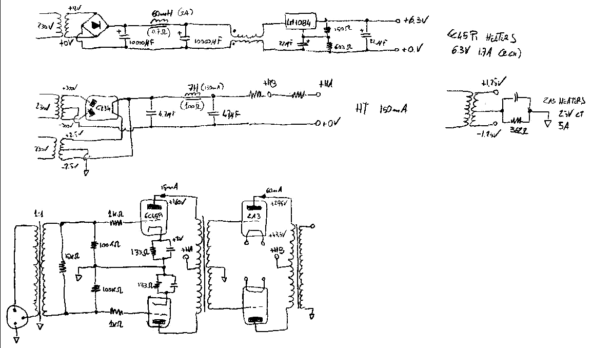

Ciao belli,
I am messing about with this PP idea. Any suggestion for the interstage trans?
Gianluca

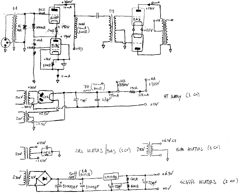

Gluca said:
@ Brett
something like this ???

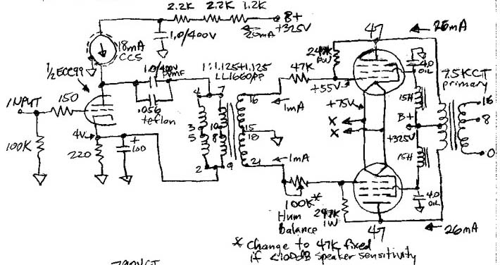

No. Use the CCS as an anode load, cap couple the IT between the 6C45 plate and ground (or return it to the cathode). I have no way of drawing a cct for you, so here's Kurt Strains's 47PP prototype. Some of the component values were changed later, so just use it to see the topology.

A single ended stage will only work with the CCS on the plate. If you place a CCS on the cathode of a single ended stage it will force the plate current to be constant regardless of how much signal you drive into the grid. No change in current equals no gain.
The schematic above of Kurts variation of the 47P-P is the correct way to use a CCS in a single ended parafeed setup.
