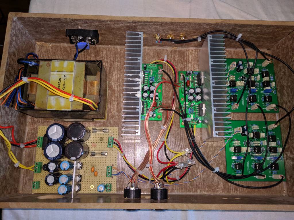

How is internal wiring done when there's no common ground chassis, to avoid ground loops and interference, and when there are multiple boards that have to be connected between them and between their inputs/outputs and external connectors.
I'm mainly concerned about line level signal wires that are most likely to pick up noise. Should I use shielded wires, or are there any specific techniques?

Right, so I did all the line level connections using shielded wire and I still get noise.
The amp is made of two crossover boards and two amplifier boards (one for each channel).
The amps are dead silent (with the input disconnected), so the noise comes from the crossovers (both), even with their inputs disconnected.
I'll poke around with the scope to see where it picks up the noise.

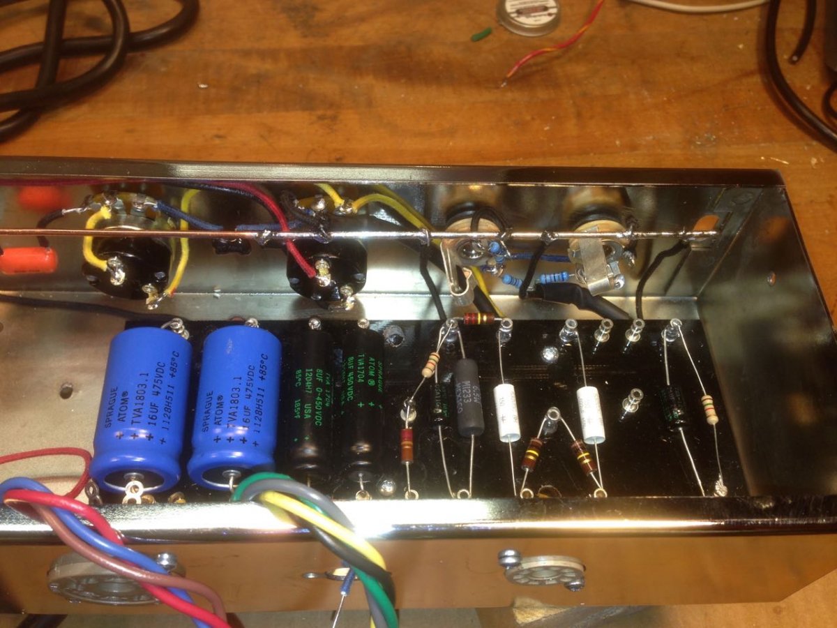

Old style answer (which I used a lot on prototypes and is still popular on Guitar Tube amps) was to use a "bus bar", a thick copper wire, (say, 1 to 1.2 mm diameter) and naked, preferably tinned, wich goes where needed to provide a ground reference, and to which ground returns are soldered.
If you are somewhat careful it may work very well.

Problem is that "ground" is not "GROUND", meaning points you ground to are not perfect or "clean" by any means, even if a meter reads a dead short between 2 points, resistance and inductance is not zero and sometimes ground can be quite dirty, meaning there is some AC signal where in theory there shoud be none, and grounding there injects hum/noise into a previously clean input.
Typical example and a very common one: suppose you ground main filter caps to a chassis point (or track or wire) and power transformer center tap or ground return wire to another chassis point, a couple inches away.
Resistance between both chassis points may be 0.01 ohm (1 hundredth of an ohm) but transformer may be passing 10A peak current pulses, 100/120 times a second, to charge filter caps.
Such current is not sinusoidal but made up of narrow peaks.
You will develop 10A*0.01 ohm= 100mV peaks 😱 and if you ground your input there, you end up injecting 100mV peak buzz into your signal 😡
Not an extreme example by far, it happens all the time and *some* of that is most probably happening to you.
You must be careful with ground returns, where you ground low signal level stages (which are the most sensitive), often grounding "here" is buzzy/noisy Hell and "there" (1 inch away) is silence Heaven.
Any high current path is suspect, same with speaker return grounding.
"In principle" best ground is at main filter caps ... but you have to reach there first, and path is very important.
It´s "almost" a Black Art ... or to be more precise, "practice makes perfect" ... my first amps all buzzed, oscillated, hummed, the works , even using extreme measures such as shielding filament wires.
Today? ... I often use desk lamp grade zip cord and get away with it 😛

That kind of buzz you get when you touch an audio jack with your finger.
I'll try the bus bar thing, sounds like a good idea.
No change
Edit: by no change I mean that the noise is still there, but the speaker with no power on the crossover is silent.
Since the amps are silent with inputs disconnected, it sounds like a loop between the amps and the crossover board, try connecting just one amp to the board, ie, disconnect the other three inputs leaving one
Ah, that sounds like the loop is through the power 0V. Is it commoned between the crossovers and amp?Edit: by no change I mean that the noise is still there, but the speaker with no power on the crossover is silent.
The center tap is common for both the high voltage rails and the low voltage rails (that's how the transformer is built).
I only left a crossover board with only one output connected and ran a thick wire directly to the center tap of the transformer. The buzzing goes away, but there's some faint mains hum.
I'd be tempted to try a separate supply for the crossover, even a couple of 9V batteries rigged up temporally. Was there no change before you ran the thick wire?
It's definitely ground loop.
1. Separate (independent) supply wil help, of cause.
2. Or disconnect one ground (power ground) from crosover board (boards).
Can I actually leave the power ground unconnected?
