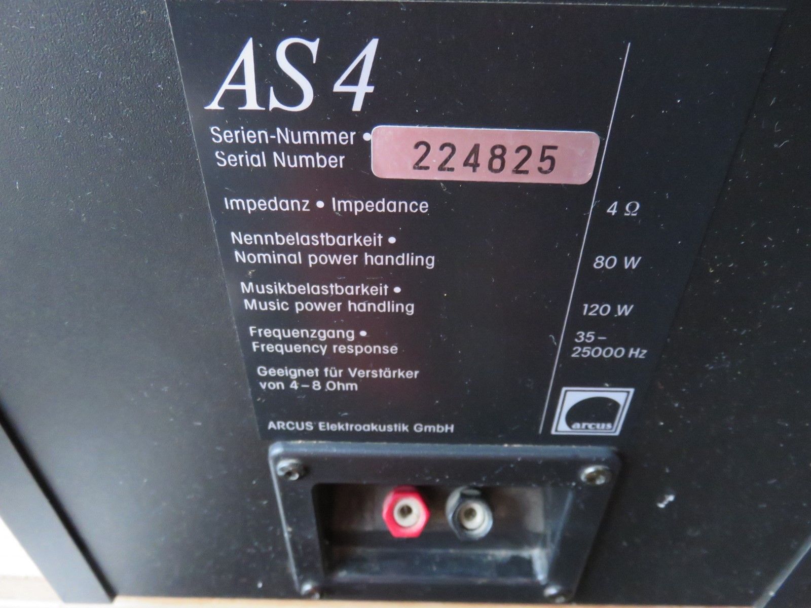

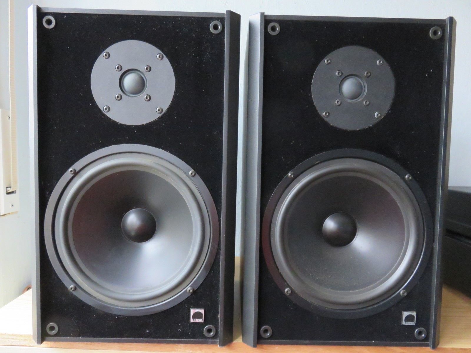

I bought 2 used pairs of 2-way standmount speakers these are made from now discontinued German manufacturer ARCUS (AS 4 model).
I'm going to make new cabinets as the original ones were partially damaged (one pair was damaged from the original owner, the other has some corner damage during shipping). The drivers are 1" SEAS soft dome tweeter and 8" Vifa polypropylene woofer. The design is bass-reflex with a 69mm tapered to 60mm diameter, 192mm long plastic port at the back. Internal dimensions are 38.6 x 21.1 x 21 cm (HxWxD) so internal volume is 17.1lt (16.46lt without port volume)
They sound good and neutral, only a bit bass heavy, I would say the bass sometimes covers the other frequencies with it's power.

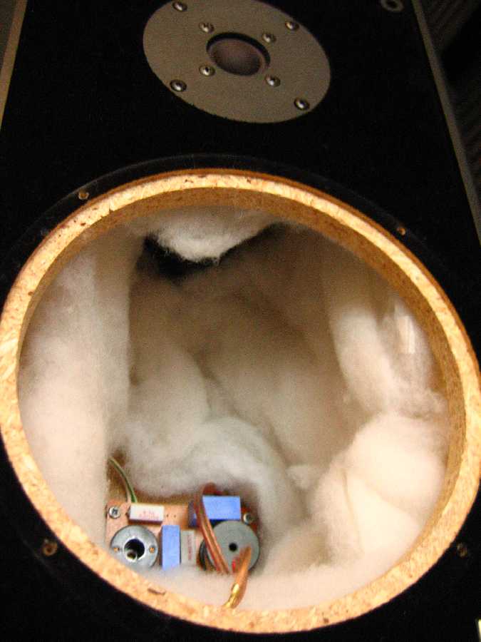

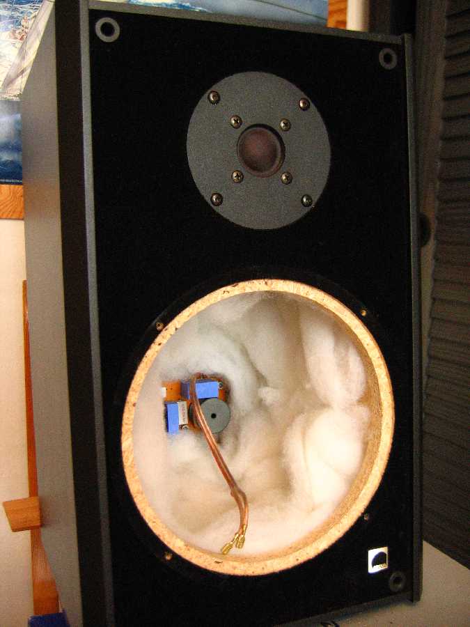

The original cabinets are made of particle board, 19mm baffle, 15mm top, bottom and back and 25mm sides. It is filled with some polyester wool (not the port tube)

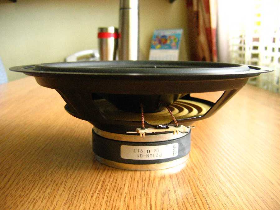

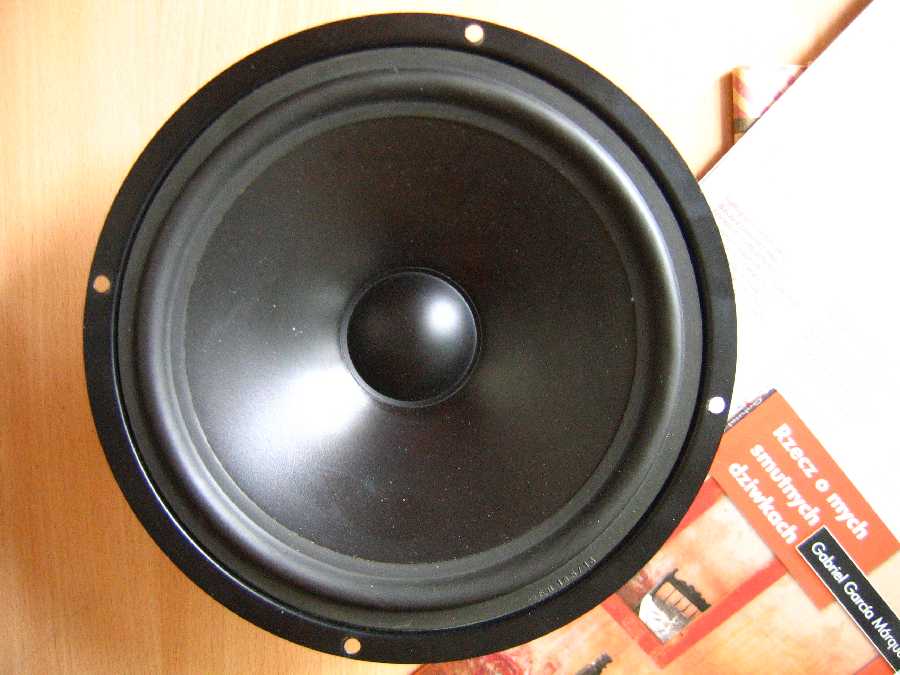

The tweeter is the SEAS 25TFF (H457) 6ohm and the woofer has a label on it writing: P20WN-01 04ohm 202 (but it's a VIFA)

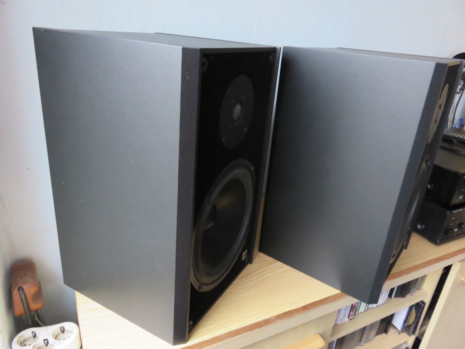

Pictures (not mine)

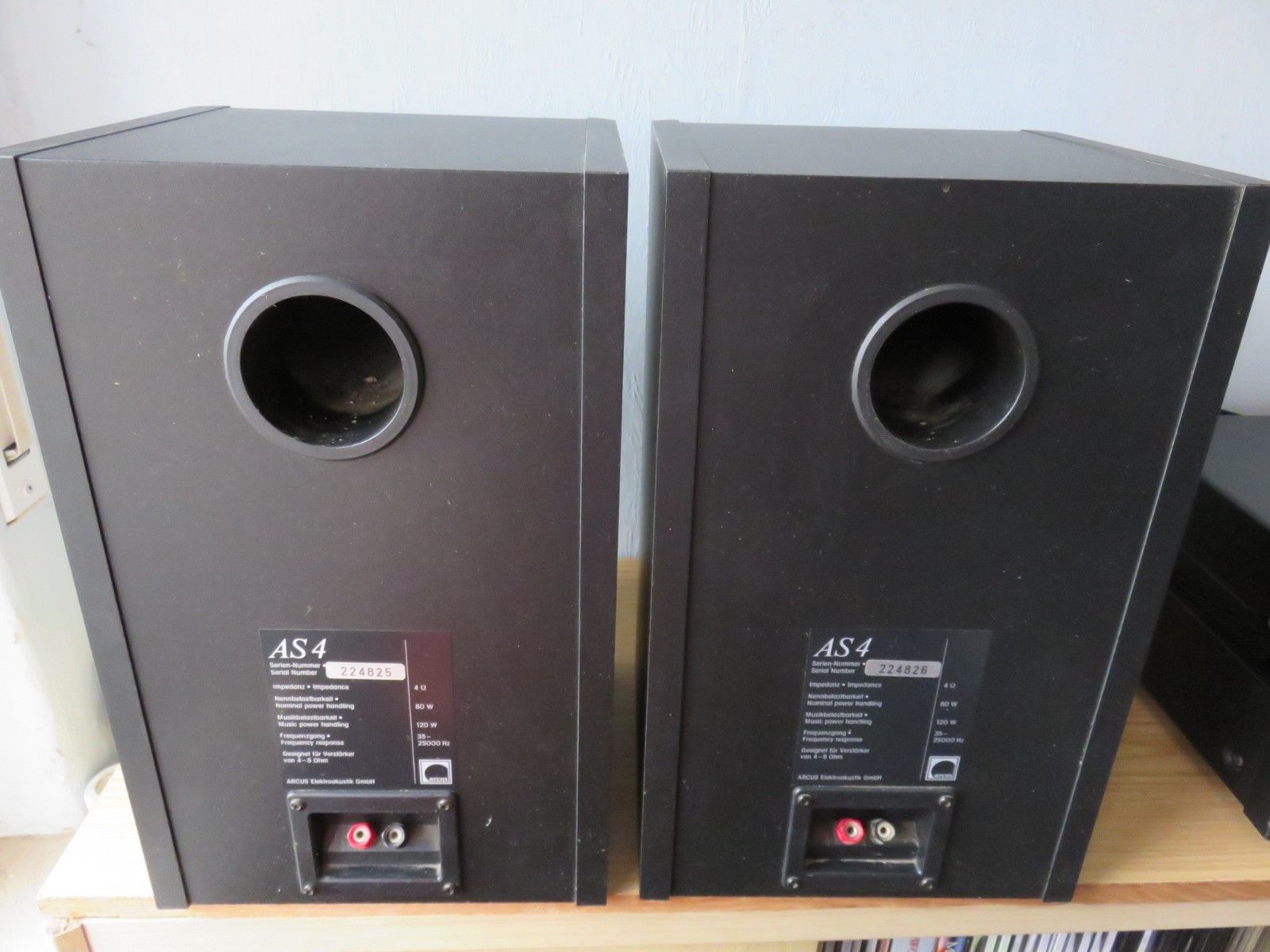

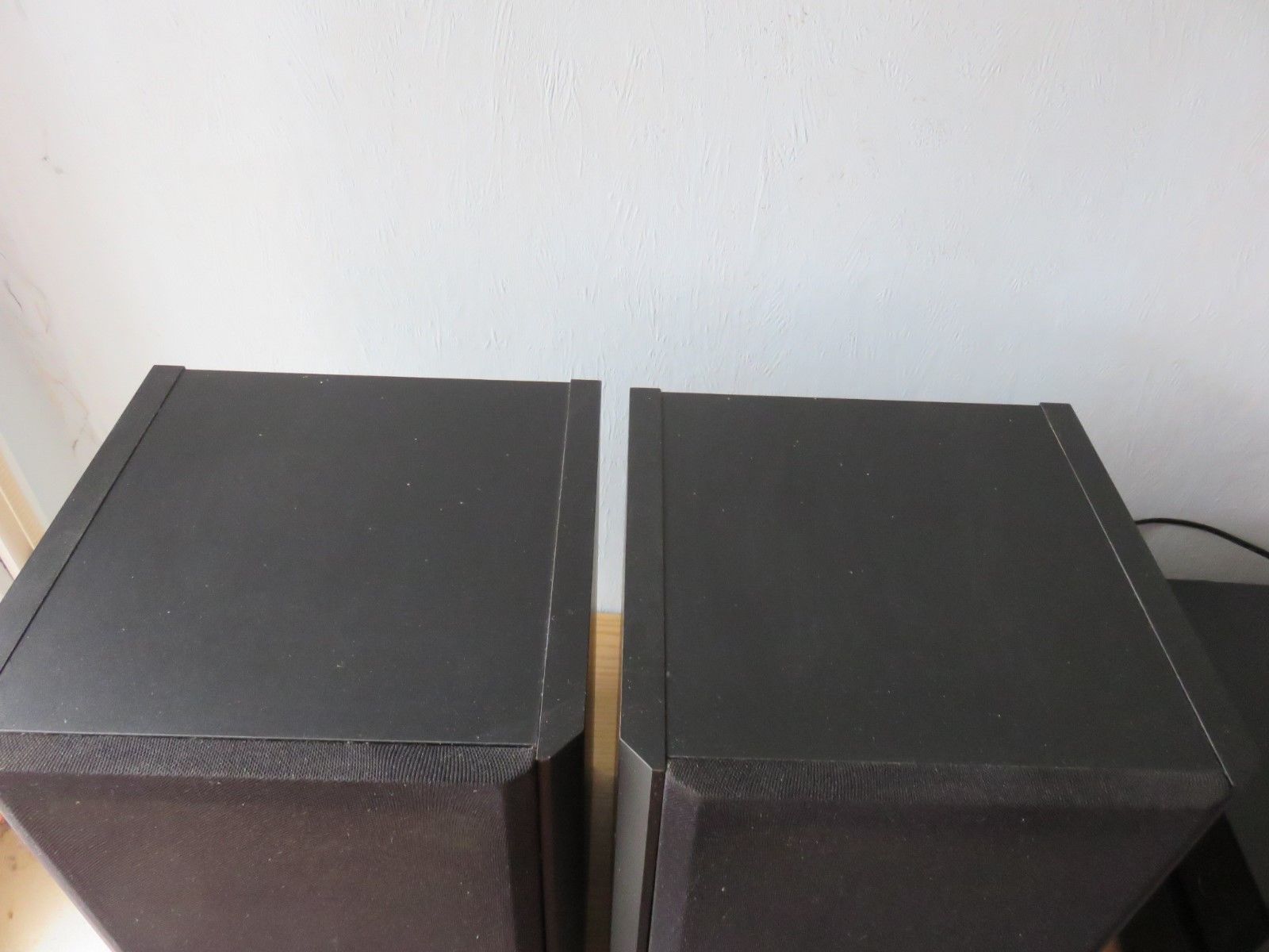

A few pictures I just found of the ARCUS AS 4 speaker.
Obviously it's a cheap speaker but plays fine.

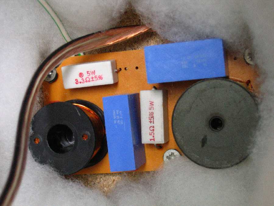

IIRC that tweeter was used In the old Proac Studio 100. Also has film caps In the crossover and a Vifa woofer, so not bad for budget speaker.
I did quick google search but couldn't find the theile/small parameters for the woofer. Maybe an email to Vifa would be worth a try?
If no joy there, I'd build a bigger box than you think you'd need but with a removable back panel and experiment with different box volumes and port lengths (maybe put something In the box to temporarily take up space). Just model any old woofer In winISD and use that to give you an Idea of what will happen with different enclosure volumes and port lengths.
In an Ideal world you'd have the port as short as possible to reduce port resonances but try not to reduce the diameter of the port or you will risk port chuff.
Yes, the silk dome 25TFF was used in the Studio 100. It is very transparent ("silky treble")without any harshness. A few years ago when I bought the speakers I tried too to find any info of the Vifa woofer without luck. I guess it was custom made by Vifa for Arcus.

It could be that the vifa woofer is a standard unit that had It's name changed. Hard to tell without measuring t/s.

The crossover will be designed for the front baffle dimensions, so In an ideal world you'd keep those the same and extend the back. Most Important Is to keep the baffle width the same and the driver positions the same. Extending the length of the baffle (below the woofer) might not make much difference but I wouldn't want to bet on It. Jeff bagbys Diffraction and boundary simulator may help you here or The Edge.
Baltic birch would be fine. Make sure you brace them well, especially either side of the woofer. You don't want the cabinet walls moving In and out when the woofer Is.

STOP! Do not make a new cabinet! Old one is good enough. But, if there is too much bass, than stuff the bottom half (or two thirds) of the enclosure with some stuffing material like glass wool or polyester wadding. If that is not enough, put some of the material in the vent.I will make new baffle with the same internal dimensions.
20 or 25mm thickness all around except back panel
Stuffing the vent is a bad idea. You could try adding more stuffing to the box but it already looks pretty well stuffed. Always keep stuffing well away from the port.
IF there is too much bass than stuffing the vent IS a good idea, actually.
Manufacturer stuffed the box well for a reason, but maybe it is not enough.

The original particle board panels are not firmly glued together. It was easy with a hammer to take them apart without breaking them. Cabinet looks solid but isn't that much after all.
