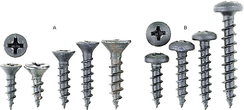

Are there any particular screws made for mdf or is it a non-issue?

Firstly, MDF screws... Yes! Unless you are the luckiest bastard in the world, using normal wood screws will end you up with a lot of "split" (delaminated?) MDF. You should always you a screw that has a non-tapered shank and big threads. (take a look at a deck screw)

I used these screws for MDF and they worked great:

Pre-drill your screw holes.

Never, ever, ever even LOOK at MDF without pre-drilling!!! (especially on "end-grain" butt joints) I can't believe I forgot to mention it...roddyama said:Pre-drill your screw holes.
