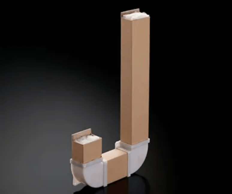

FIY, Yamaha NS-5000 use them (no detailed info, only marketing):
Newly Developed Acoustic Absorber Eliminates Sound-absorbing Material to Revive the Original Presence of the Music​
The cuboid enclosure unifies internal standing waves at a specified frequency, which are cancelled by a newly developed resonance tube (patent pending). This technology eliminates the previous need for the huge amount of sound-absorbing material inside the enclosure. The result is the virtual elimination of standing waves with amazing efficiency and pin-point accuracy—to energetically revive the essential presence of music, formerly lost by sound absorption.
https://europe.yamaha.com/en/products/audio_visual/speaker_systems/ns-5000/features.html
And smaller ones for drivers:

And Patrick Bateman has documented his experiments with meta material on this site.
But there have been numerous DIY designs with internal HH absorbers (they are popular in Germany...). I guess they can come in handy when internal dimensions urge you to do something about standing waves. But applying other means is probably just as useful.

In a simulation internal Helmholtz resonators are a simple way to kill specific resonances and afaik the way Mr Helmholtz initially designed the box with a hole in it wasn't for boosting more for killing frequencies. In Germany we have mainly two DIY magazines for speaker building and one of those uses internal HH in transmission lines.
I did one of those kits and experimented with and without this volume and couldn't find an acoustical difference. The HH got a very narrow bandwidth and if it isn't on the right place for exactly the right frequency it won't work. I assume that's the case in my experience and I would avoid those magic boxes in a box. They make the building and the design more complex and the effect might work not will work. The biggest flaw of internal structures like these are that you cannot access them for changing the damping material - depending on the design.
