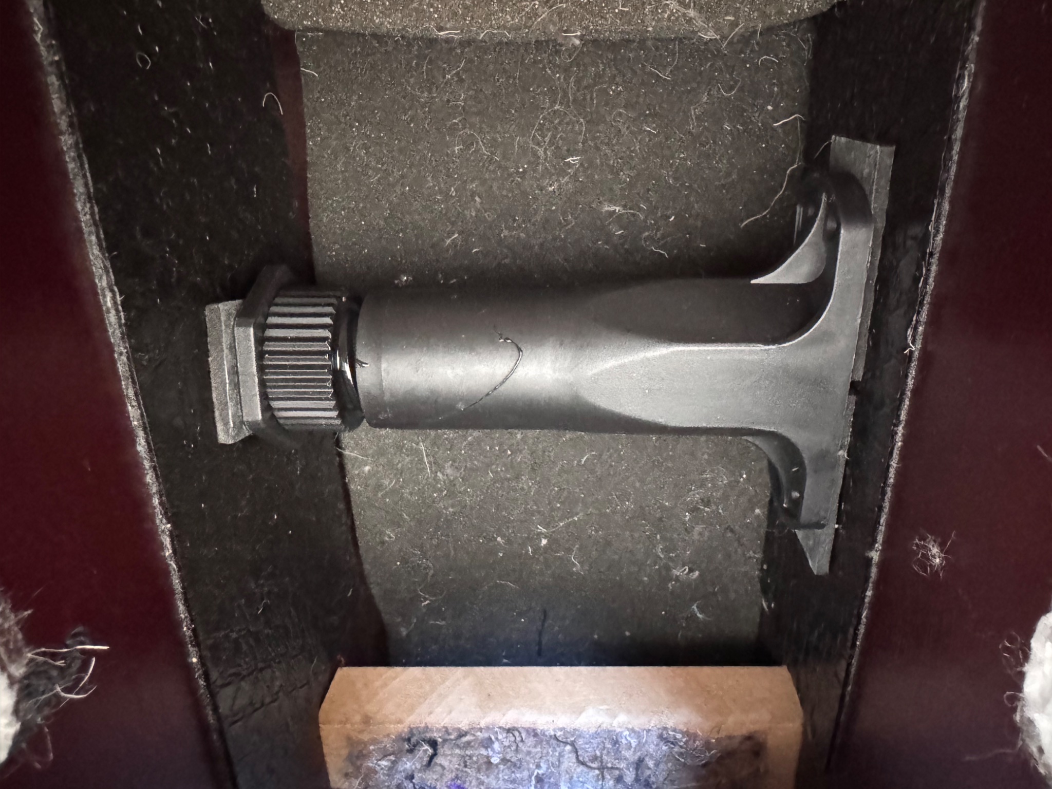

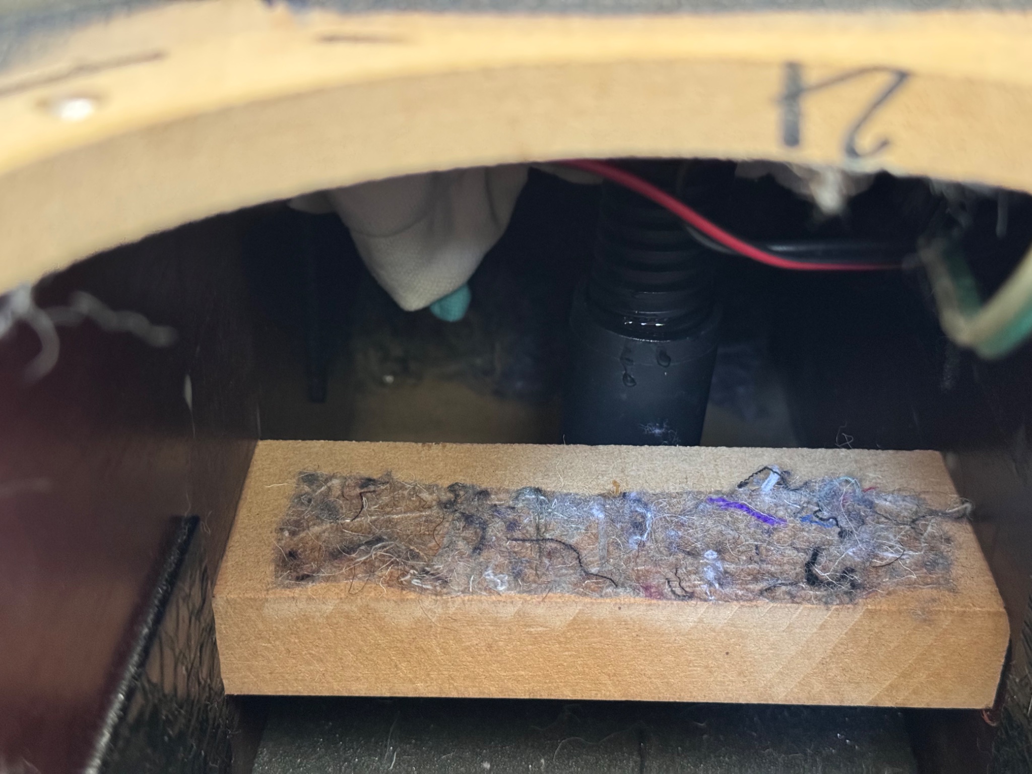

Here is my solution for some additional internal bracing. The only reasonable access I have is through the bass/mid driver and speaker terminal cut outs.
Required;
Furniture extension legs, Super glue, double self adhesive pads
I simply inserted the legs and adjusted them accordingly. Superglued thread afterwards. Rock solid.
I also filled the extension legs with some magic eraser sponges I had. No idea why but it can't do any harm 🙂
