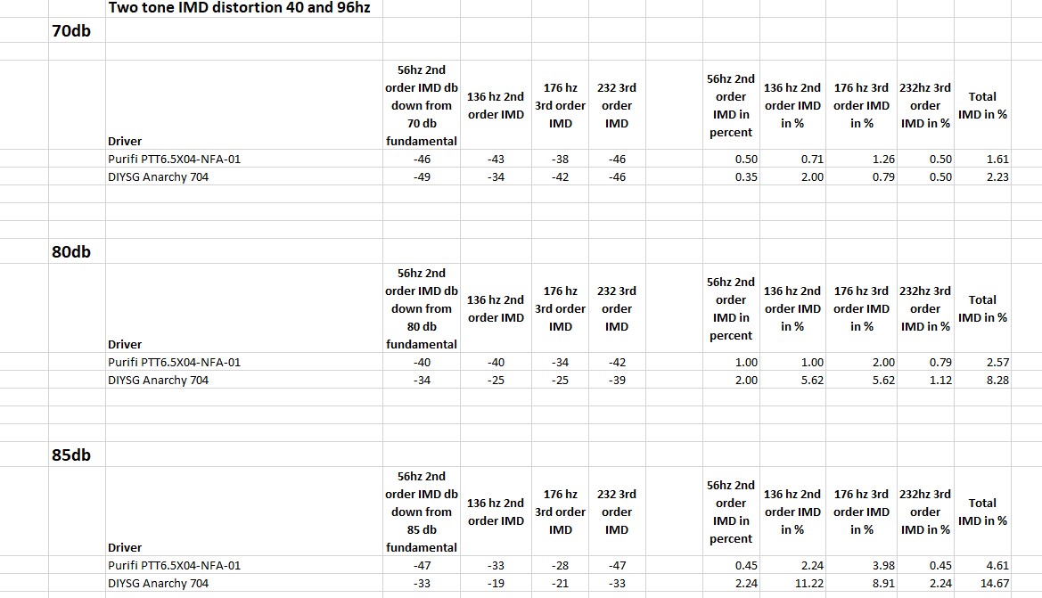

The first two drivers I was able to test are the DIYSG Anarchy and the Purifi PTT6.5X04-NFA-01. As shown in the graphs the Purifi really shines in this IMD test. Yes, the anarchy is less than 1/5 the price and it does well for the money but the Anarchy seems to be affected by a lack of inductance control.
Erin's audio corner has klippel tested the purifi (XBl at 82%, Bl = 9.1mm, and for XC at 75%, Cms minimum was 6.9mm and the anarchy was klippel tested for the voice coil magazine (XBl at 82%, Bl = 8.5mm, and for XC at 75%, Cms minimum was 10mm). So a pretty close klippel result but the purifi outperforms the anarchy in all IMD and harmonic distortion tests I conducted.
For the 40 and 96hz test look for IMD products at 56,136,152,176,232

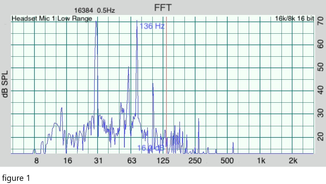

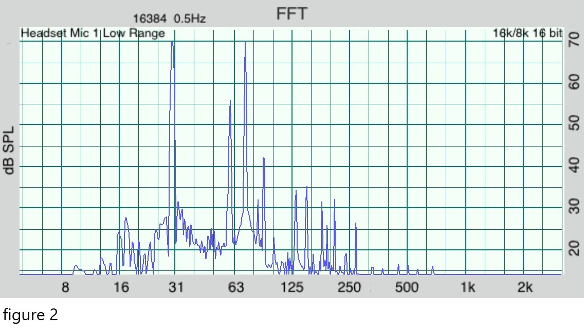

However as drivers improve the difference between horn loaded bass and a direct radiator are getting closer. I have measured 30 and 72hz IMD with a high quality 12" subwoofer with a full copper sleeze to reduce inductance nonlinearity and also with a basic 8" woofer in a 7 foot folded horn that I built from plans.
Attached are the two IMD measurements in room with same location of microphone and speaker. Take a guess which one is the horn and which one is the sealed 12"?

No guesses? It'd have to be the right driver for the horn usually high bl drivers work better. I'm also thinking cone vibration is pretty important with the increased compression of the horn as the eminence lab 12" which was designed for horn use had two dust caps to stiffen up the cone. I think the klipschorn uses a 15".

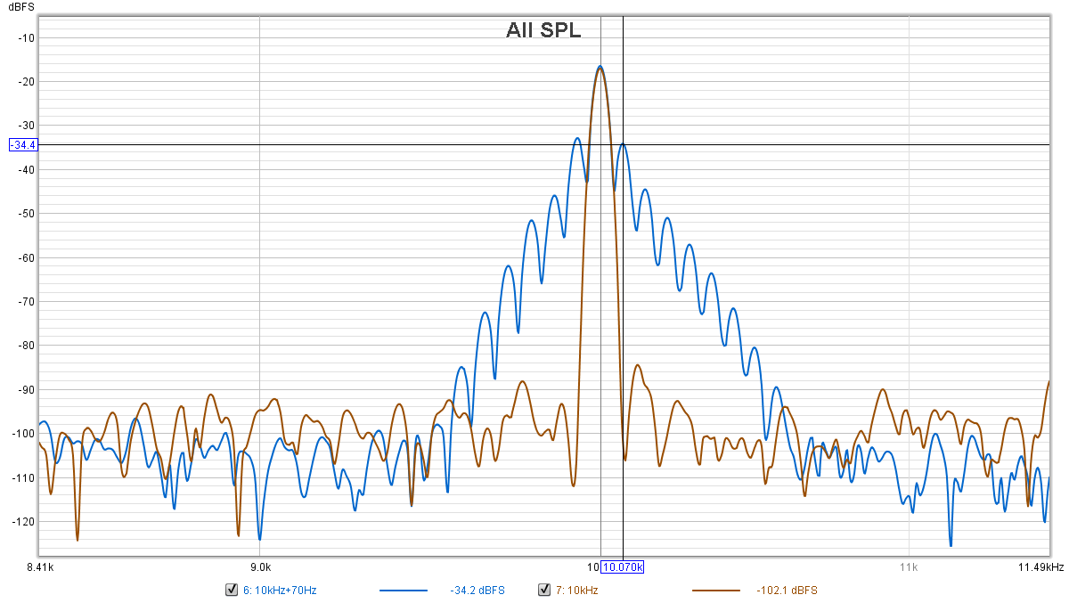

One example how big Doppler distortion can actually be. It is from relatively low sensitive full range, 70 Hz and 10 kHz are with same level.

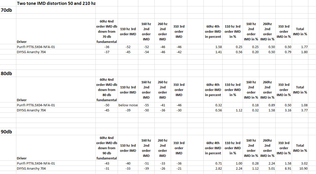

Shrub0,Attached is the IMD percentage chart of the two drivers.
A 6 dB increase in SPL requires a doubling of excursion, a linear ratio.
Bl (magnetic force factor with the voice coil at rest) reduces with excursion in a non-linear ratio.
Klippel analysis of Bl when reduced to 82% at "X" excursion will produce about 10 % intermodulation distortion (IMD).
The Purifi PTT6.5X04-NFA-01 stated "linear Xmax" is 9.8mm, while mechanically rated 14.5mm, due to the Bl being weaker than the mechanical formula (HVC – HG)/2 (Height of Voice Coil- Height of magnetic Gap) for Xmax predicts.
The Anarchy 704 Woofer 12mm Xmax rating is probably a mechanical rating, if its Bl curve and suspension compliance is similar to the Purifi, rated the same way it's "linear Xmax" would drop to 8.1mm.
