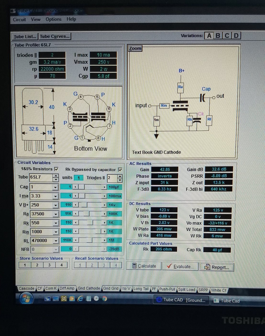

We’ve gone off topic here, but since we have - I ran simulations again for my 2A3 driver circuit (parallel 6SL7). John Broskie's Tube Cad program shows an output Z of 13.5 k, not 22.5k - which is what another poster calculated.
My original measurement notes show my amplifier was only -0.25 dB down at 20 kHz.
Considering my ears are only good to 12 kHz, I think I’m ok. The amp sounds great, regardless...

Hi
Thanks for the screenshot. It tells a lot.
Your 6SL7 output impedance is lower since you use a lower value plate resistor (a single 37.5k ohm from your screenshot).
Since you tie both plates together, and use a single 37.5k ohm resistor, the rough calculated output impedance is 13'865.55 ohms (assuming the cathode is bypassed).
Broskie's Program probably looks up the internal resistance according to the actual bias of the tube. I personally use LT spice for simulations.
This nicely corresponds to a HF roll-off starting around 11.8 kHz. So I do not doubt that you find your amplifier nice to you. I can't quite hear 14 kHz, but my daughter still can. 🙂
Maybe a 1k ohm grid stopper would help, but it is still very odd that you get this sound even with the driver valve/tube removed.
I can't for the life of me think that a resistor with no current can "sound". The Grid bias resistor "RL" or "R load" in your screenshot really 470K Ohm?
This is a high value, but it needs to be due to the "wimpy" 6sl7 driver. Maybe swap it out for another and see if this makes a difference.

My measurements are not inaccurate. I'm a retired electrical engineer. The amp is basically flat to 20 kHz, regardless of mathematical predictions.
I attribute the increased bandwidth to a lower-than specified shunt capacitance in the 2A3, hence less Miller effect. The specified grid capacitance for the 2A3 is likely a maximum value - not an average one - as the max value would be the most critical one for circuit designers.
There is no "load resistor" in the actual circuit...it is just there for simulation purposes. The 2A3 grid never goes positive, so it presents a near infinite load to the driver, so the 470k grid leak resistor becomes the major load - if we IGNORE the effects of grid capacitance and Miller effect, which of course will affect HF bandwidth.
