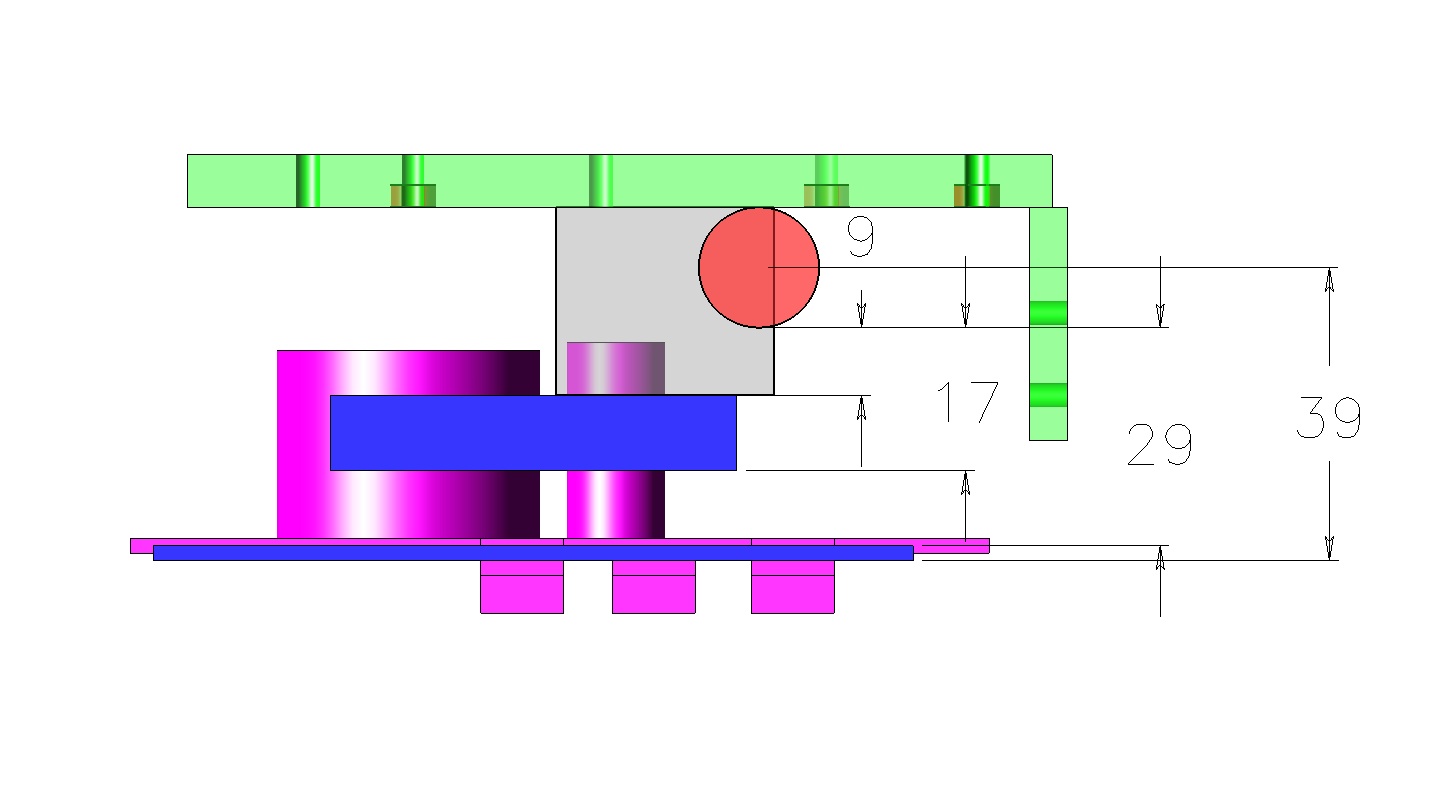

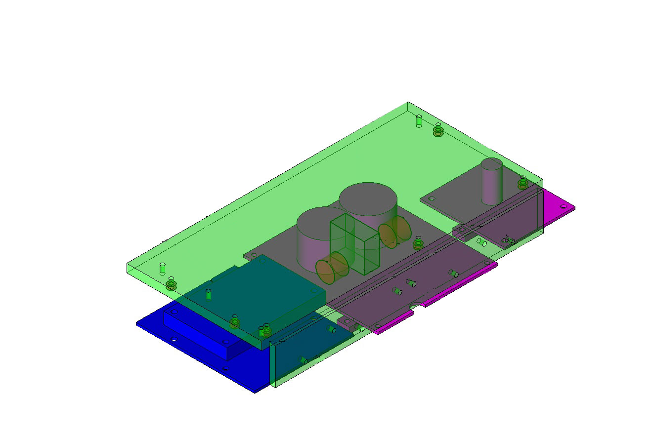

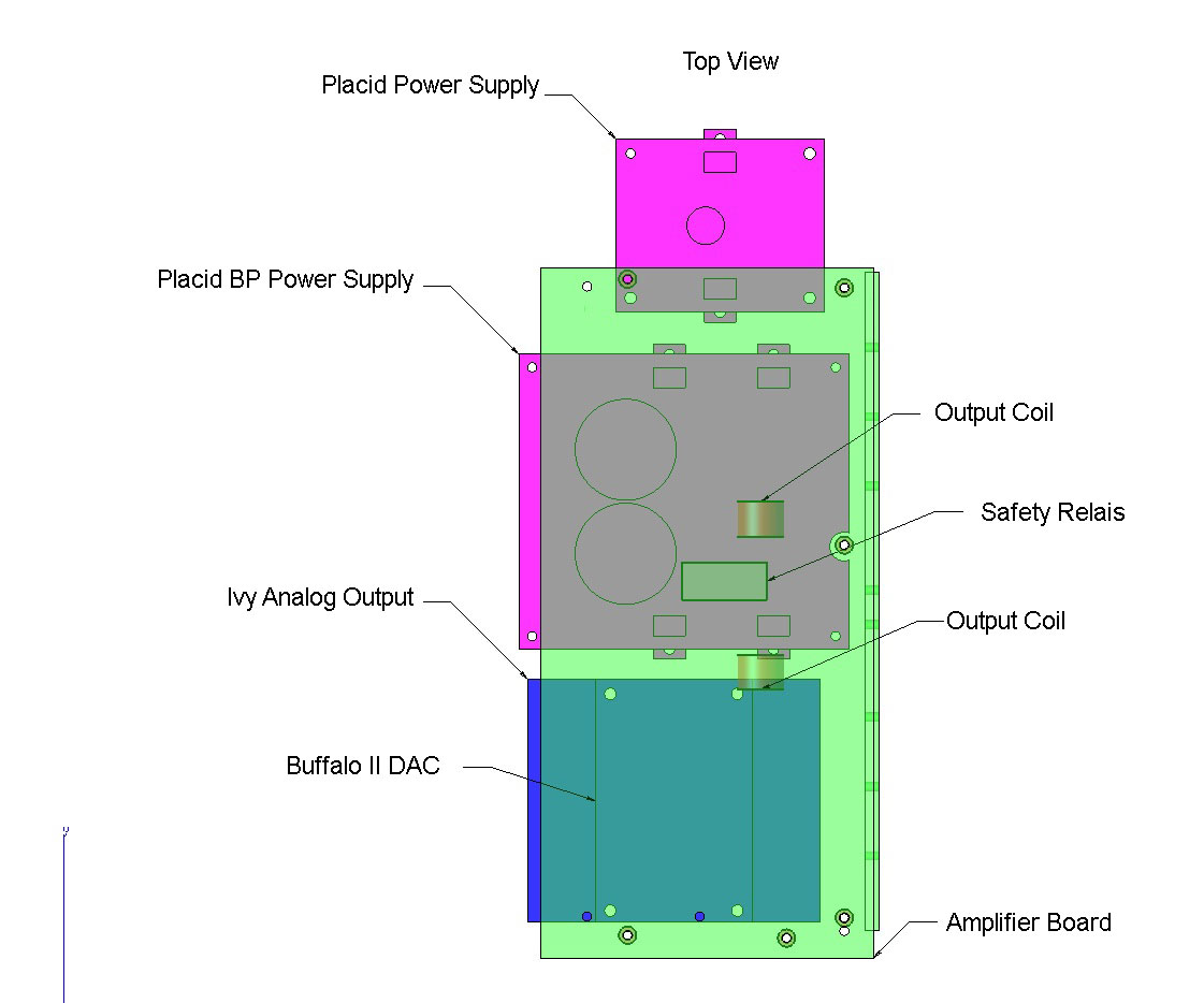

To shed some more light, I attach drawings,
The coils are not over the center of the dac board
but at the upper right corner. The closest part close to the firmware controller,
i would say about 15mm away.
Dac Board in the schematic is blue,
amplifier board is green. The amplifier bord will be mounted upside down,
thus the part on the right side facing down are the output transistors.
Dac is BuffaloII stacked on Ivy.
The Buffalo Board is drawn in 10mm thickness because of mounted parts.
Thus shortest distance of the coil´s surface to the Buffalo´s PCB-surface (actually the closest part is the mounting hole) is 9mm.
All other PCBs are around 29mm away.

The inductor is a magnetic antenna transmission. It induces a very large interference in the form of distortion at the amplifier's inputs. For example, if the amplifier has a distortion at the level of 0.001%, the inductor on the amplifier Board easily raise them up to 0.05%.
Keep the inductor away from sensitive circuits, wound it into the shape of a torus.
