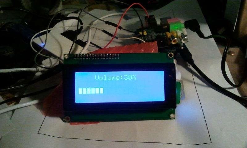

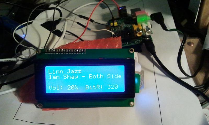

Initially I tested RasPi with various external USB DACs, and was, quite honestly, more than disappointed. Lots of clicks, hiss, etc. - in short, the sound was poor. I tried various proposed solutions for resolving the USB issue, but to no avail. (On the RasPi USB shares the same bus with Ethernet, and this seems to be the cause of all the problems with USB-based sound...)
I actually gave up trying the RasPi for serious audio, and used it as a video player (XBMC) for watching movies.
It all changed when I got a Wolfson audio card (which uses I2C, not USB). At first I tested it with Squezeplug distro, using LMS (Squeezebox server): the sound was excellent, but the interface was rather sluggish.
So, I decided to switch to MPD audio server, and - bingo! - the interface is fast, fluent, no problems whatever - and the sound is great! I'm using the analog audio output (3.5mm jack) which goes directly to TPA3116 audio in via cable like this:
This setup (RasPi + Wolfson) was tested with several high-end audio setups at some friends, and the results were always excellent (we used their own high-end amps, though). My friends' comments are that this sounds great, and easily equals DACs in the $300-$400 price range. The server (MPD server on RasPi, Squeezeplug distro) is quite OK, no stuttering, works excellent with various mobile clients (MPDroid for Android, etc.), and I also added several of my own modified Web clients. I also installed a small web server, which offers several MPD web clients for controlling the playlists etc.
The only initial hurdle was that Wolfson card uses all of the GPIO pins on the RasPi, and I wanted to add an ordinary IR remote control and a LCD screen.
The IR remote was solved by using a cheap ebay USB remote, but the LCD required a lot more work (including some soldering). I used a 20x4 LCD with I2C interface, which does have some support for RasPi (LCD driver), but I had to implement most of the LCD screen fuctionality myself..
In short, RasPi with an I2C DAC works great - and not only just for kitchen or garage. The opinion of most of my audiophile friends is that it can easily be used as quite a serious audio source.
As for myself, I'm quite happy with the TPA3116 amp, and will most likely put the whole shebang (RasPi, Wolfson card, powered USB hub and TPA3116) into a single enclosure...
One note: there are several other (cheaper) I2C DACs for RasPi, like HiFiBerry, which should also work fine, but I can't comment on the sound quality, since I have not tested them.

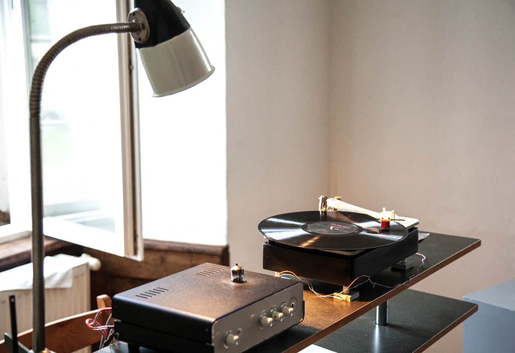

Yes, it is possible to build a very compact all in one system with the raspberry and the TPA. I have built this vor the German Frickelfest, the largest diy audio meeting in Europe:
It includes: Raspberry, Hifiberry Digi, DAC, phono preamp, tube buffer and a TPA.
Morfeus,
Cool project! Please show us photos of the inside. How did fellow diyer's at the festival like the sound? I think tube/3116 hybrids are pretty neat. Is that a DIY turn table?

Unfortunately I did not take photos from the inside and already took it apart, cause that was only a fun project and I needed the Raspberry for my main system.
The others liked it a lot. If you are interested in more photos, have a look here
Frickelfest 2014/hb
and here
Frickelfest 2014
The turntable is an old Braun PC-3 that I totally rebuilt and modify together with a 7" unipivot tonearm that I constructed and built myself:
Sorry for the o.t.
