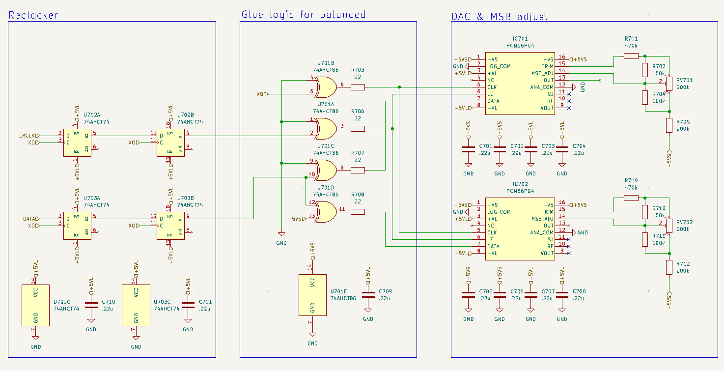

Here's the glue logic I plan on using. Does this look like it'll work? Would anyone do it differently?

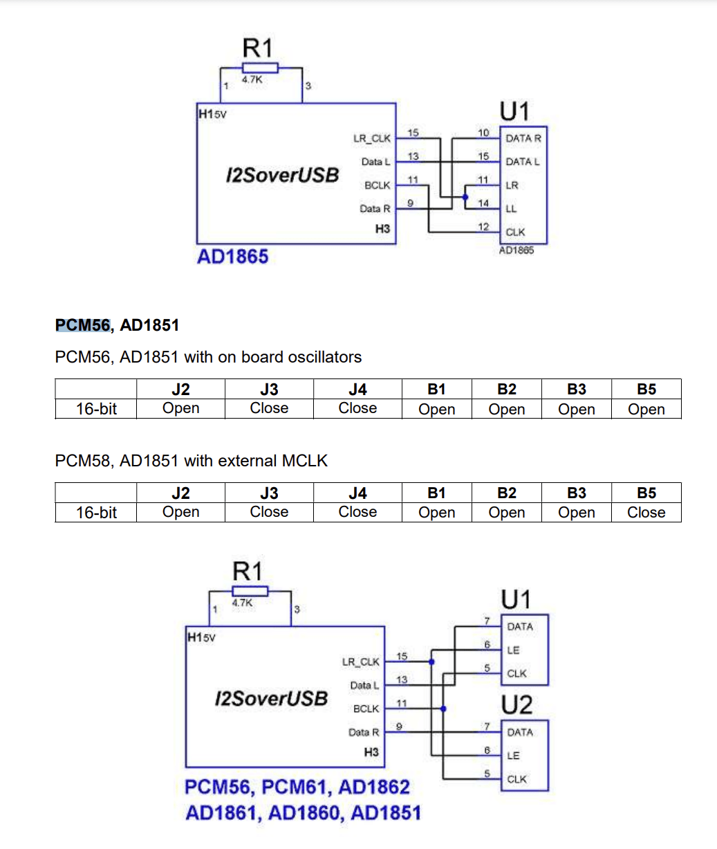

Why use Amanero? I2SoverUSB has built-in support for PCM56 and it costs around the same as a real Amanero.
Image from I2SoverUSB manual.
Sorry for replying sooner!Why use Amanero? I2SoverUSB has built-in support for PCM56 and it costs around the same as a real Amanero.

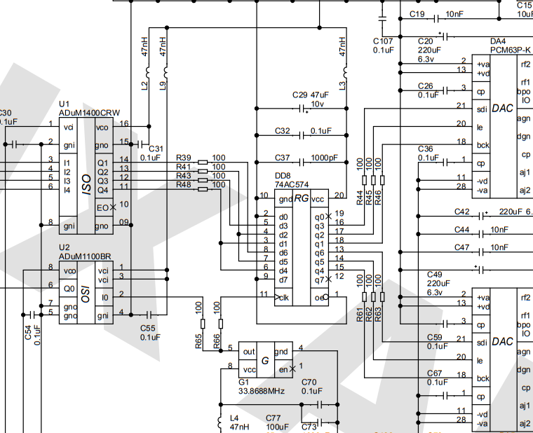

I'm not opposed to switching receivers. Amanero suggests supplying both chips with the same data stream and providing an inverted LE to each chip should do it, using a different firmware. I can't say I know enough about digital to tell if this is a good idea or not.
That said, I think the I2SoverUSB solution only gets me halfway there if I want to made a hardware balanced DAC. IanCanada has an I2S to PCM converter board which natively supports balanced PCM56s. Perhaps this is the right solution, but it strikes me as a complex way of doing something that should be simple, considering that it requires a separate USB to I2S interface.

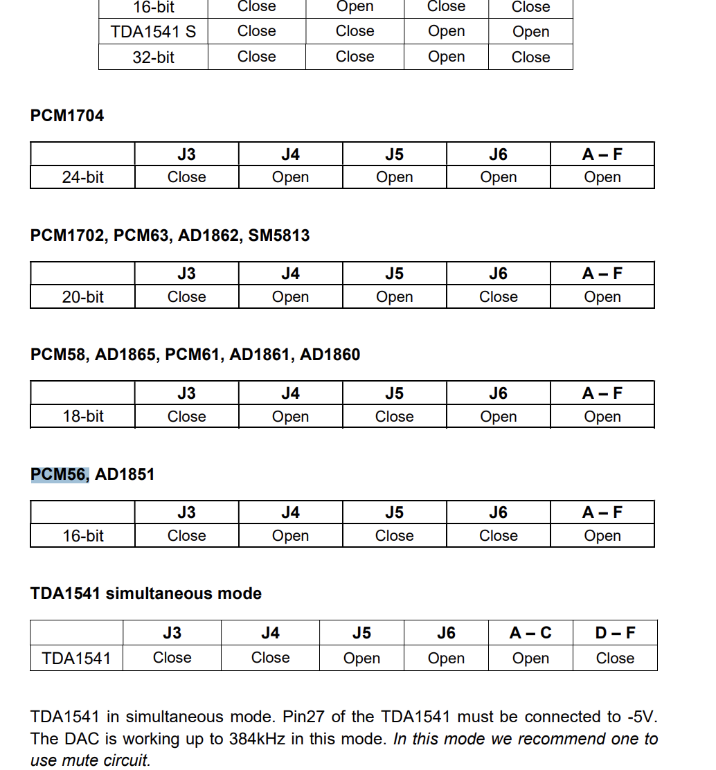

This is an old one, which Ljuben doesn't sell anymore. New one (FIO) doesn't require resistor jumping. Just to say, in case op chooses i2soverusb board.Why use Amanero? I2SoverUSB has built-in support for PCM56 and it costs around the same as a real Amanero.
@PretentiousFood send an email to Ljuben, he will respond to you with the most info you require. In the meantime, study datasheet as markw4 said, it will help you in general in the long run to study datasheets.
I think I got this figured out. It's my first time using any sort of logic circuit, so I was hoping to get some feedback on anything that seems off. 🙂

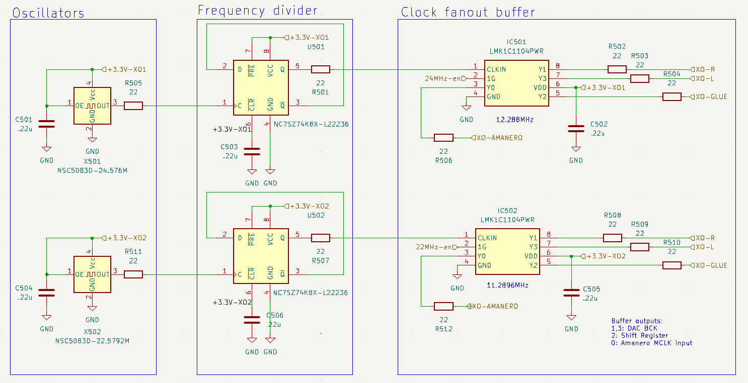

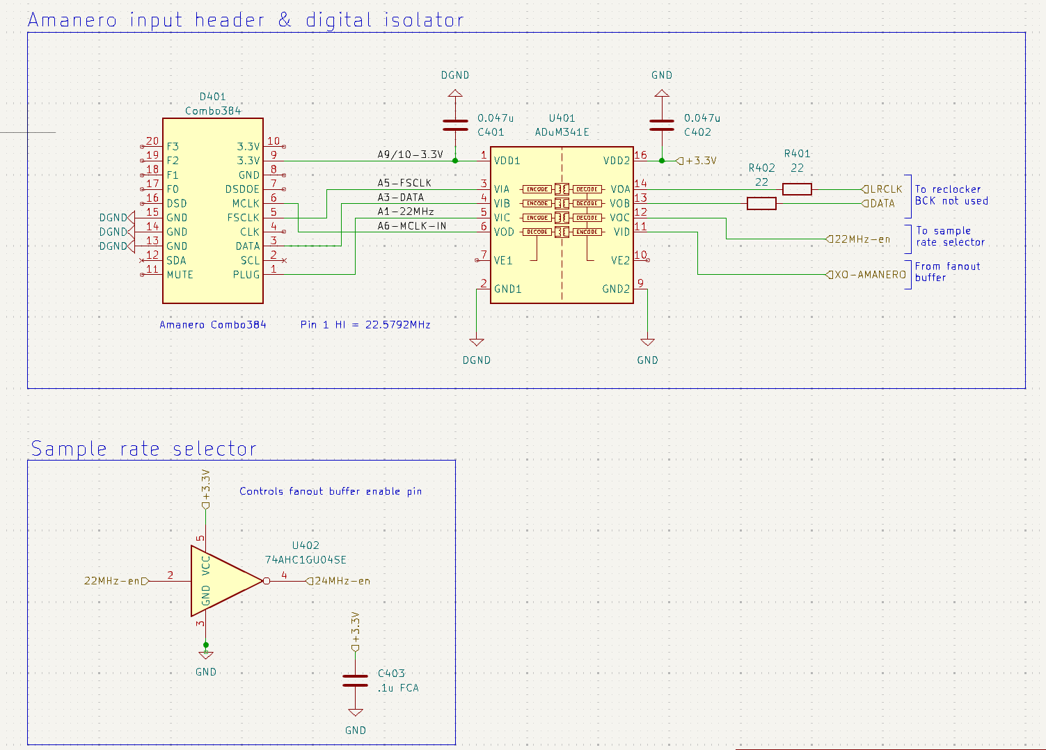

I haven't heard back from Amanero and so plan on using external glue logic to convert the I2S signal to BTC, then the Pass D1 glue logic to create a balanced signal. The Amanero unit will run in slave mode; there is an app note on how to set up the firmware, but I haven't seen any hardware implementations.
The ADuM341E isolator sends the FSCLK, DATA, and sample rate to the DAC board. Local oscillators (11.2896MHz & 12.288MHz) act as BCK and are fed back to the Amanero board.
The two local oscillators are NDK parts. I couldn't source the correct frequency oscillators, so am running them through divide-by-2 logic before feeding them to a fanout buffer. The oscillators will remain always on, and the Amanero board controls the enable pin of the fanout buffers through an inverter.

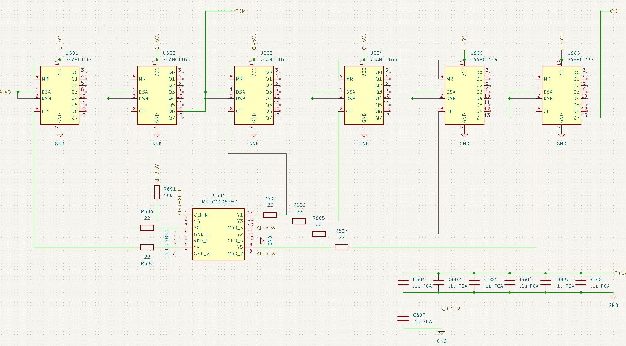

The DATA lines are delayed with a shift register to generate the left and right DATA lines. This is Miro's circuit, augmented with a fanout buffer for clock distribution.
Lastly, this is the schematic for one balanced channel. The LRCLK and DATA lines are both fed through a two-level synchronous reclocker (reference figure 4 of TI app note SCAA042A). This goes to a quad XOR gate to generate the balanced DATA lines and to delay the CLK/LE lines. The optional MSB adjust is implemented. The I/V stage is undecided for now.
Some questions that come to mind--
1. The clock is at a 3.3V logic level, as the good fanout buffers and oscillators are all 3.3V parts, and I assume level translation will do more harm than good. Is this a reasonable hypothesis?
2. I considered eliminating the XOR gates and using the Q-bar output of the reclocker for LE, but I understand there's a 150ps-or-so delay on the Q-bar pin relative to Q. I would expect that to be immaterial here. Would it be beneficial to use the Q-bar output, and eliminate the XOR gate?
3. I used the AHCT logic family throughout as this is as fast as it gets with 5V logic. Should I consider anything else?
Any feedback would be greatly appreciated, I'm sure a trained eye will spot plenty of opportunities to improve the circuit. 🙂

I am aware. This would avoid the 6 shift registers, but I'll still need some glue logic to get the DACs to operate in balanced mode. I'd like to stick with Amanero since I already have a genuine unit and am familiar with the setup, unless it really is a terrible idea.
Also, if you are not supplying an external clock for Amanero, then you will need an ASRC. You can only have one clock domain at a time without resampling.
The clock on the DAC board will be driving pin 6 of the Amanero, with pin 1 acting as the clock selector. I think this works, per their application note. Unless I'm missing something?
https://amanero.com/drivers/AN-05.pdf
Yeah, I edited my post after I noticed the MCLK signal flow direction detail.

I am a bit confused with the fact that you are not using BCK line from the Amanero.
If you generate it yourself (according to schematic), it is going to be a different clock domain. You can't use it to latch data from Amanero. Yes, the frequency is the same but not the phase.
Second problem is that this clock is hardwired to be 22 or 24Mhz divided by two. That would only work for fs = 192 or 176.4kHz. But if you select 48 or 96 kHz - you would not be able to correctly sample the data. Or am I missing something?
I'd say that correct way of doing it is to have all signals from amanero reclocked by the masterclock (22/24MHz), including the BCK. Like here:
(This is not I2S but just to illustrate the point)
(On the last page there is also a picture of future isolated version)
For balanced option it would still require two inverters and registers for reclocking.
I'll think about option of driving 4 dacs in balanced configurtion but not sure if it is possible with current hardware.
