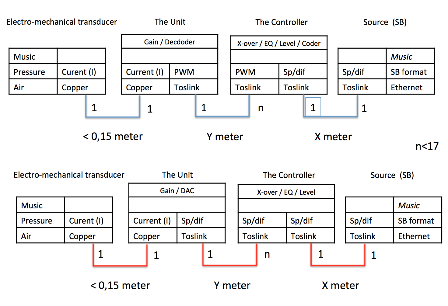

This thread aim to challenge the usual way of function allocation into boxes and their typical physical position wrt. different interfaces.

Meanwhile I'll add the below drawing... (SB: e.g. Squeezebox)

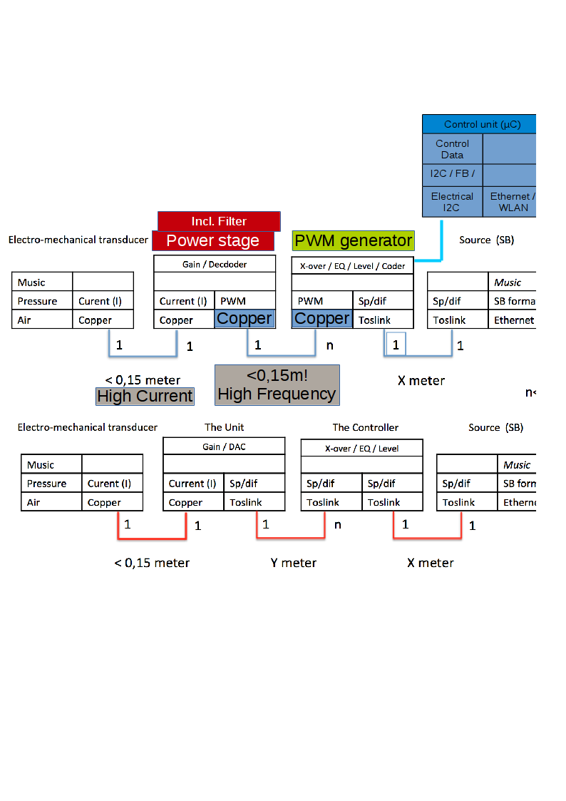

I think I got where our mismatch was, see the modifications to your pic.

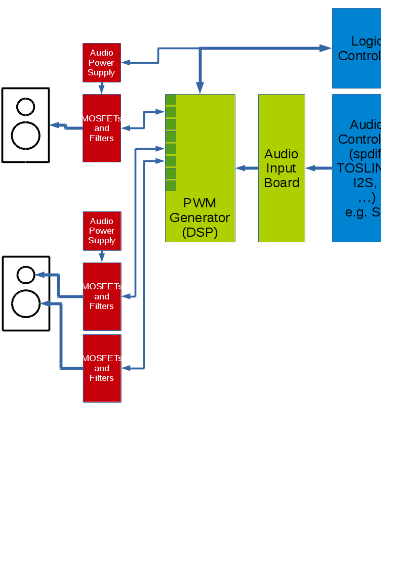

The pwm generator needs additional control input through I2C. This input controls the general items like how to generate the pwm, what filter settings, volume, ...
As we consider pwm as analog the wiring should be short, very short! Optical transfer may be possible but will be very delicate - Implementing this is ambigous and hardware usually used for TOSLINK may not be sufficient (but maybe a interesting approach to try!).
Audio Input to the pwm generator usually is I2S which can be generated from any type of source with a small electronic (DAC (e.g. TI), spdif/toslink --> i2s converter (e.g. Wolfssohn), ...).
Eventually the controller and the SB (which I like a lot) may go into the same device. Many "high-end" people do not like TOSLINK (and SPIF) due to timing - we used I2S for this which worked out excellent - with many more components.
OK 🙂 You talk protocol stacks - nice!
You prefer an other split where I wanted just one single autonomous PCM-to-power unit.
Are you seeking some pooling effect on PWM generation or what is the reason?
Yes, I didn't tdraw the control plane, only the "music plane".
Your analog path will be longer than what I sketched as the analog path also includes the speaker wire.

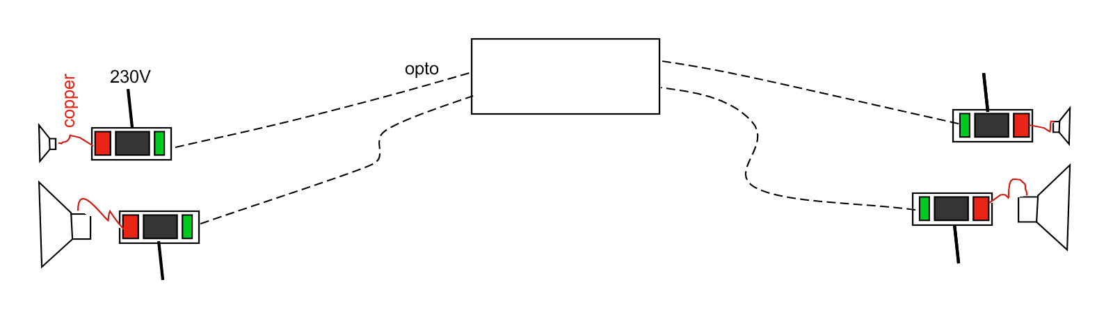

I don't see the pwm being longer - that's exactly why we set it up that way. The wiring from the audio power supply to loudspeaker (+-50VDC give approx. 300W audio power) is interrupted by the Mosfets to switch on/off. This is the same for every digital power stage.
The control line(s) for the Mosfets (which end up at the gate(s)) are pwm, and its favourable if they switch very high frequency and do this very accurat. Therefore these (low power) wires need to be short. We put the pwm generator (green box) close to the power stage exactly for this reason.
The other architecture option would be to send the pwm to the power stage over wires from the remotely placed controller and pwm generator. This requires to have the delicate high frequency mosfet control lines with long wiring (optical would be a excellent choice if timing accuracy and temperature dependency issues can be overcome). There are a few other control lines (like power on/off, reset, overtemperature control, ...) which are easier to handle. The smart idea here is that the power stage has fewer components and gets smaller.
So this leaves us with the two options:
a) power stage close to pwm generator
(+ short pwm wiring, - one pwm generator close to power stage(s), but up to 8 in one box)
b) power stage distant to pwm generator (+ fewer components at the power stage, - high frequency and timing accurate wires are long, + only one pwm generator per system).
I like the idea of to use a optical pwm interface but I'm not sure it can be done that easiy (I guess we should have << 1nsec control, which would require > GHz bit rate...
If somebody has a solution for this I'd like it.

The timing issues in the pwm generation is interesting. I don't see anything about the sawtooth accuracy generation and pwn coding and if oscillator jitter is important? Is pwm immune of jitter? Would not think so.
So why don't we just move the whole class D stage into the "Unit"? That would be my red version in post #3.
But agree, mowing the pwm signal over opto would save space and make the position of the box containing the pwm generation very flexible.
One can apparently do 140m 100G over OM4 - https://en.wikipedia.org/wiki/Multi-mode_optical_fiber
The OM4 fiber is cheap but how about receiver and transceivers? I suppose a brutal layer 1/1,5 is to be used and not ethernet etc higher level coding...

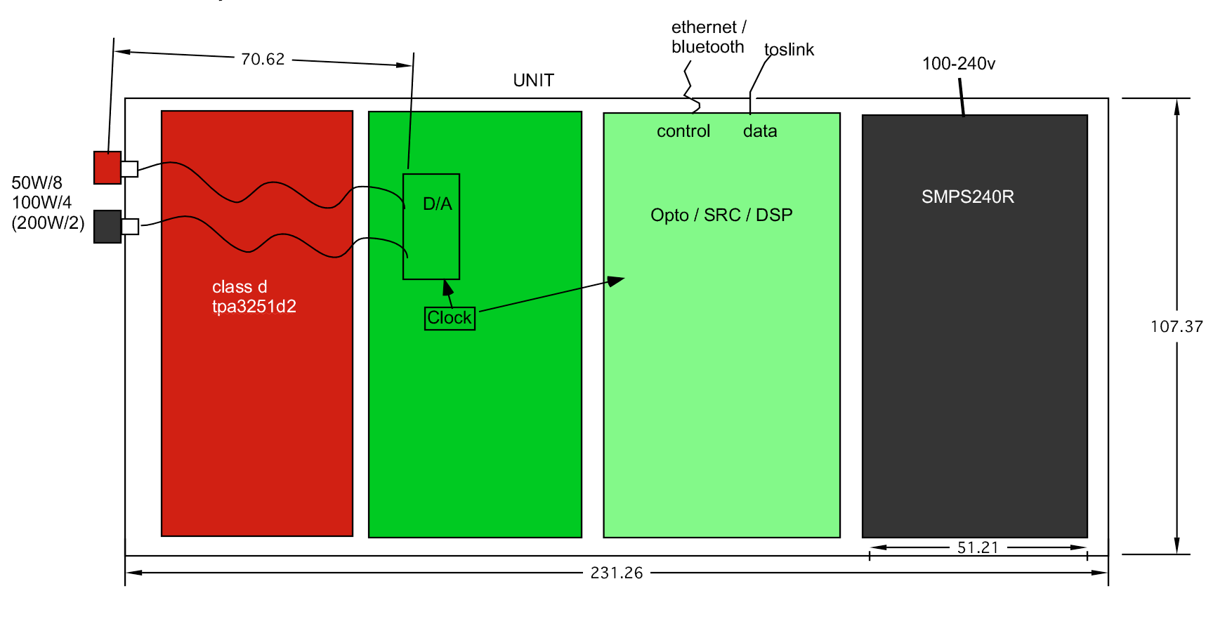

Still you have not made it clear to me why you don't seem to find a one box / one channel solution interesting. Why is this? Or maybe you did 🙂
"And so we are back to the original setup with the pwm generator close to the power stage. I still separate these into two building blocks, as the requirements for the pcb, wiring and signal quality are totally different for these two. We can still have them side by side which then gives the flexibility I proposed in the early posts and which avoids the issues discussed above."
Reading it again I realized you did so You are OK with 2 boards inside one and the same box - right?

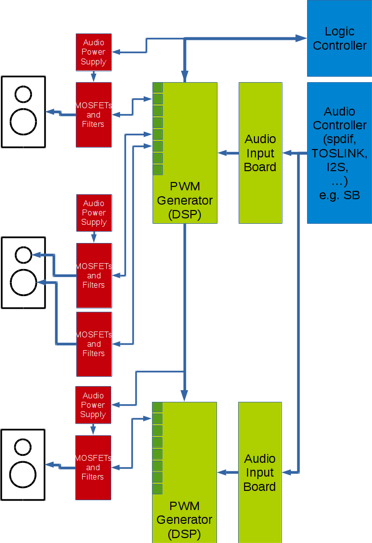

I'll prepare a pic of the functional blocks and post it here later today.

Attached a rough block diagram.
The two green and the red are close to the loudspeaker, logic controller to be decided from system standpoint.

I suggest for a family of DIY boards to forsee galvanic isolation for the I2S input to the pwm board and for the I2C signals from logic control. This allows to separate audio relevant electronic and also to minimize damages. To be decided which isolators to use and where exactly to put (input of pwm board or input of audio input board). Disadvantage may be the extra power supply for the logic...
Sound quality and power depends mostly on the red box's design.

Looking at the supplied picture I deduct that if the speakers are 3 meters apart, the smallest length of analog signal path is really 3 meter. So you need 3 meter of 1000USD/meter cable to make it sound good? 🙂
But I want to have only 10cm analog path length
Would you say that typically a 2 component (PWM mod + H bridge) is better than an integrated solution like tpa3251d2 etc?
TNT,
you have quite detailed requirements regaring the size of the unit 🙂...
The 3 m is not true as you can set up the device with one pwm modulator per channel as well (You don't need to have only one in the system!). As the timing from digital input signal to pwm output is determinisitc (no buffering as in the audio controller) is performed - and in this case you simple have to "copy" the digital signal - which can be done without loss (see attached).
I didn't check for the physical size of the boards but other than that your minimal analog signal path length would be met with my concept.
OK , I'm with you!
Can you package that into some physical boxes please 🙂
My drawing program apperently likes decimals 😉
Looking at my Unit drawing the ethernet + toslink docent make sense really..... ethernet cables are awkward in numbers.. on theater hand toslink can't carry control info. Maybe to put all DSP and level control in the central unit and let the Unit have fixed gain.
... missed to mention that the tpa325 requires analog in - with all the losses inherent to analog and with the extreme long analog path you get from your audio controller...
to be honest - I never compared a well designed analog-digital converter chain to a full digital chain with similar quality (design, components, manufacturing) so I cannot tell you. I listened to quite a few (different) analog A and AB amplifiers and I listened to well done pure digital amplifiers. A comparison with the same room, loudspeakers and audio material and with my own and known music material is something I would really like to do - but what I cannot afford to do (costwise and timewise!), not to mention the risk that I may end up spending lots of €€€€...
