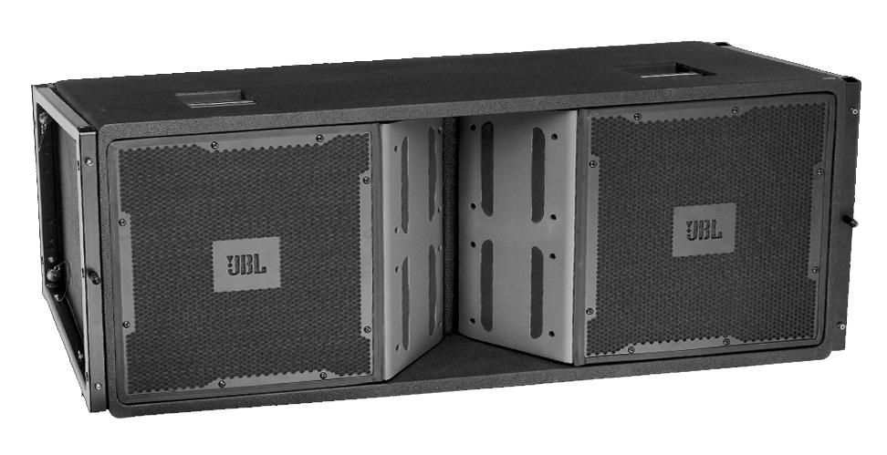

Yes but those lay horizontally. I am looking to use this vertically as drawn. and not as an array element.
Line array elements have a very narrow vertical pattern but wide horizontally. typically 10-15 degrees Vert.
I am looking for something not so narrow, or wide. 60x40 maybe, not not less then 40x20

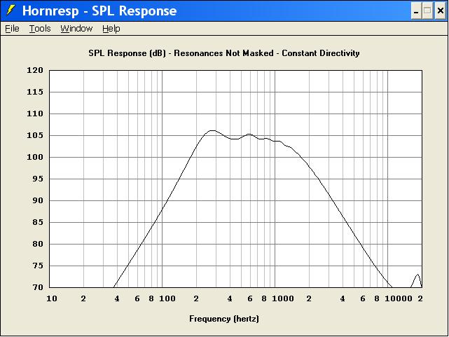

Here's another option for the mids, using the 18Sound 6NMB420. I thought the enlosure was large enough to allow a horn loaded mid running ~300Hz up to 2-3KHz.
McBean says we get this response from loading a single 6NMB420 in a 35cm long conical horn, 36cm2 throat, 1000cm2 mouth.
Typically you see more HF extension than McBean predicts. Bill Fitzmaurice has some nice info on his site regarding this
-Len.

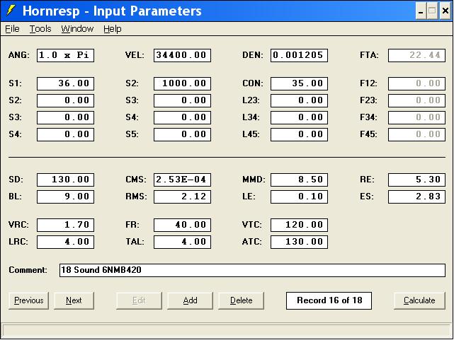

And the input parameters
I used a rear volume of 1.7 litres (I look to reduce the electrical impedance peak by playing around with this volume) - as far as I'm aware this is nulling out the reactive component of the driver. I'm sure more knowledgable readers will correct me on this 🙂
Front volume is 120cm3 to flatten the passband response at the expense of a little HF extension. Looks good to 2K+, should be better in real life.
-Len.
