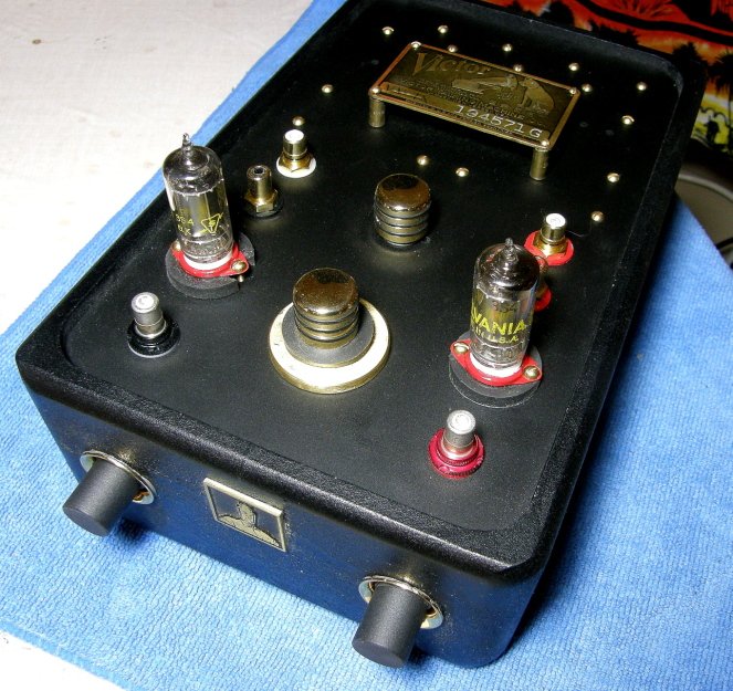

I have a limited amount of experience with these products and yet, what I chose to do was 'upgrade' their components and such after having found an uncanny amount of performance with their least expensive kit, the 'Quickie' which is no longer sold. Just a little DHT preamp with a CCS that makes you wonder just how the hell it performs so well. Part of that secret is the simplicity. I went my own way with it (parts and chassis). I can't find the photo that I wanted to share, but this is the basic idea. 6S3 tubes are used in this unit. The Crack is a different story.
I built one a few years ago. Got all the upgrades. Did the "non-Bottlehead" mods - extra RC stage in the power filtering. Bypassing the output caps with some 5uF pp caps. I did not go for the coke-bottle size output pp caps. The sound to me was still dark with my HD 650s and not much different with my HD 600s.
My end tube selection was a GE 7316 UK and a Russian 54 variant output tube. Lots of tube rolling.
While I didn't build a quickie, those 6S3 tubes are painful to use - I have a preamp with them and they ring even with dampers. A lot of the tubes are flaky out of the box.
