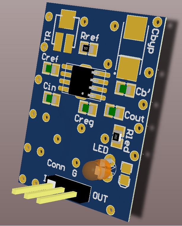

I'm planning to make some PCBs to test them with my circuits, using the reference design from the datasheet with a couple minor additions (extra cap, resistor+led for indication). And I was wondering if anybody else is interested in it?
As you already know the more we make, less the cost.
Plus, it comes in SOIC package which is diy-friendly.

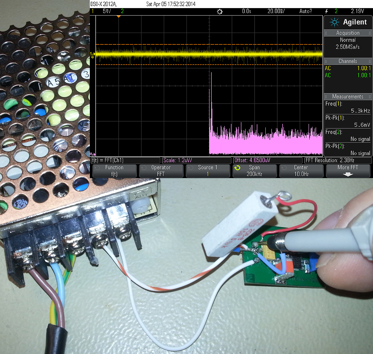

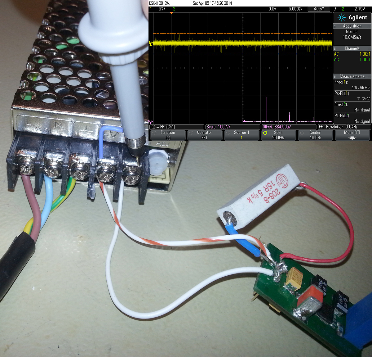

Yes with SMPS. I want to try three different of those that I have and see the results. One is a standard 5v smps for charging my phone, and the other two are 9 and 6v marked as "audio grade".
The plan is to power a buffalo dac and raspberry pi. When Russ White's cap is ready I'm going to switch to that.
I'm going to send today the gerbers for manufacture, I will have them back in about 2 weeks.

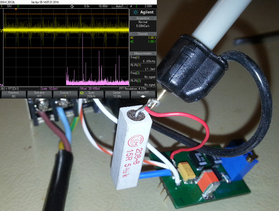

There is a very bead idea to use this chip to regulate the output of a SMPS...
Move the scope gnd lead to the bottom of the load resistor and compare with what you have in picture.
Let's see first if there is enough interest to make it a gb.
I am interested.
Satisfied?
Yes, thank you.
Interesting results. (post 15)
SMPS @ 100uV/div and regulator @ 1.2uV/div.
Cool.

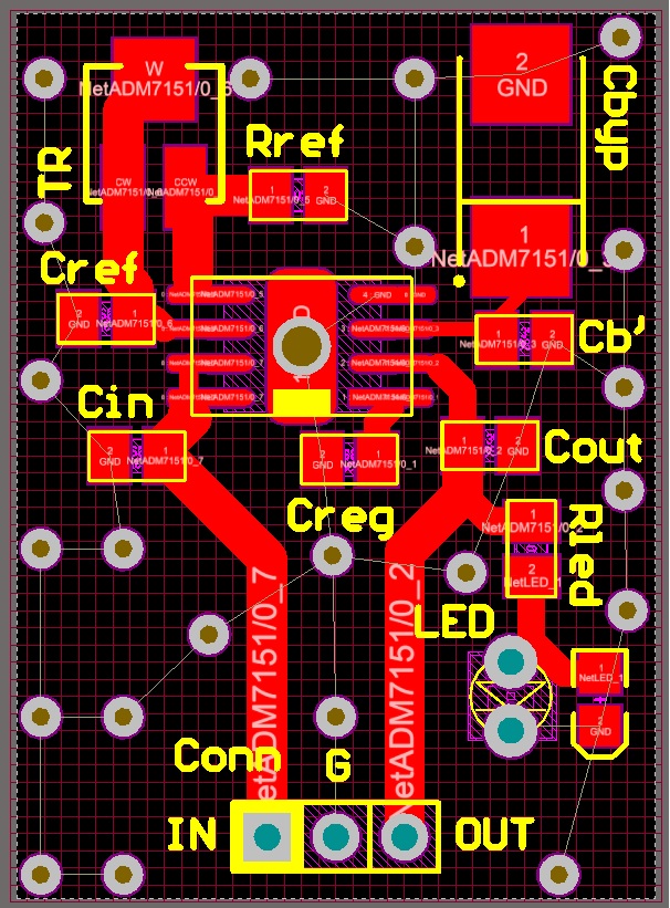

Is there a schematic of your board or is it one from the data sheet?
Why use such a high-tech (and high price) regulator and then destroy its performance by using a 3-pin connection ?
What would you suggest? The advantage of the 3pin connector is that in some cases you can plug it directly on the target board and in most cases you can place the reg *very* close to whatever you might want to power.
