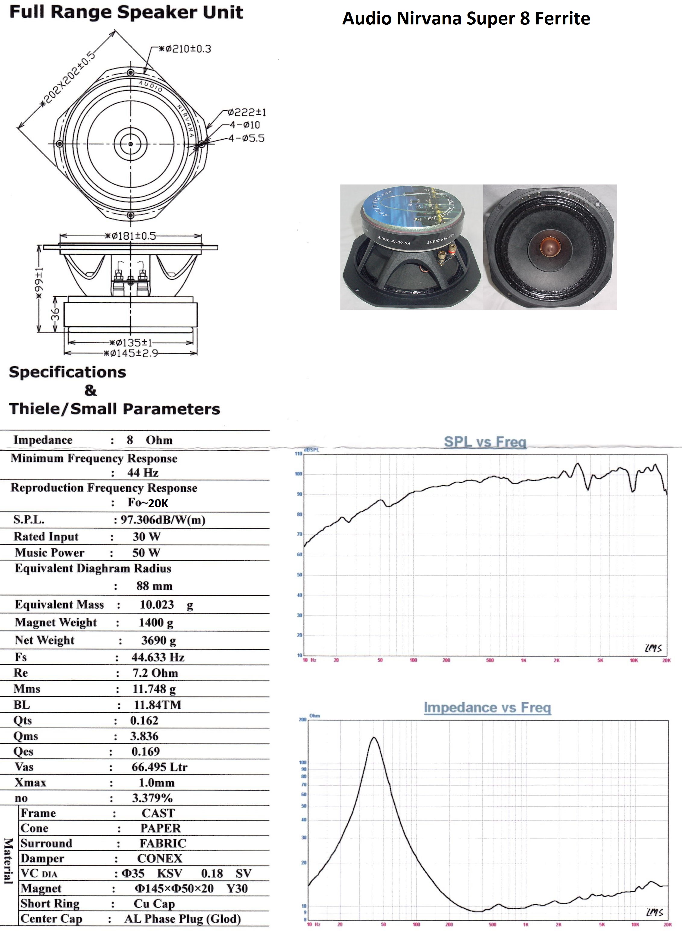

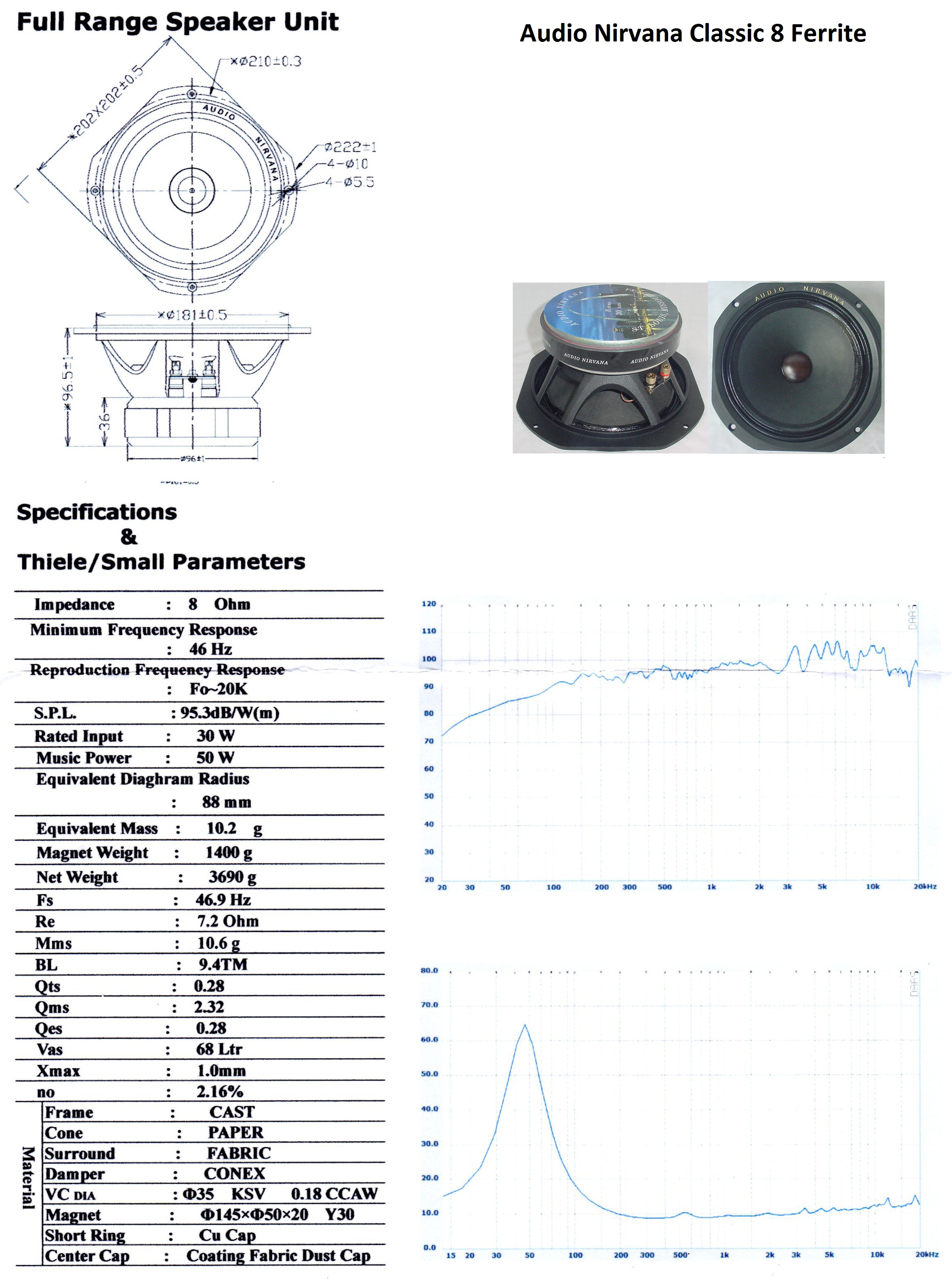

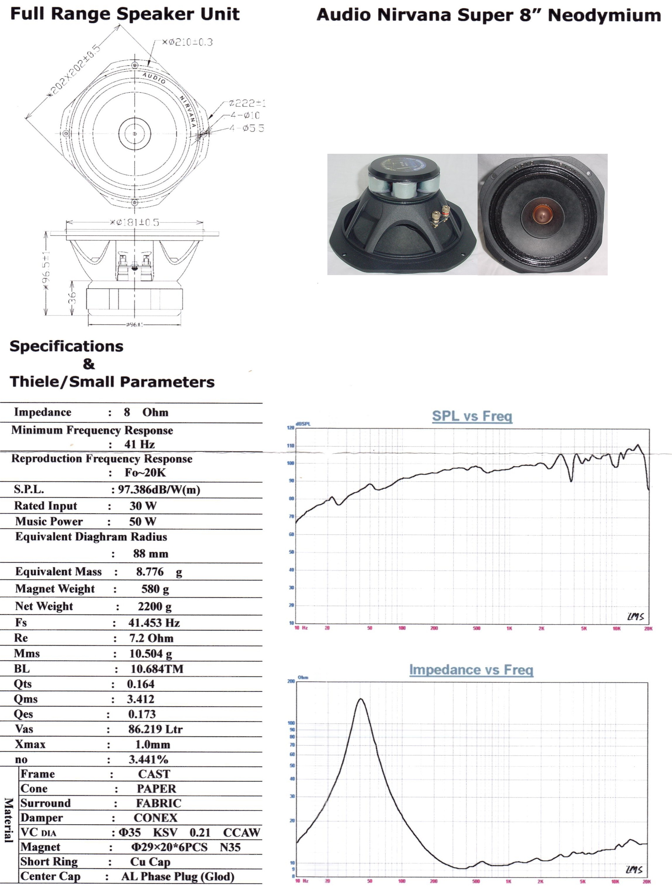

I am no expert in driver design, but having an interest in FR drivers I've ofcourse looked at the AN drivers over the years, they seem to be have many similar materials and build between the different magnet versions (Ferrite, Neo, Alnico).
The only driver left with Neo And Ferrite options are the Classic 8 and the Super 8, and of those, only the Classic 8 has different magnet strength:
http://www.commonsenseaudio.com/an8classicspecs.jpg
http://www.commonsenseaudio.com/an8classicneospecs.jpg
http://www.commonsenseaudio.com/an8cfspecs.jpg
http://www.commonsenseaudio.com/an8neospecs.jpg
If memory serves me correct (Not always!), I seem to remember the same trend of the bigger sized drivers, some reduction of peaks and variation in the lower frequencies, up top the variations are more profound with varying results, not always for the better, but all in all a quite different graph than the lower BL units. Ofcourse changing the magnet strength will influence the sound.

For those concerned about the mid-high range, have a quick look at the PDF for this driver: Speaker Detail | Eminence Speaker
It features Eminence's FDM (Flux Density Modulation) technology. I suspect all it does is move the ferrous polepiece in and out of the magnetic structure, but I could be wrong. The T/S parameters show quite a swing, with Qts going from 1.29 to 6.02. However, the mid-high range looks like it's attenuated pretty linearly.
I'm not going to claim simply adding more magnet will have the same effect - Eminence might've worked really hard on a way of reducing flux density in a way that maintains the frequency response.
It does seem possible, though, that the mid-high range will simply gain a few dB in sensitivity with minimal changes to the response.
