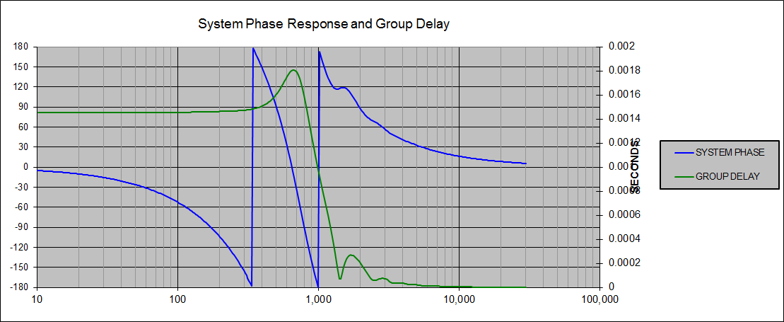

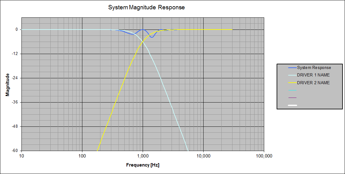

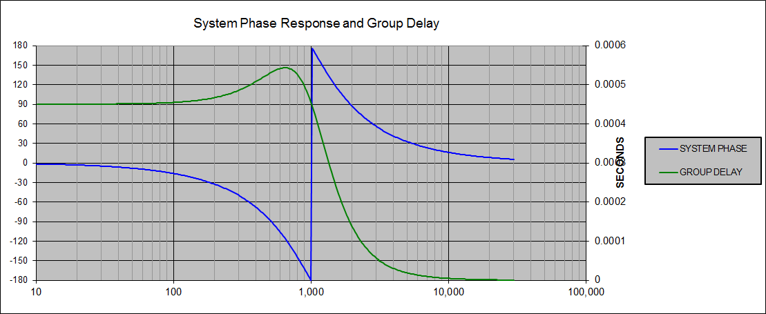

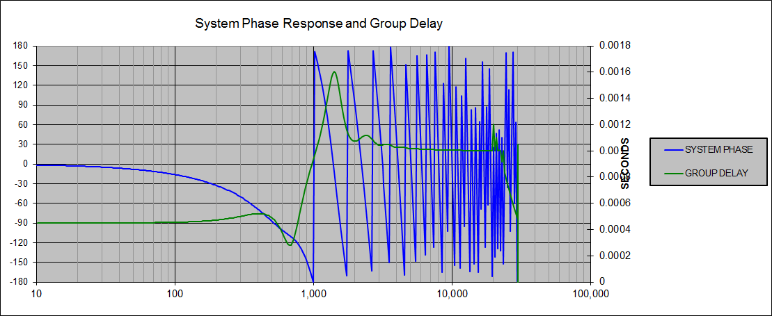

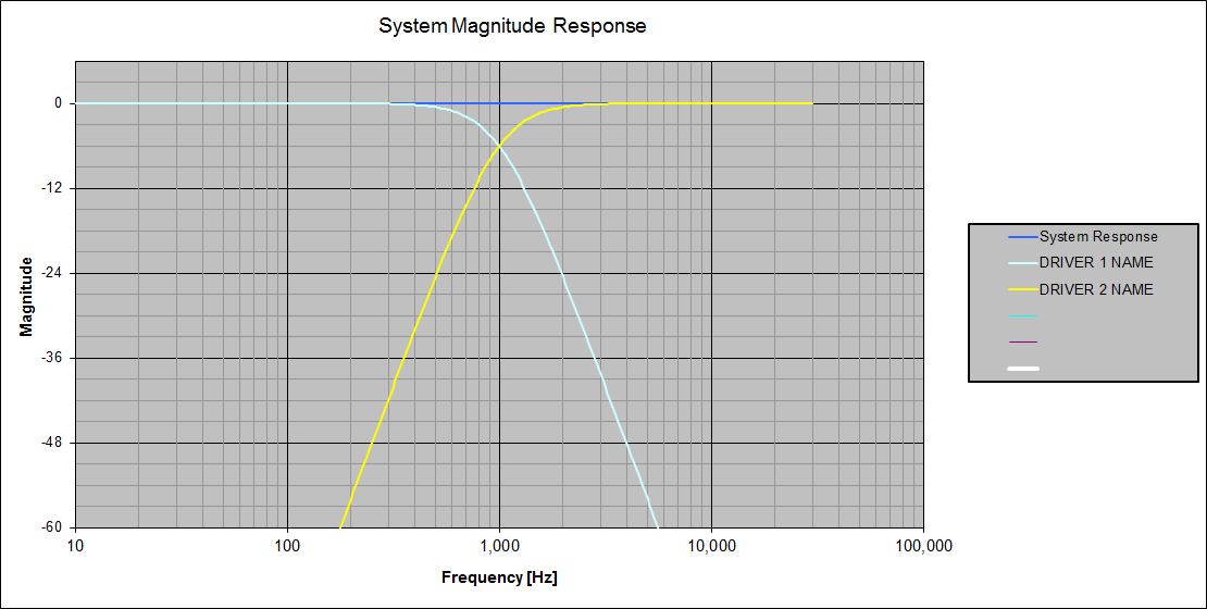

I modeled your hypothetical system using ACD:
- two drivers with "perfect and flat" frequency and phase response
- coaxial placement of acoustic centers
- on axis
- LR4 @ 1000Hz (one driver high passed and one driver low passed)
- system response is the sum of the two drivers
- no delay for either driver
- the low passed driver delayed by 1 wavelength @1kHz = 1 msec = 34.4 cm
- the high passed driver delayed by 1 wavelength @1kHz = 1 msec = 34.4 cm
The frequency responses are the same for each case of delay, however, the group delay is different by 0.001 seconds, just as you would expect. The group delay scale is to the right. Sorry if it is partially obscured by the axis label.
Also, keep in mind that there is group delay for the system even for this ideal case and no delay for either driver. This is a result of the LR4 electrical filters, which have their own group delay behavior.
Awesome Charlie, thanks! I'm most interested in the delayed HP driver, since that is the real world scenario that caused me to ask this. So the character of the group delay is similar, but higher. Too high?

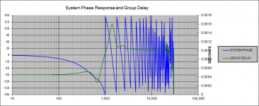

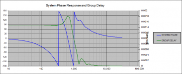

Oops, I just noticed that I reversed the labels on the plots for group delay in my post (#5) above!
The plot labeled "group_delay_1ms_delay_HP_driver" SHOULD READ: "group delay with 1ms delay applied to the low-passed driver".
The plot labeled "group_delay_1ms_delay_LP_driver" SHOULD READ: "group delay with 1ms delay applied to the high-passed driver".
You can tell which is which (without the labels) by looking for the plot that has lots of wrapped phase at higher frequencies. This is evidence of a large delay applied above 1kHz, e.g. to the driver that is reproducing the "high frequencies" e.g. is high-passed.
