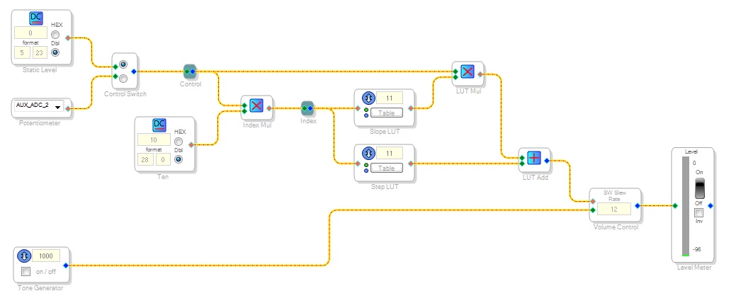

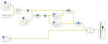

Thanks for all the great feedback. Seems there is some interest in part 7. I have found SigmaStudio easy to get used to but I work with software development so maybe I take a lot of things for granted? I have therefor put together a couple of files for the ones not used to setup spread sheets or have a hard time figuring out what block to use in SigmaStudio.
The attached TaperedVolumeControl.zip contains a couple of files:
TaperedVolumeControl.dspproj, a SigmaStudio project file showcasing the "Linear Interpolator" substitution with LUT tables pre-populated the way I use them (se attached screenshot).
TaperedVolumeControl.numbers, I am a Mac user and this is a Numbers spread sheet used to generate the values for the Slope LUT and Step LUT based on wanted dB values for 11 volume control positions (0% to 100%).
TaperedVolumeControl.xlsx, the Numbers spread sheet exported in Microsoft Exchange format (I hope it can be of use for the ones without Numbers).
