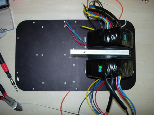

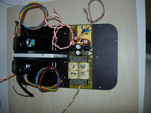

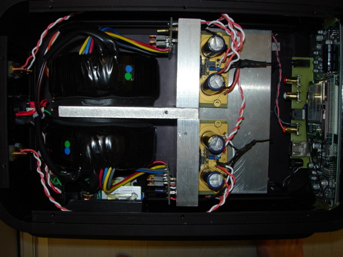

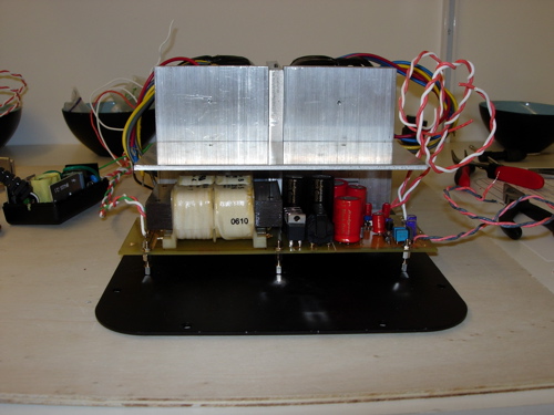

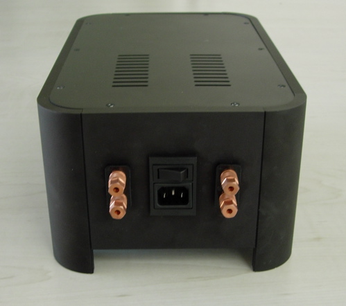

Fast Eddy,
1. The device is completely wireless controled either from a remote or my Mac. My entire music collection is housed on the Mac (with appropriate backups of course). All music was encoded as either Flac or apple lossless
2. There is absolutley no difference in sound qulaity between ethernet and wireless. I do run the wireless in "g" which permits up to 56Mbs transfer rate, more than enough for audio data. I have yet to have a dropped connection.
3. The SB3 i feel, falls quite short in regards to its analog outs. Bolder cables offers a Mod to improve the analog outs but i personally feel you are better off choosing your own DAC and using the SPDIF out on the SB3. I have been extremely happy using an outboard DAC; first a modded Bel Canto and now Peter's NOSDAC. I would definitly encourage you to experiment in this arena. The sound really does improve. I think even upgrading the power supply on the SB3 would help the analog outs.
4.Next week i am off for some sun, but when i get back i should have some more time to update my website. I was also going to wait until i have completed the buffer section and given the caps a chance to burn in.
5. The case is aluminum, bead blasted and black anodized
6. I tapped the heat sink to bolt directly to the chassis. The top and bottom of the chassis are vented. I ran the amp for several hours at 90% and although warm, i imagine the chips were doing fine. The heatsink are 1" thick aluminum, i find it takes awhile for the LM3875 in a vented case to heat these up
