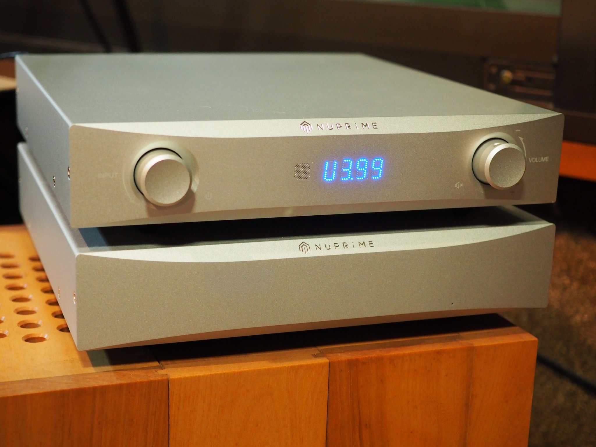

I used the MAOP10 with the following amps, and I think that amps under $1,000 are sufficient.
*TUBE AMP
Softone Model8(300B single, 8W)
Triode VP300BD(300B palla single KIT, 20W)
KT120 single(DIY, 18W)
*ANALOG AMP
DENON PMA390IV(50W)
MARANZ PM5004(40W)
SONY TA-F555ESL(100W)
*DIGITAL AMP
Nmode X-PM7(1bit digital, 14W)
Nmode X-PW1 mk2(1bit digital, 17W)
NuPrime IDA-8(A+D class, 100W)
NuPrime STA-9(A+D class, 120W)
others(chinese cheap D-class amp)
It want 20W output at tube amps and 100W at analog & digital amps.
The recommended amp is the NuPrime IDA-8.
The amplifier section has enough power and quality.
The DAC section also has high sound quality and exceeds TOPPING D90SE.
Dear vrbbra,
The tube amp can be used at full volume because it has low distortion at maximum volume, but the Softone Model 8 (8W + 8W) and MAOP10 (86.5dB / w.m) cannot output 100dB, so the volume will be insufficient.
Also, with a cheap analog & digital amplifier with 40W to 50W, the feeling of distortion at maximum volume is large and it cannot be used at full volume, so the power will also be insufficient.
