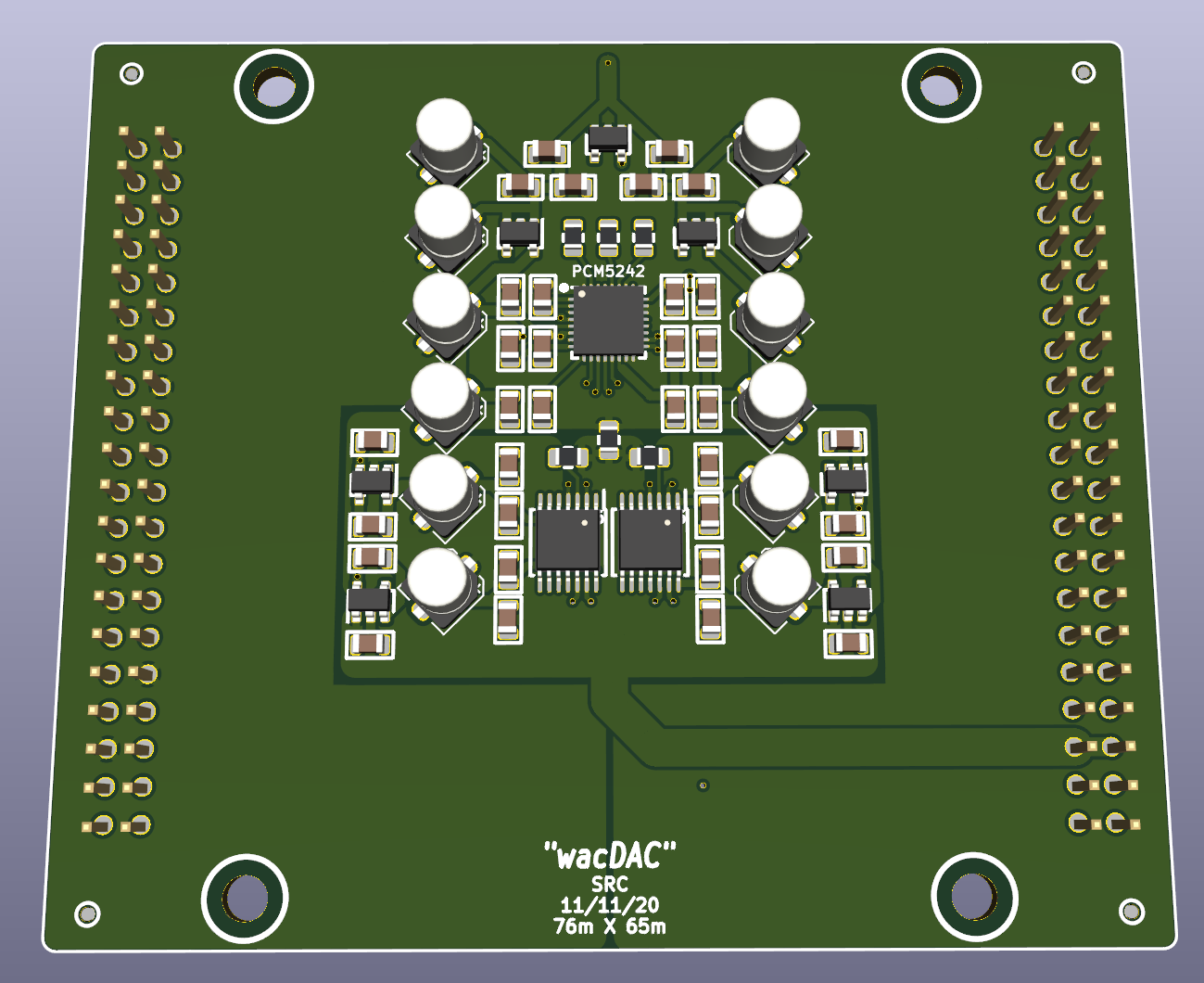

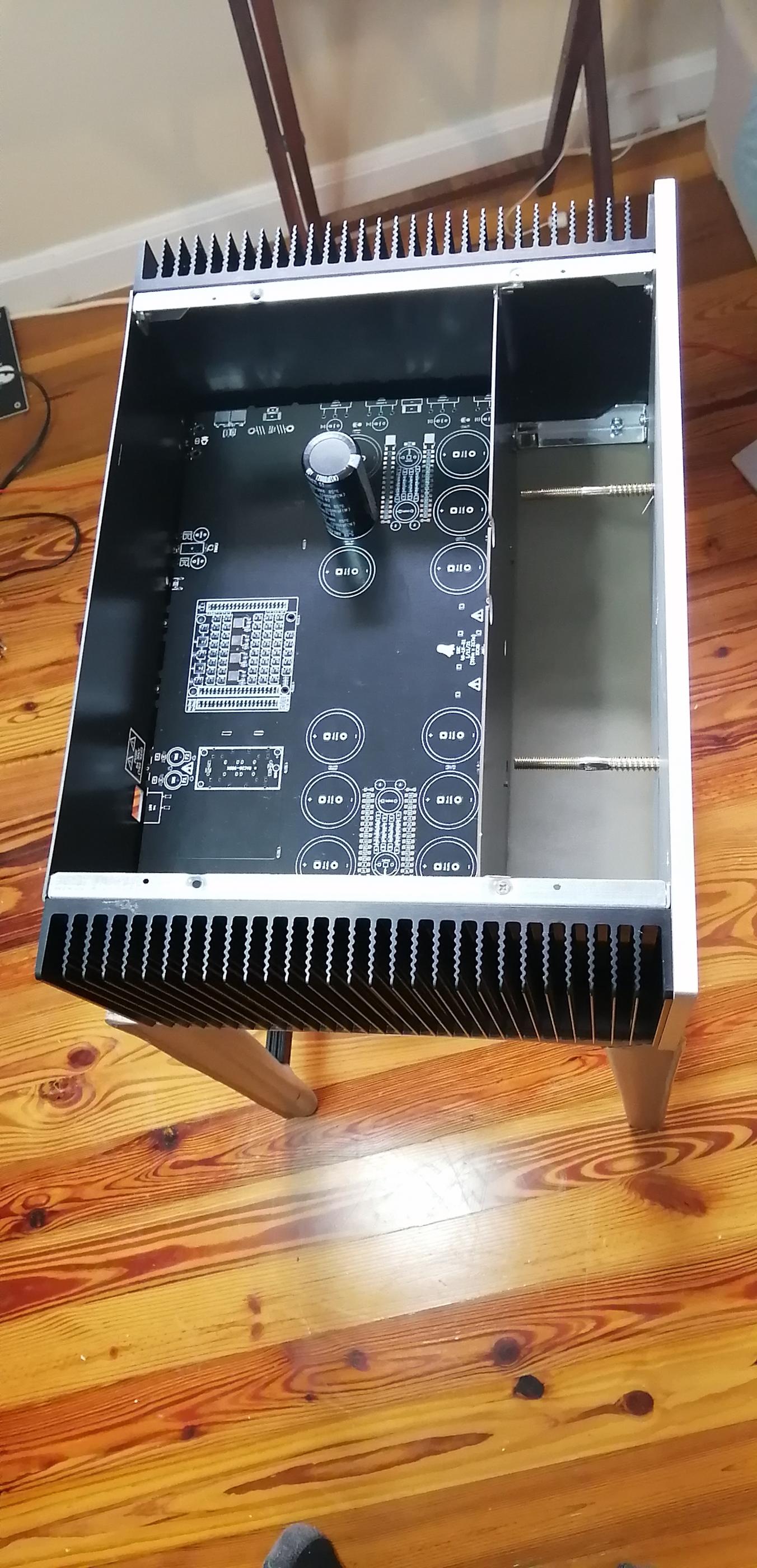

No power switch planned - there are only wires to and from the transformers, everything else is PCB
The amp is a lateral mosfet class b, has offset protection, soft-start.
This particular version is about 140w in 4R impedance and will have another ver soon.

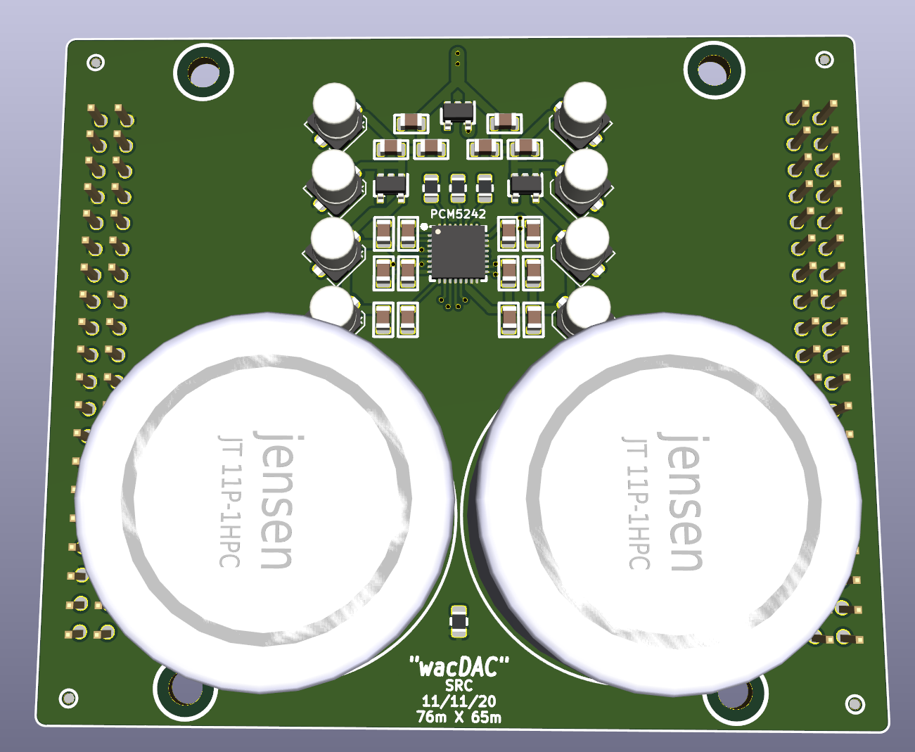

The signal chain has no capacitors in line. I use Jensen sig transformers at the DAC.
Had to design my own DAC in order to fit everything well.
New ver DAC coming soon too with line receivers option.
This ver design will work with a FIFO option as well
Next unit ver in a year or so may be quite exceptional if I decide to continue

Custom - built around the PCM5242
My requirements are hardware volume control (since my unit has no knob) and balanced drive (since the opening and closing of the Pi sound system produces nuances).
My amplifier has no attenuation at it's input and is incredibly silent, dare I say impeccably silent. There are no capacitors in the signal chain with only the signal transformers between the DAC and amplifier. It is amazing.
Each is in their pursuit of their own ideas - mine is simplicity

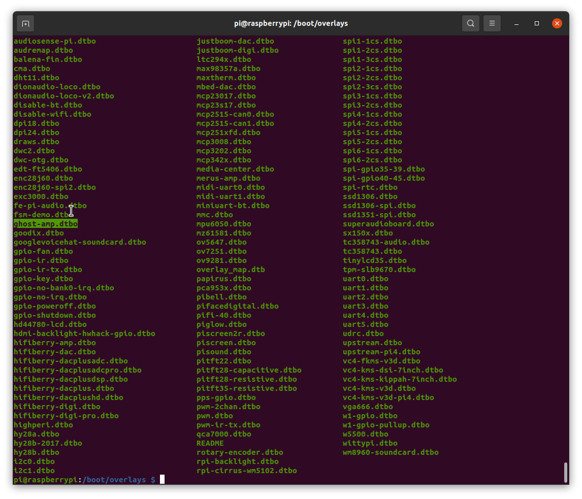

I have about 2k worth of new parts just mailed to me ready to apply to the next beta of PCB sitting in another box. About a years worth of fine tuning. This DAC ver will test line recievers in place of the signal transformers. One of the RPi engineers developed a new feature based on my idea and in the same motion provided me with my very own overlay-driver that just got included in the latest RPi release! In the last year other unrelated but welcome improvements have occurred with other projects in the software realms that I have now included and am testing with great positive results. One has been the spotify connect functionality. Last year it was not so good with issues with gapless playback not working, while now I take another look to see that it's working like a pro now. Many many many things considered here that have sharpened the machine, i.e space for the FIFO and much more. I'll give a shot and video in a few weeks most likely about it with the new version.
