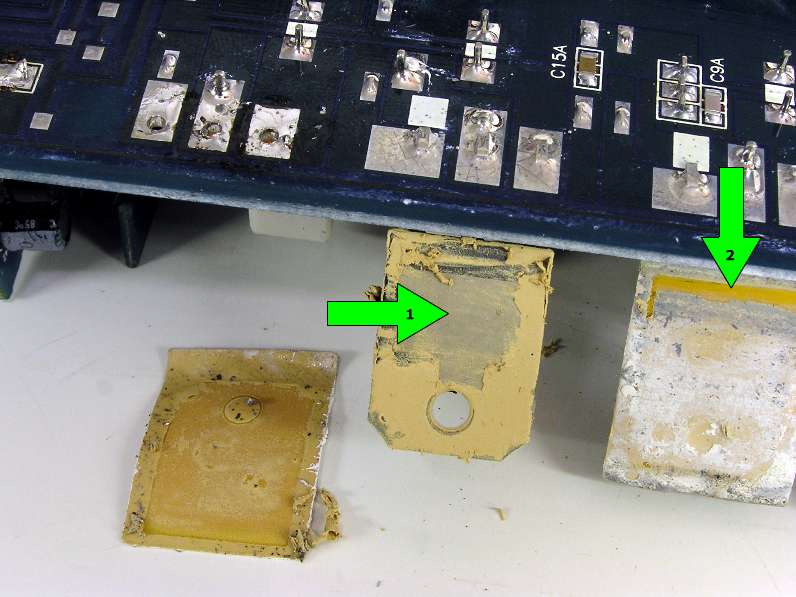

Is this a soft silicone coating on a Kapton core (seen in TT5, #8) or is it fiberglass reinforced silicone rubber?

That's good material but not the same. When used, it looks like the first image. The coating doesn't remain on the Kapton core. It's a pain to use if the transistors are not going to be replaced and especially where the insulator will be used in a location that's hard to clean up (3rd image, rare).

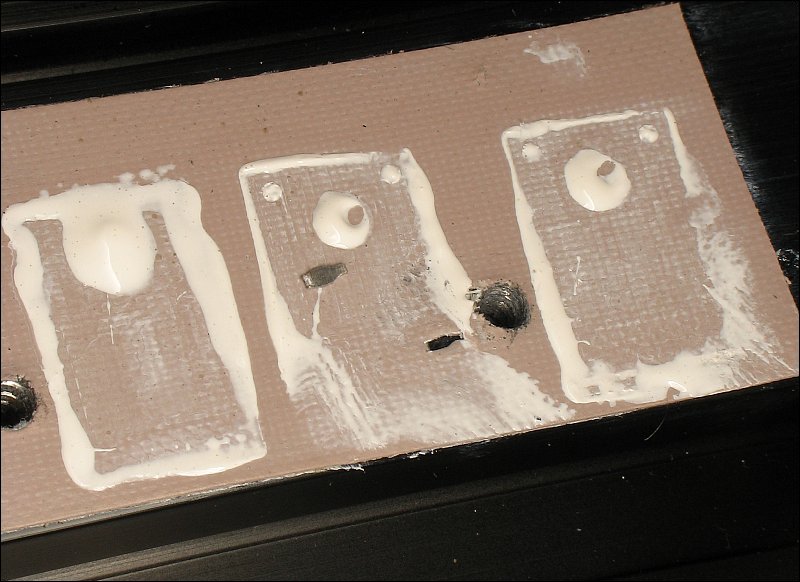

The second image shows the fiberglass reinforced material. You can see the weave's shape in the surface of the insulator.
