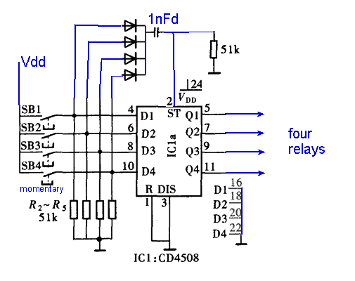

I have a feeling this won't work. Idea is that a 4-bit Latch (ganged flip-flops) senses four momentary switches. A common Latch pulse loads the latch ("ST" store).
It latches the states of all 4 buttons. Intent is you only foot one button, the others default low. If you fat-foot 2 buttons, both are latched. This may be a Feature or a Flaw, your choice. (This could be prevented mechanically with tall ridges between switches.)
I have a feeling it will fail due to switch bounce.
I post to excite thoughts from members with more experience in small logic systems.
You'd need a few capacitors + FET to delay and clean the clock. Not what it says on the app note but it'd probably work well enough.I have a feeling it will fail due to switch bounce.

You can use four of MAX16054 switching IC to do this function. Use 4 momentary push buttons for each of the ICs input. Wire 3 diodes from each switch output to 'clear' of other three ICs.
Switch bounce is taken care of the IC.
Each IC has high and low outputs at 5 volts logic level which you can use to drive a FET switch or relay as necessary
